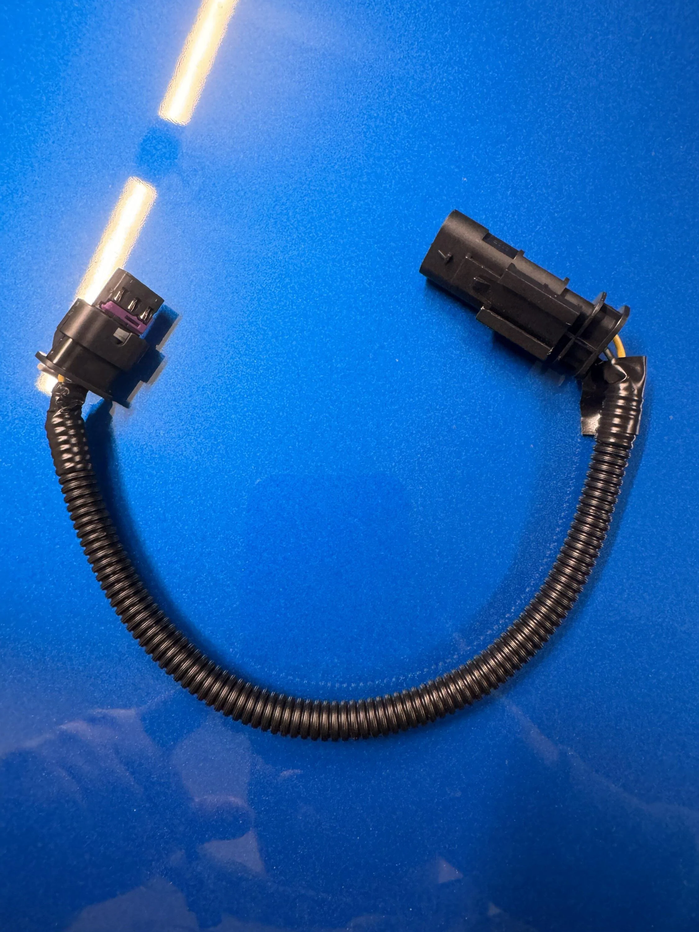

947000011 - FORD 2021 BRONCO PROX SENSOR EXTENSION (Each) $24.95x2
When you ordered this part number did you get all in the picture of just the harness?

I did order all but only really needed to order two of the harnesses.

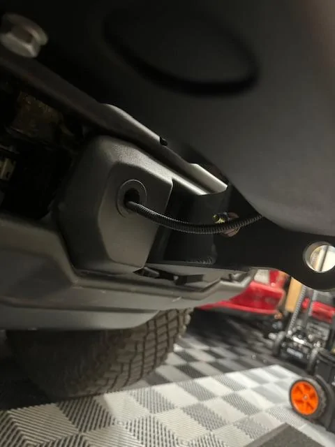

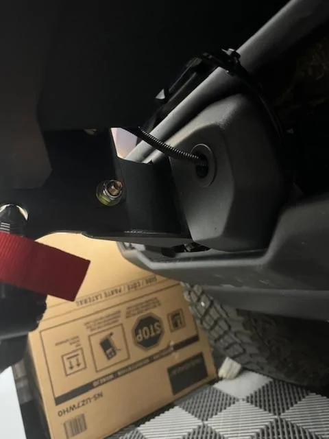

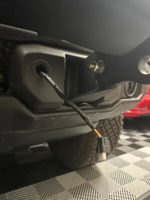

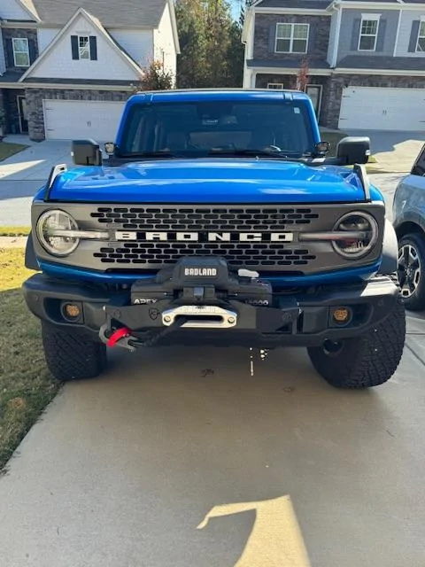

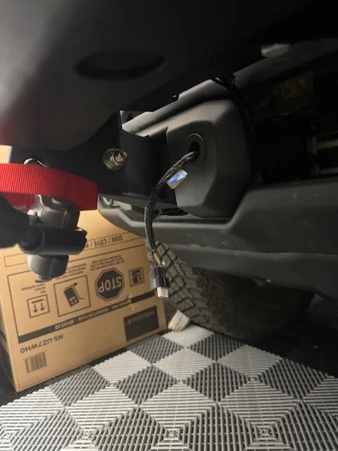

Wanted to revive this thread to say thank you @Rat ! Put the JCR Winch plate on my capable bumper and didn’t want to cut into the harness loom. Rough Country was able to send the two sensor extension cables and was able to give more slack to the wires.
Rough Country wasn’t able to find parking sensor extension cables for the Bronco when I called so having this part number helped in case another user needs to order. Part number 947000011 - FORD 2021 BRONCO PROX SENSOR EXTENSION, the price did drop to only $18.75 per cable so I needed two. They aren’t posted on the website so you need to call them directly to order outside of the full kit.

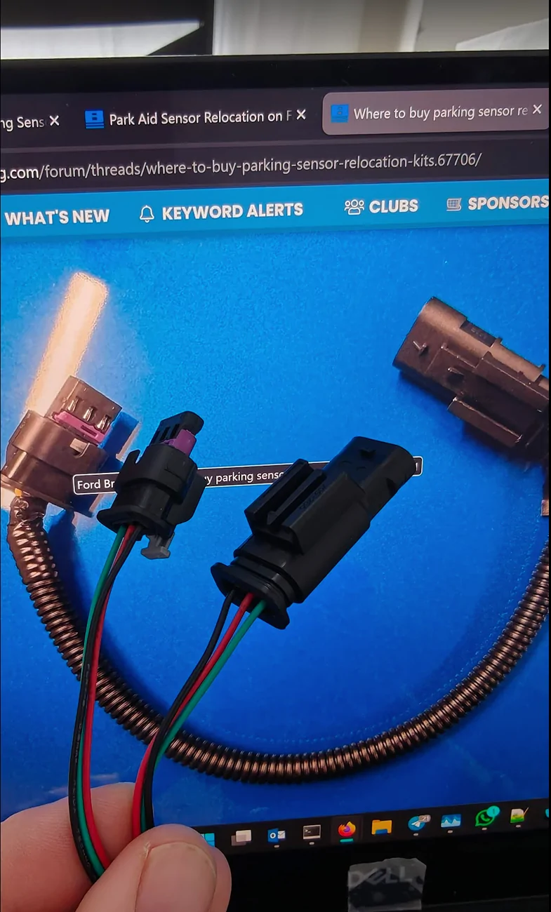

Since RC has some tough time to ship international and credit card over the phone works only for the US cards it seems, for anyone outside the US I'd like to share this. Sourced 2 pairs connectors with wires for about $2 each shipped from Aliexpress. They fit perfectly.
Easy soldering plus I added cable wrap.
