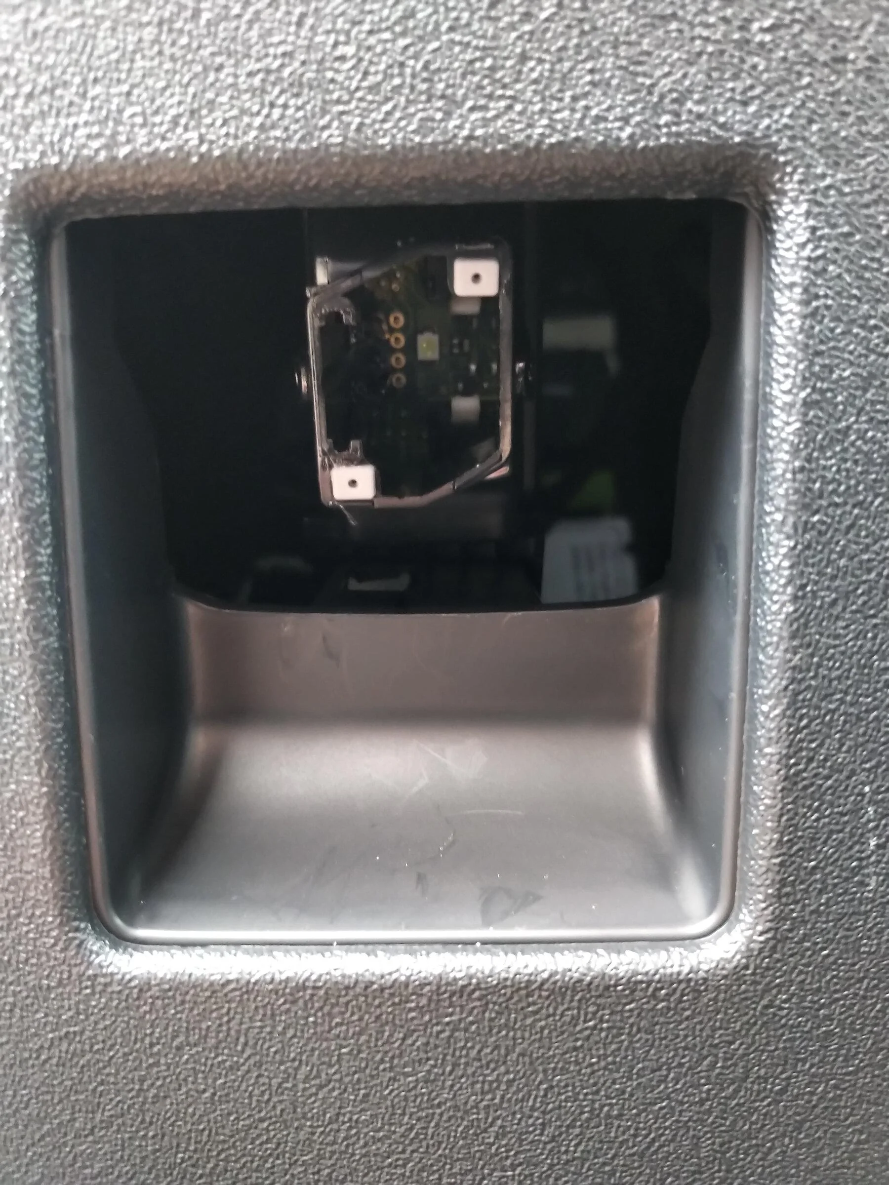

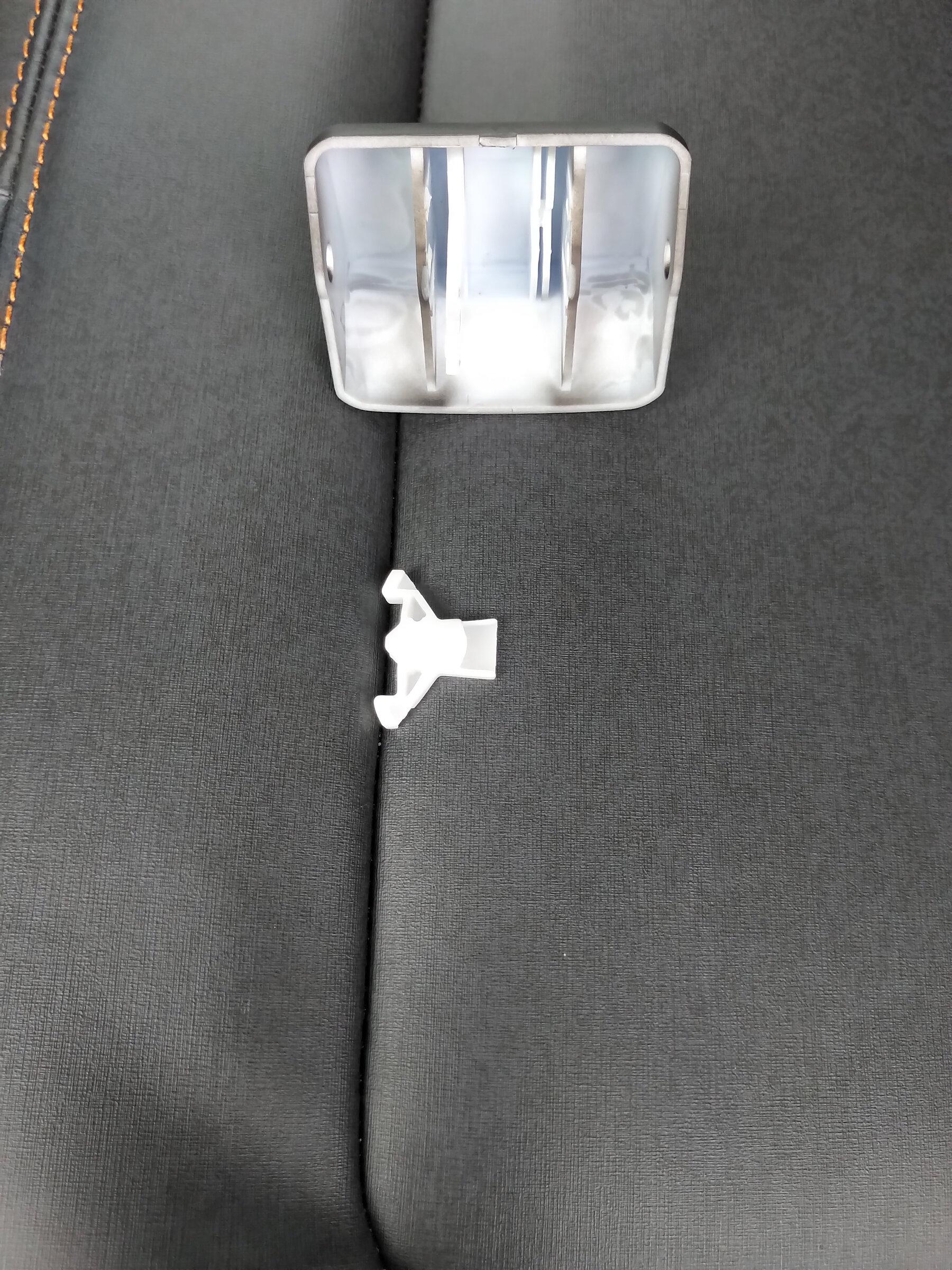

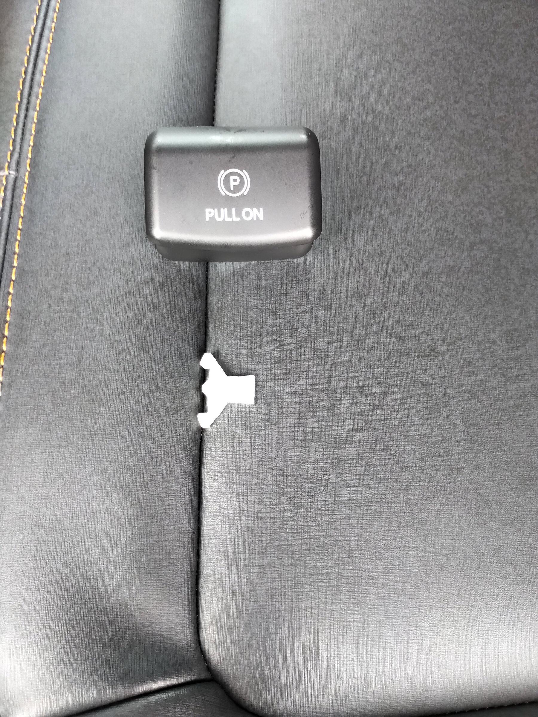

Mine was broken before I took ownership. There is the lever, and a small white plastic piece that slides in a channel on the left side of the module. You may be able to move the white plastic piece to toggle the e-brake off.
On mine, it never was "stuck" on or engaged.
The lever was completely off and the white plastic piece was still in the module, but not in the channel. I gently moved the white plastic piece around at different angles until it fell out.
Here are some pics:

That's interesting, mine isn't torn out like this, but I do hear a piece of plastic rattling around. Funny that's all there is to it and mine is so messed up.
