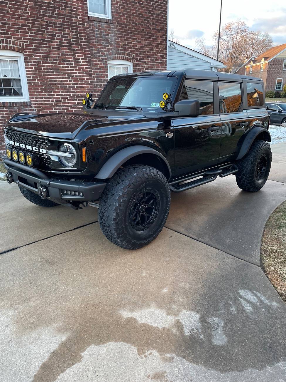

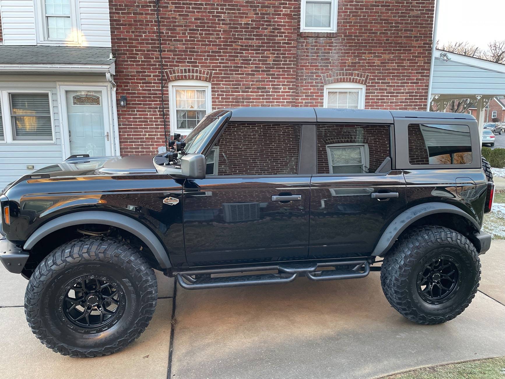

2023
I want to put 37's with 18's on my 2024 Wildtrak Sasquatch with Hoss Fox 3.0 suspension package. What do I need to do and still keep the Hoss Fox 3.0? Build pictures would be great! Thanks for all the input.
Close but not 18”
37x12.5 17 BFG MT
17” VR601BL Vorstein wheels
1/2 Body lift
Zone 2 in lift
Max tire clearance kit
Ford Bronco Help Needed For 37's IMG_4432
Ford Bronco Help Needed For 37's IMG_4433
BadlandsGrizzly
Aug 15, 2024
@lewy Beautiful rig! I’m interested in those ditch lights!

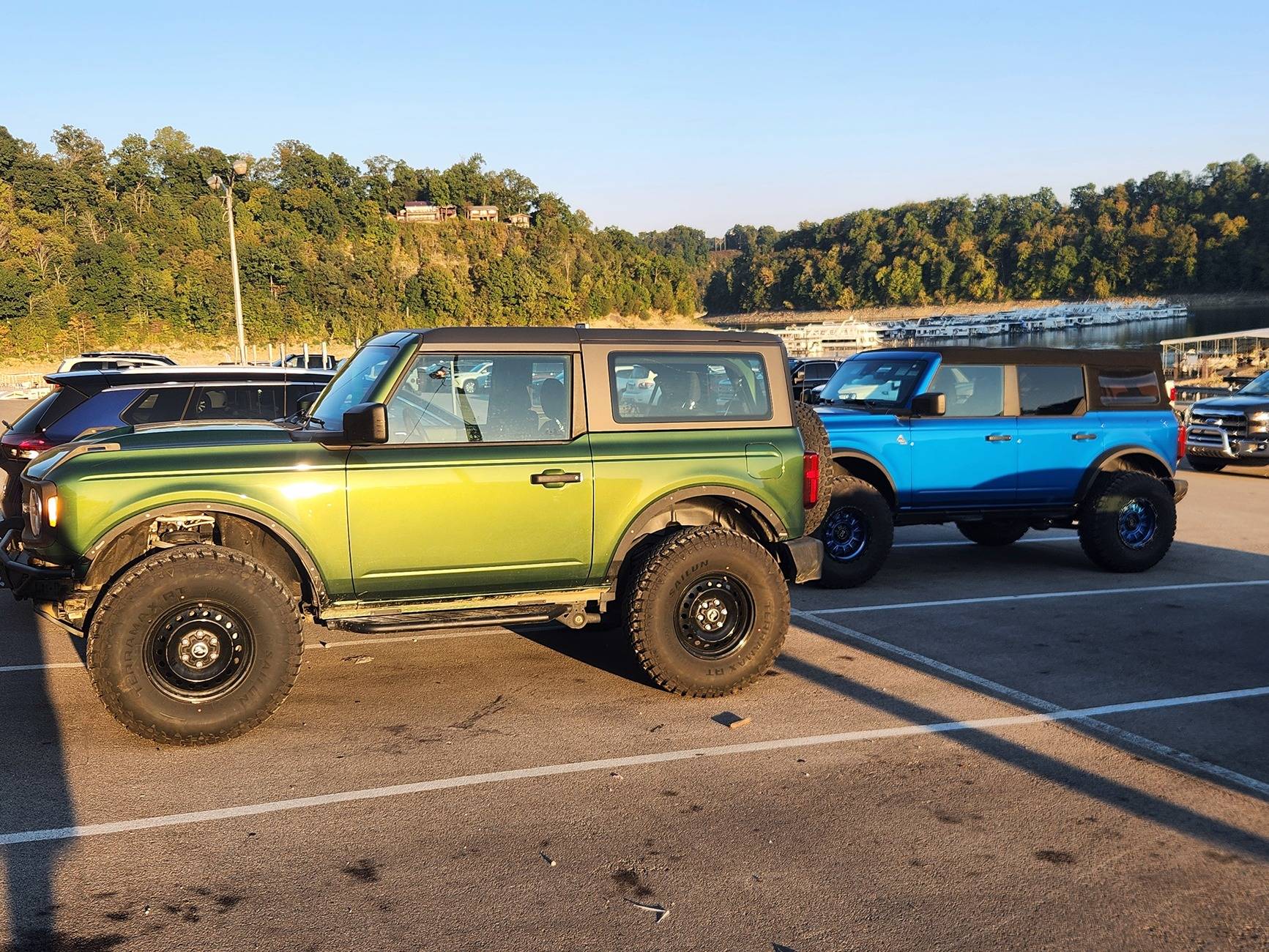

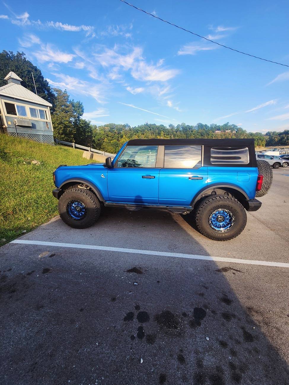

Ford Bronco Help Needed For 37's 1000000805
green is a base 2 in lift and 37s. the blue on is a 2 .5 lift and 37s .
Ford Bronco Help Needed For 37's 1000000804
