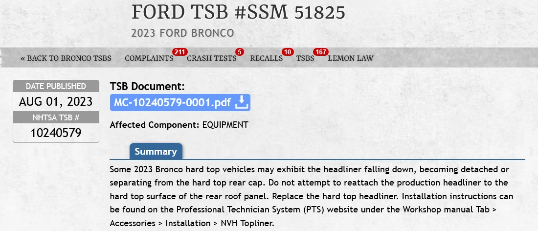

My headliner failed in the first few months (August 2023). Apparently there was a bad batch back then. The dealer did remove the old headliner and install a new one. The headliner kits come with the adhesive on them,maybe they're a peel n stick. They did remove the hardtop to remove and clean the old liner. I believe they used IPAlcohol to remove the old adhesive.
There is a TSB on it:
Ford Bronco Headliner coming loose - replace entire thing? 1758068623236-x6

Mine is a 22. Ordered in March of 2021.
If they are willing to take just the hard top I'm more than happy to drive to work topless. With the AC on of course. Let's not be crazy.
