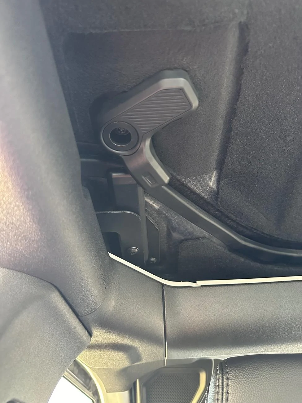

I’m having the same problem with my 2023 Bronco Wildtrak hardtop roof. The right, rear passenger side, (right above the passenger door) keeps unlatching while driving. I took it to my bronco dealer and all they did was replace the latch. It didn’t fix the issue and it’s still unlatching this day. We’re taking my bronco off-roading in the fall and I would hate to lose my hardtop or have to keep stopping to check it. Attached screenshot of what it looks like after arriving at my destination, it’s already unlatched. If there’s a solution for this, please let me know.
thank you!
Yep, mine does that on BOTH sides. I literally have to relatch it every time I drive it. Did Ford ever find a solution for you? I'm ready to put some electrical tape around the latch and see if it stays secure. It's annoying as hell.

Thought I was hearing a bit more wind noise behind my head while driving.
while reading this, popped into the garage, and lo and behold… all three latches were in same position as the pic.
will keep looking in the future to see if this is reoccurring. Newish (2400 mile) OBX.
