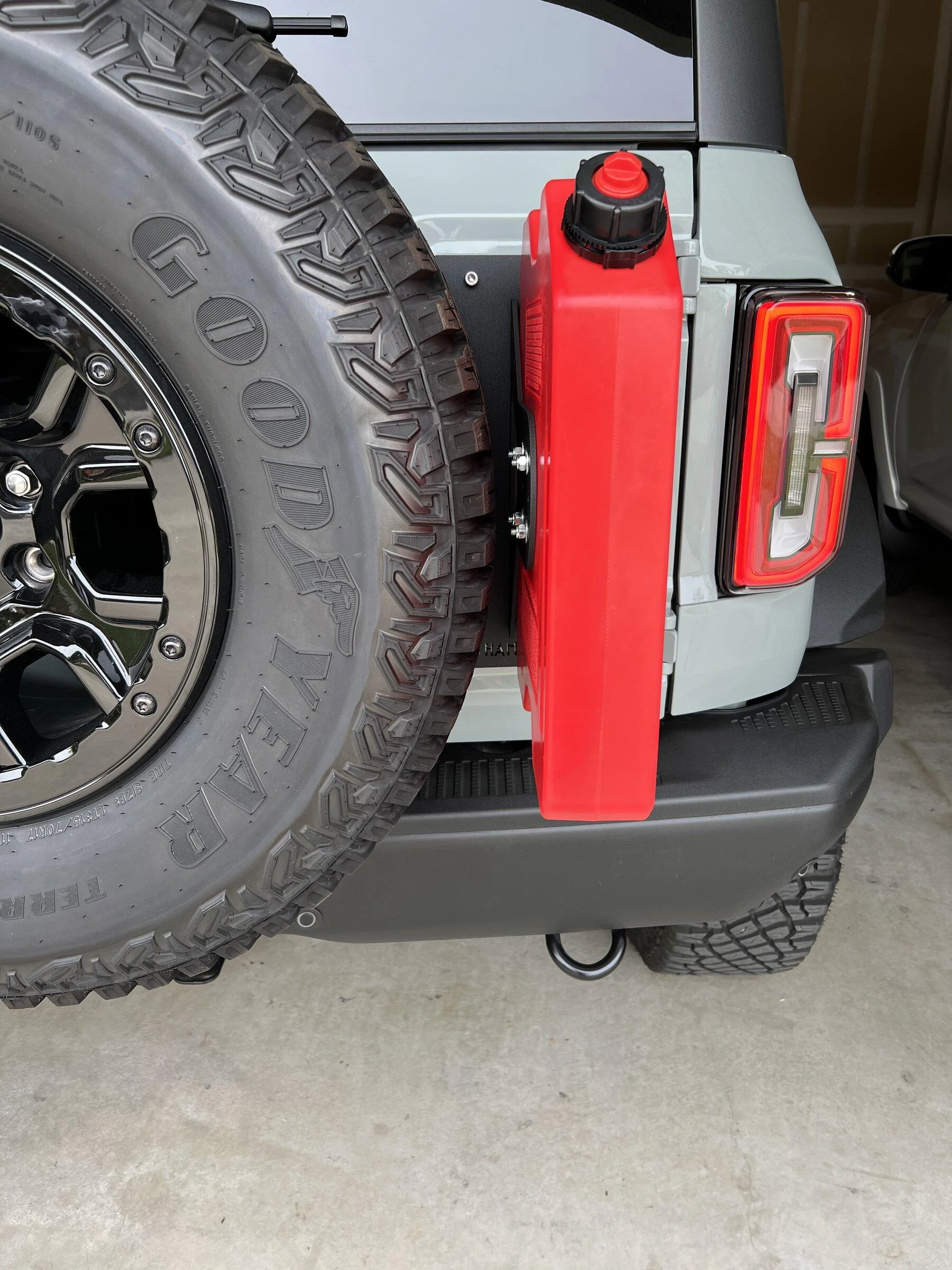

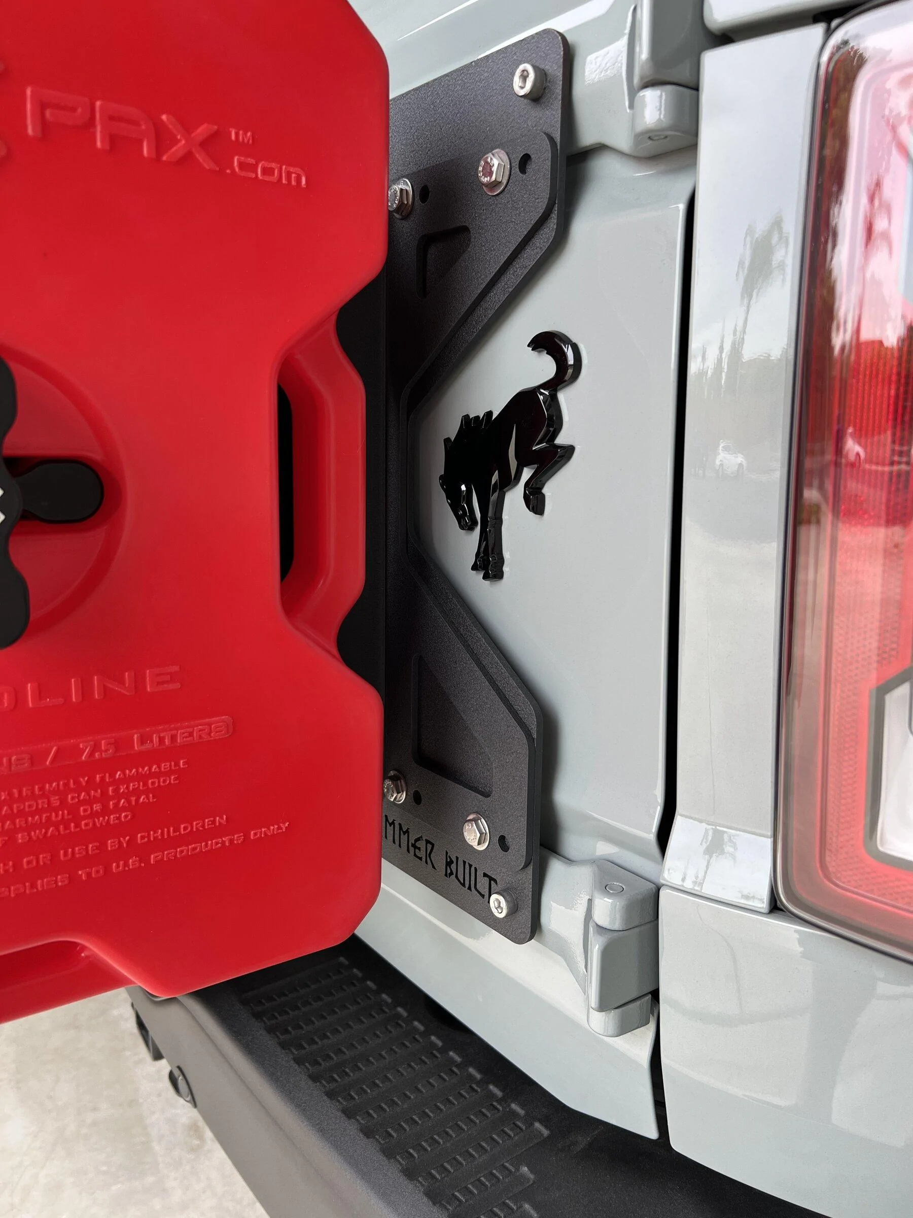

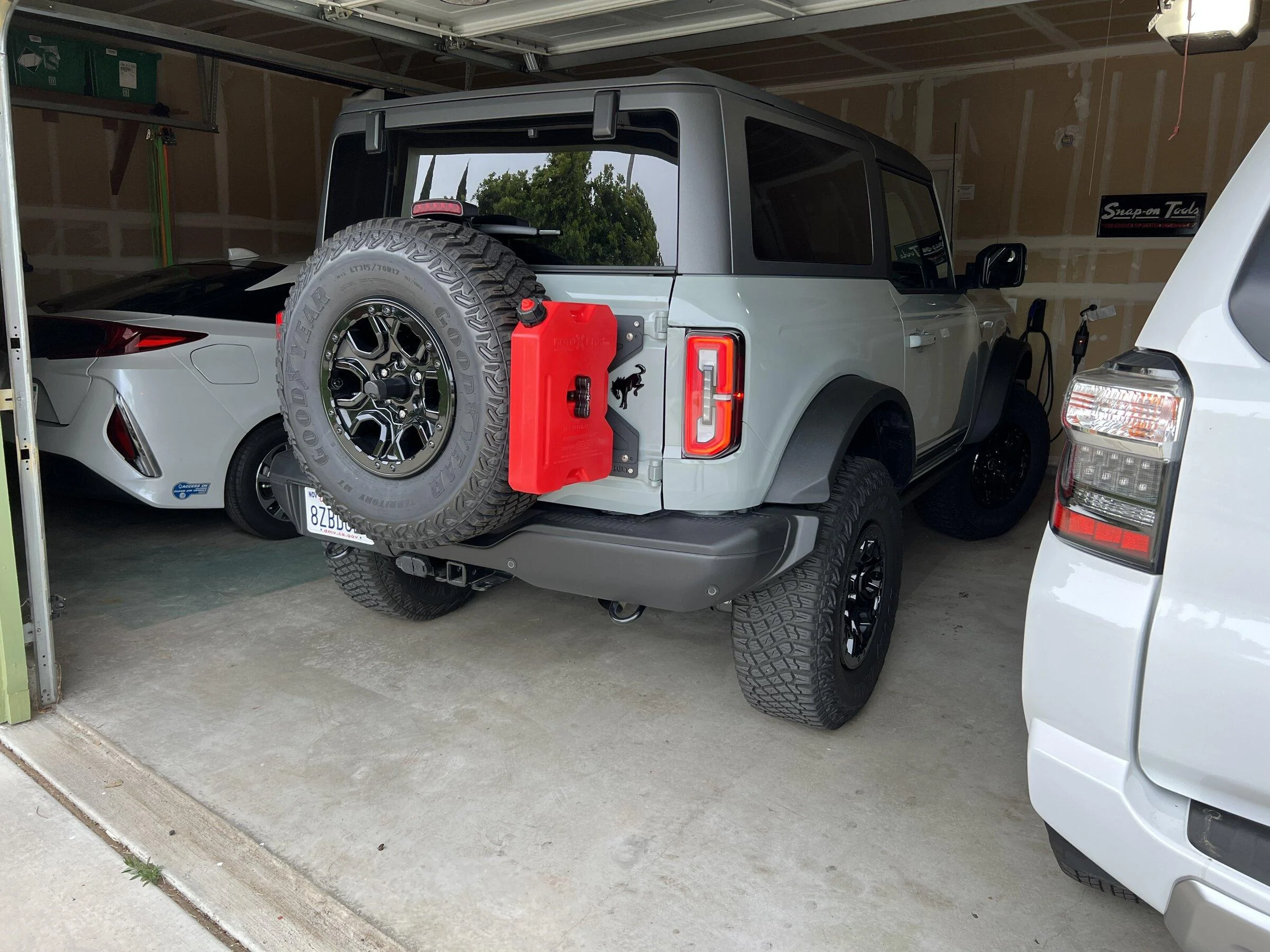

So I have had this brace by hammer built installed for 2 weeks now and I will say 95 percent of the noise is gone. I cannot even say the noise I hear is from the tailgate as the noise is so infrequent. I love this brace.
I ordered the exact same setup you have from hammerbuilt last week. Can’t wait to get it
