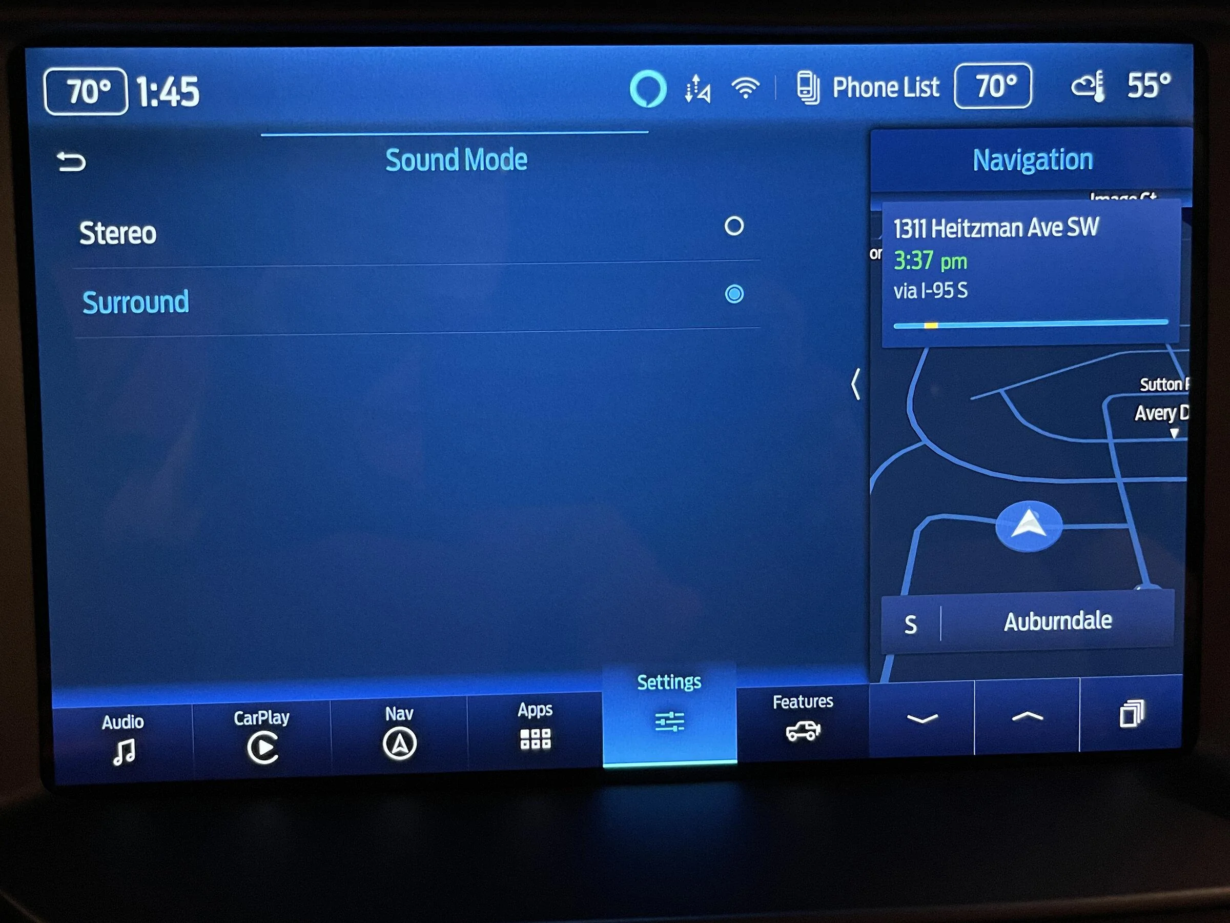

I received my 2022 OBX Lux last week. I read the entire manual and in the section for settings on the stereo, it was default to Stereo and Surround was a second option. I changed to Surround. It was a huge change in the B&O system sound. Maybe check that you are in Surround?
Had it in surround since it left the dealership. 3k miles later…the B&O system still sucks. This coming from my wife who is not the one in our household who typically upgrades audio in vehicles.

Here I was getting excited after flip got it to work to only find out it wasn’t the B&O system.
