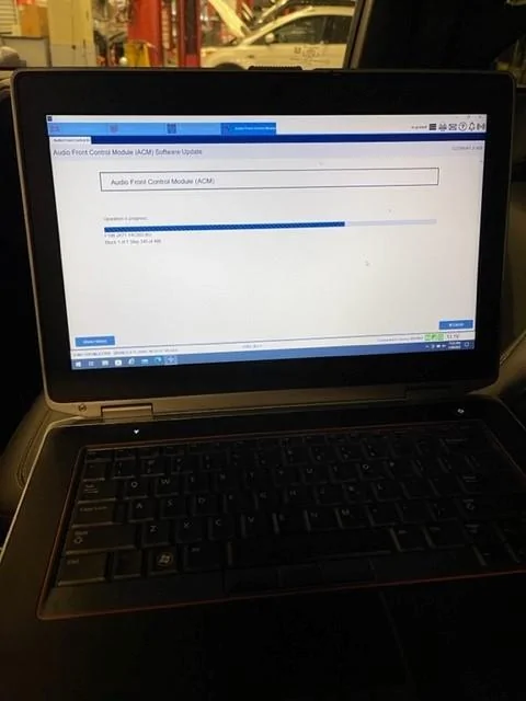

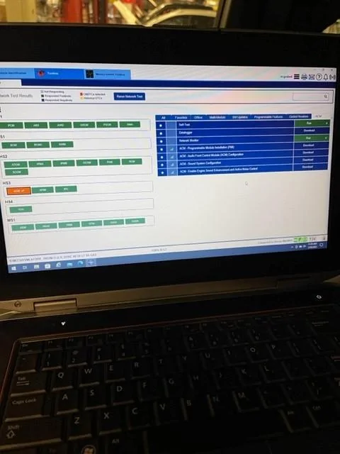

Survey says........................................................F YEA!
Works, have caps on rear speakers and can tell there's more range and db. Did not need bar in vehicle or anything disconnected. Took about 10 min after hooked up to do the file install.

@flip The instructions say this is for the 6 speaker system. With your experience, do you think this will work with the B&O system?
Let me check on our FE next week. If it shows up in FDRS for that VIN, it should. My gut tells me no.
