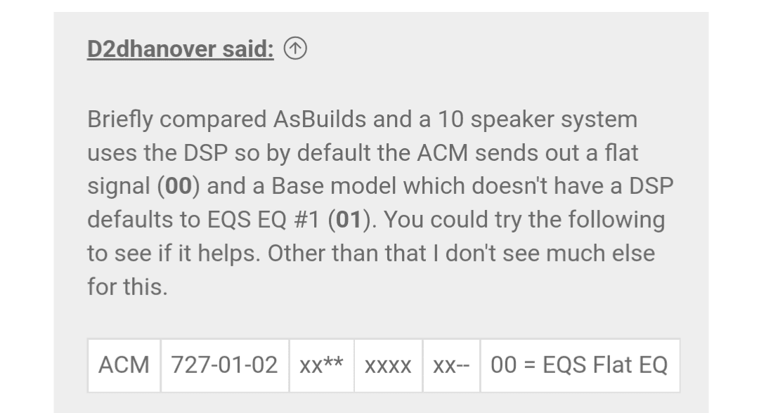

I didn't install a subwoofer but I upgraded my 4" speakers in both the dash and the rears. My fronts worked with no issues, my rear speakers sounded flat and got no bass and zero movement from the cones. Tried rewiring negative to positive etc but that did not work either.
I then found this post (pic attached) regarding forescan and my rear 4" speaker issues are solved. They now sound just like the front dash speakers with bass and cone movement.
