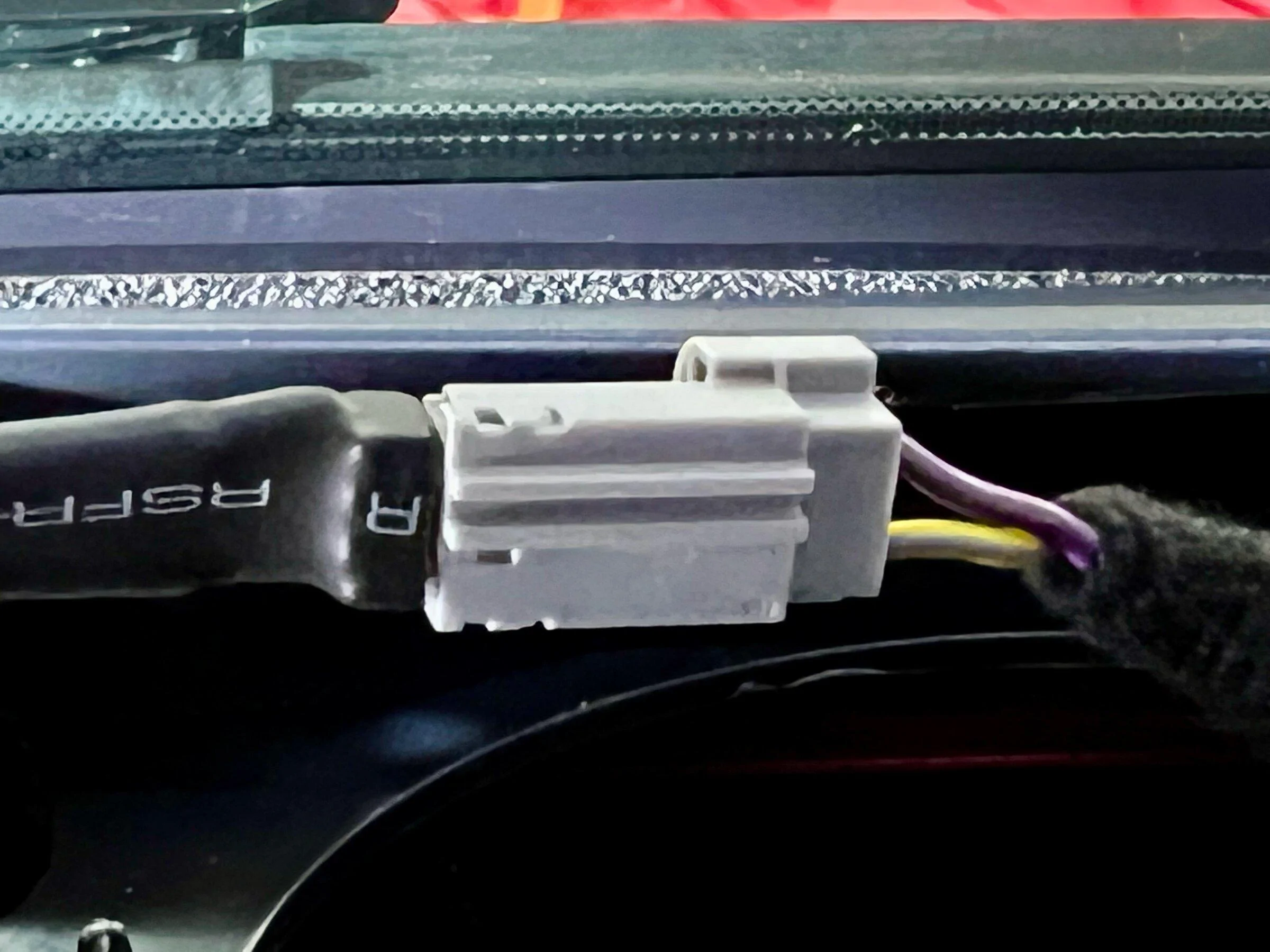

Are there any plug-and-play replacement speakers? I would be fine replacing the speakers, but something about cutting wires in a brand new car really freaks me out.
Well, with speakers it’s not as freaky as…

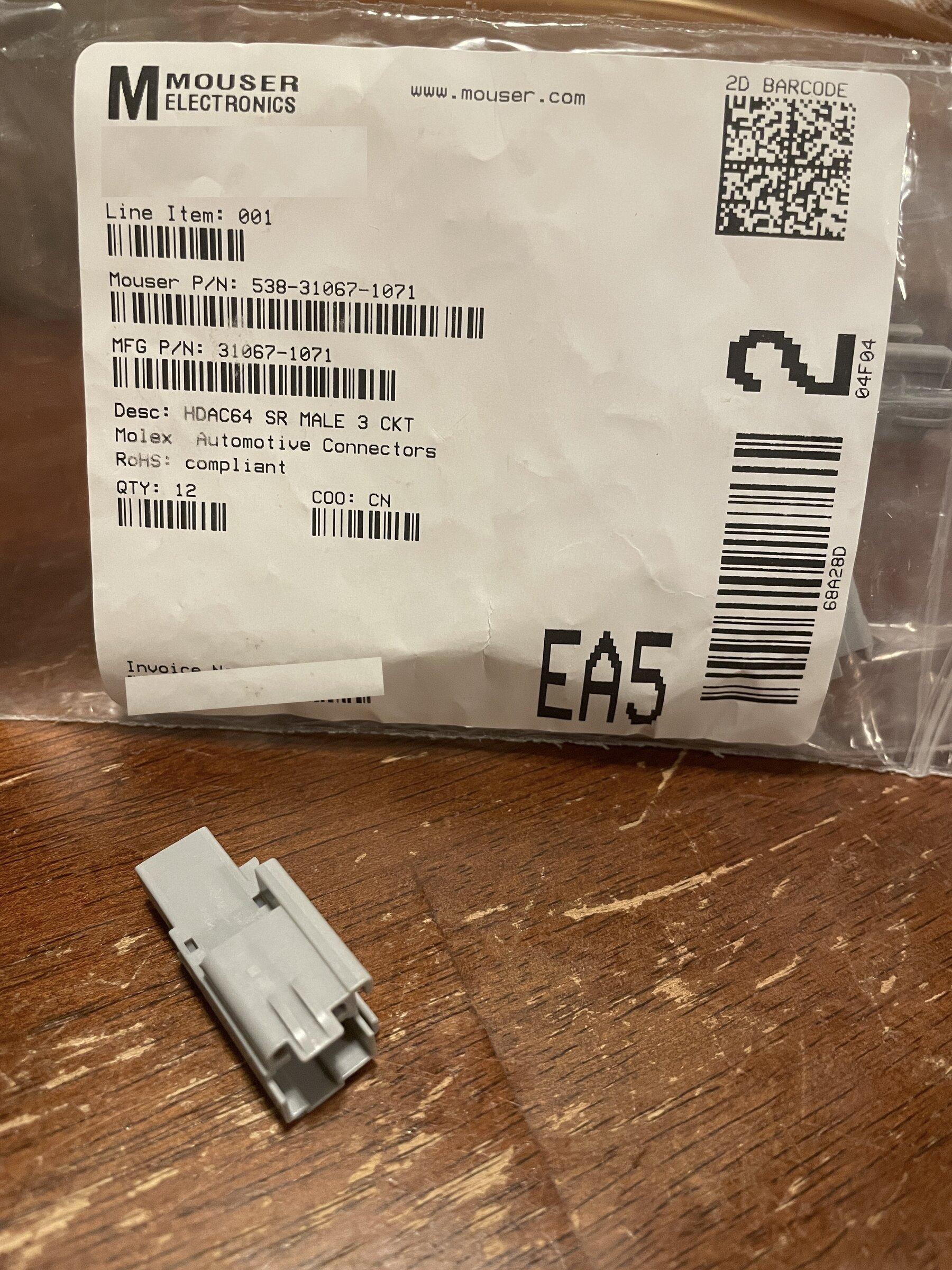

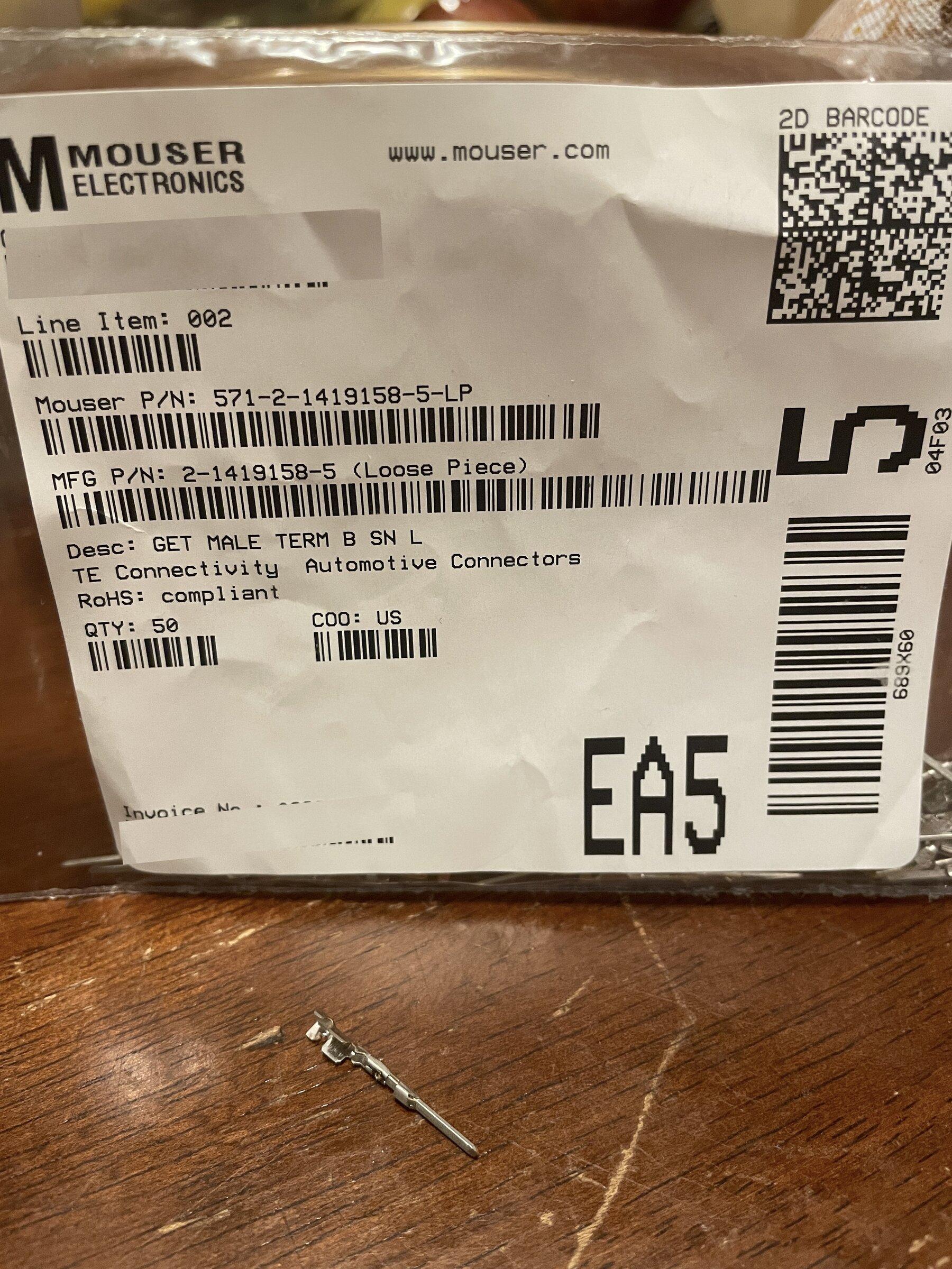

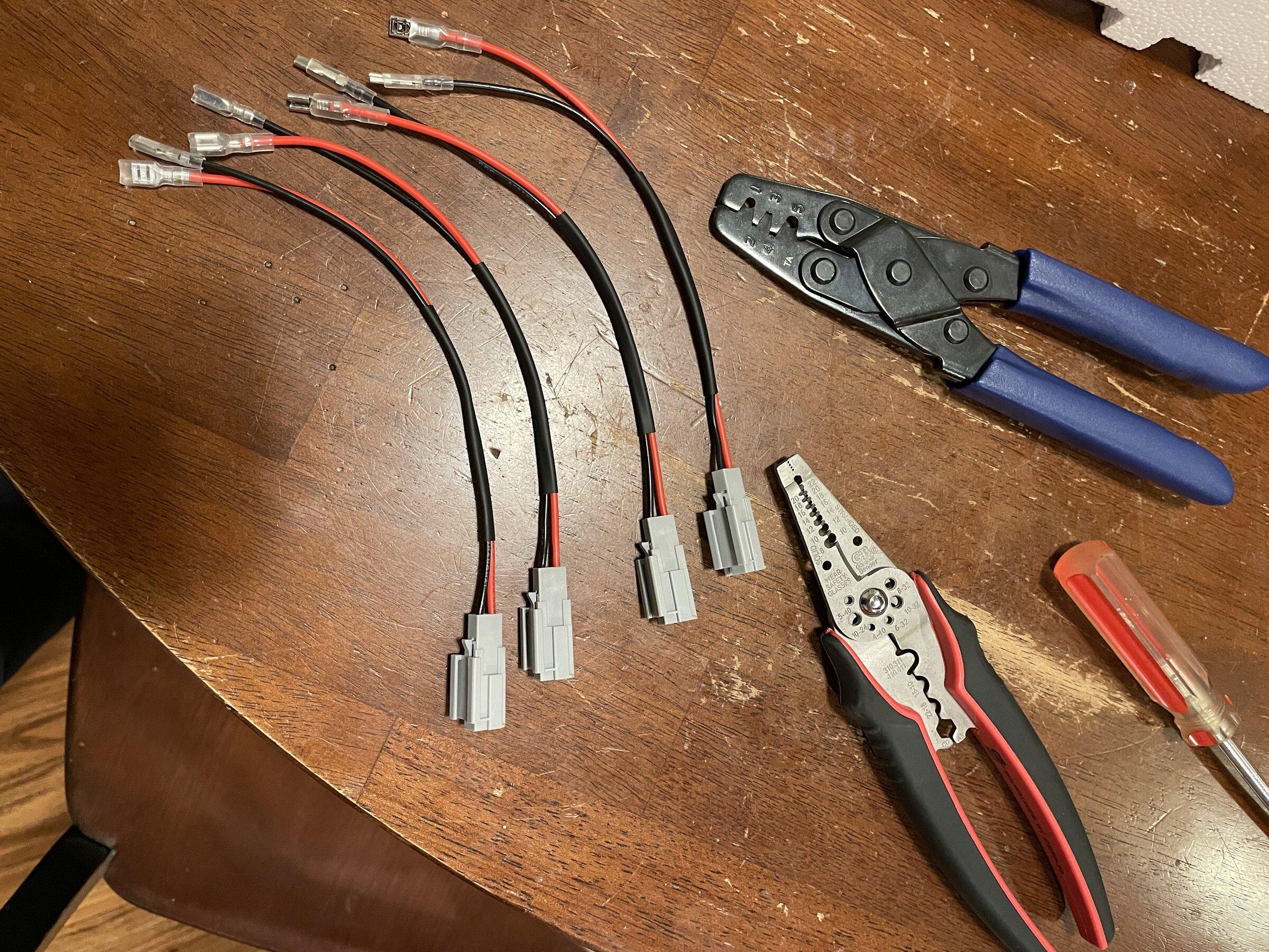

I made adapters. I think you can buy them now too but I have purchased the connectors and pins a while back. I still haven't installed my speakers yet. Was hoping to tackle it this weekend
What are the connectors called. I don't mind making my own. Thank you.
I bought the connectors and pins from Mouser Electronics. Id recommend ordering several extra pins. They can be messed up pretty easy so having extra on hand is good idea.

I bought these wires from Amazon. The Infinity ref speakers that I bought didnt include pigtails. So, I needed those terminals anyway
Those look great!

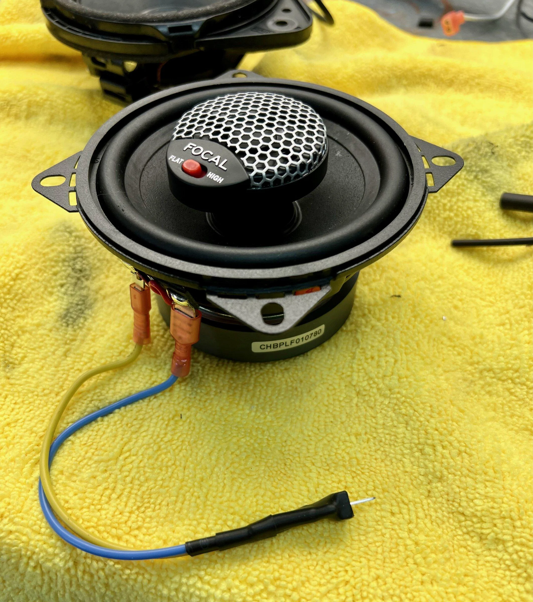

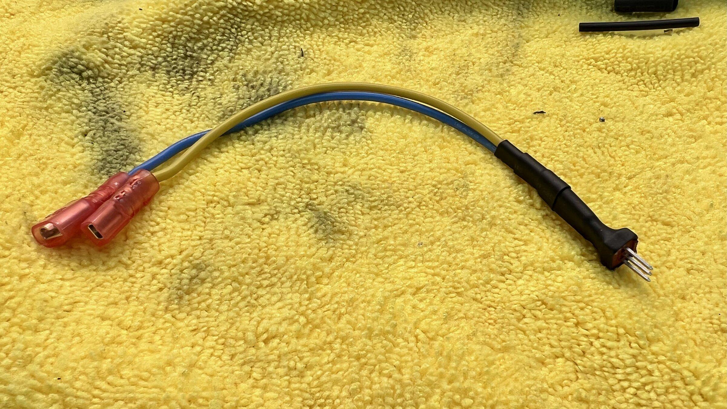

I didn't have the patience to order the connectors from Mouser, but rummaging through my connector box I found some Molex KK series 3-pin header strips (middle pin is unused) that were a perfect match for the pin alignment on the factory connectors, but without the shell.
I soldered up some pigtails to them, a few bits of shrink-wrap, and crimped on spade connectors for the speaker end. They slide into the factory connectors with a super-snug fit. They are designed to just be friction lock, there is no chance they are ever vibrating out, but you could always throw a piece of tape over the pair to lock them in place as well. Zero cutting, 100% reversible, less than a couple of bucks to make a pair.
Also, the stock speakers *definitely* have a high-pass capacitor filter built into them. I can't see any value printed on the cap without getting destructive, (which would tell us their crossover frequency) but it would be interesting to see what the value is, and if it is different dash to rear speakers.
Here's my pigtails:
Ford Bronco Full Range to rear speakers Bronco speaker mod - 4
Ford Bronco Full Range to rear speakers Bronco speaker mod - 5
Ford Bronco Full Range to rear speakers Bronco speaker mod - 6
