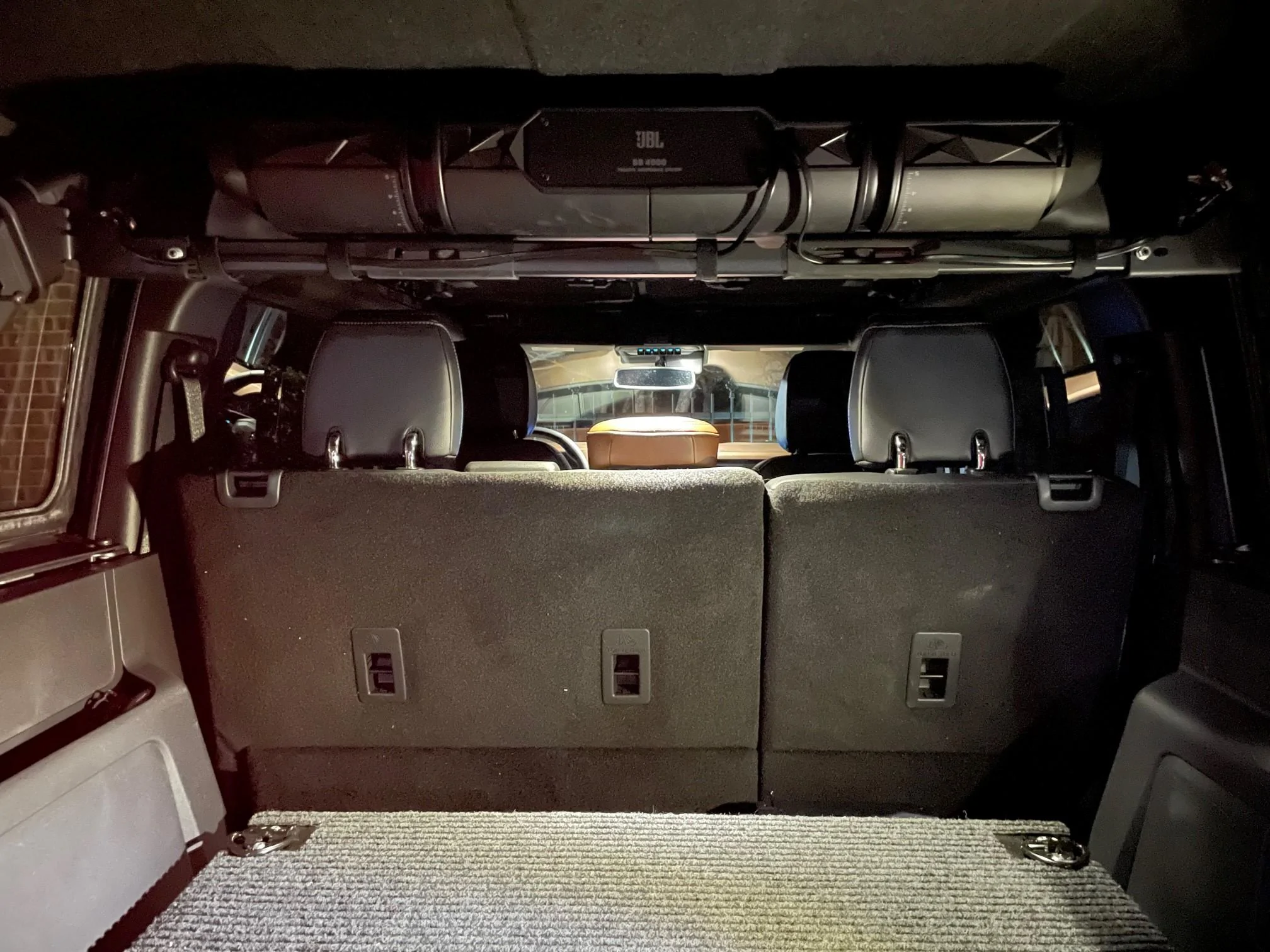

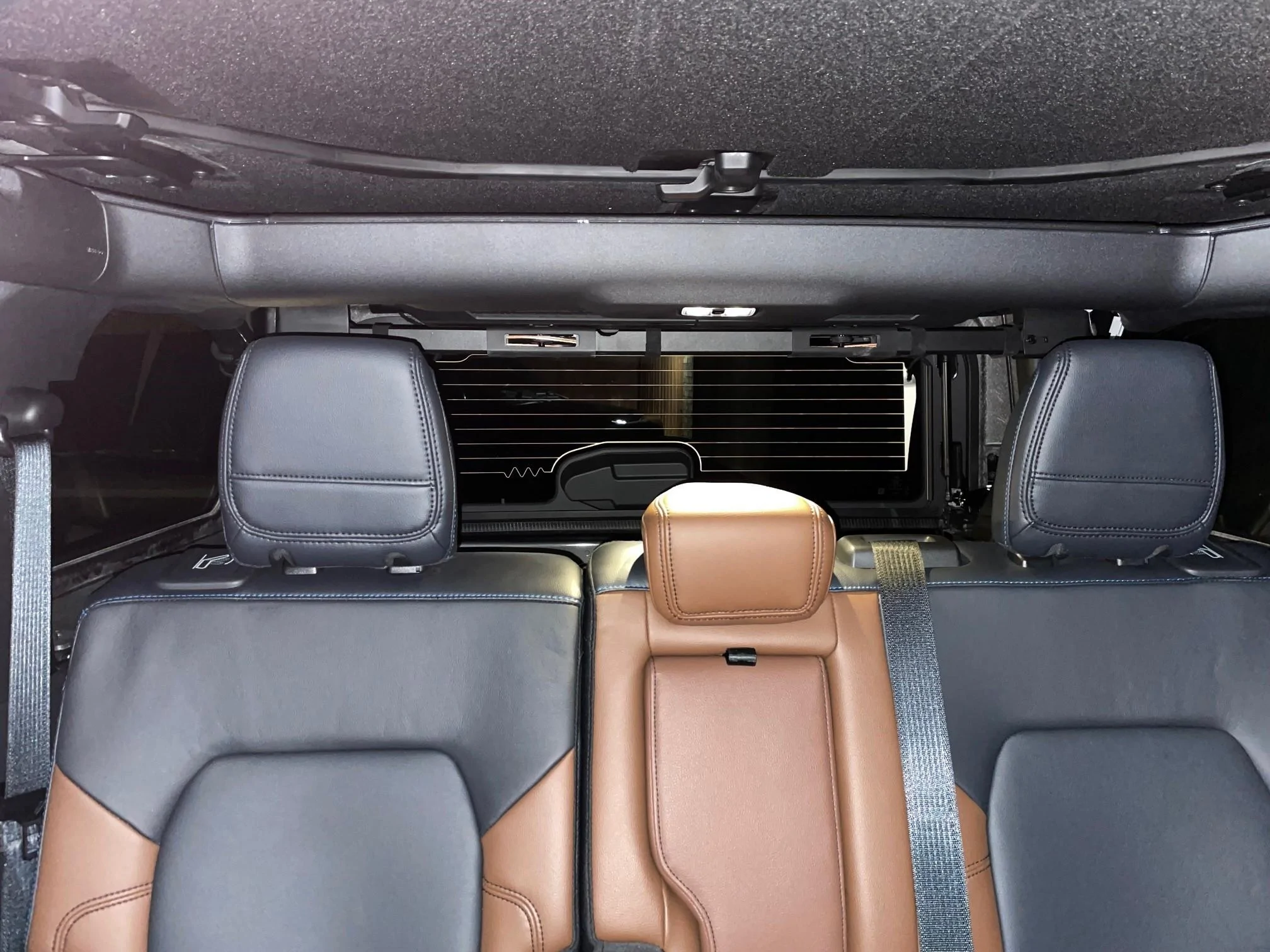

Here's the view from the front and the rear with the sound bar "upside-down" which puts it up high.
You are genius person type. I found some cheap on ebay, but didn't want to block my rear window. Wow.
