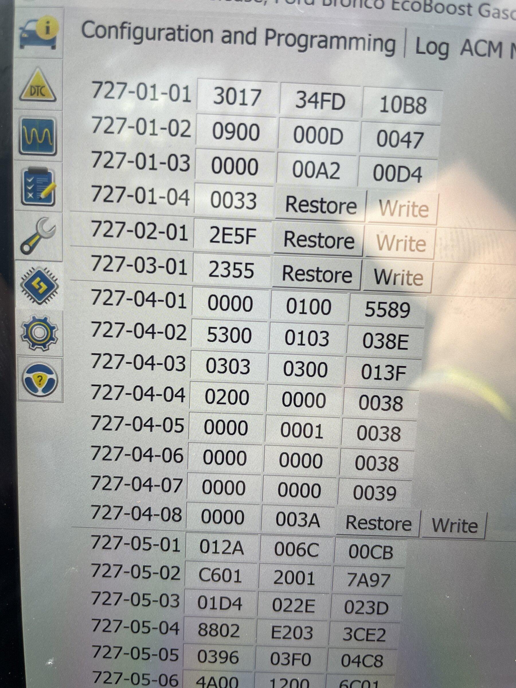

No changes have been made, EVER, to my ACM and no flashing done either. But check out my Forscan programming and explain these factory numbers…..3017? And the 900 on line 2 was already factory on my ‘21 Badlands Lux Squatch 2.7 ST with B&O, build date 8/31/21.

Thanks for posting your B&O as-builts. Now we just need someone w/ the soundbar flash to post there’s too.
Thanks for posting your as-builts.

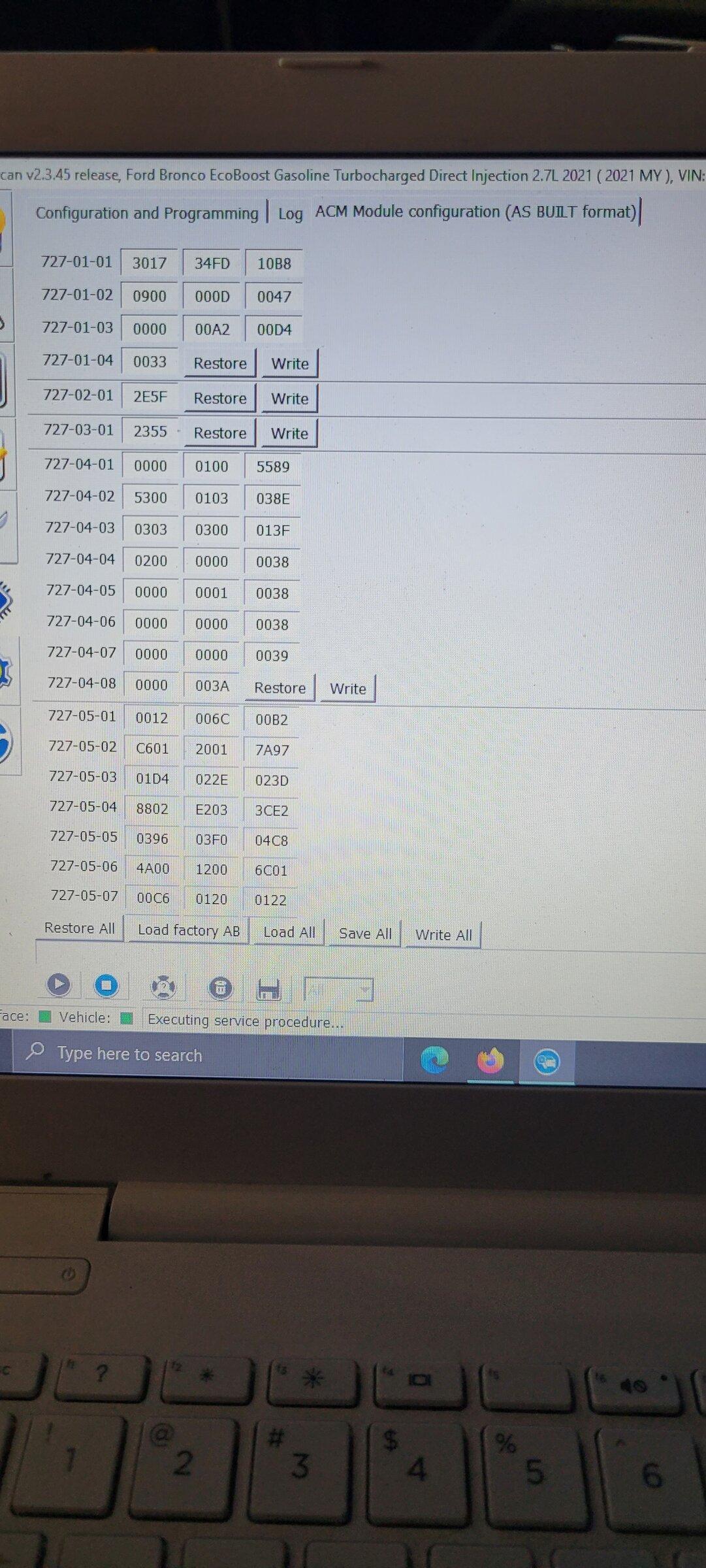

So I have the B&O system and did the soundbar flash here is my forscan numbers I am not as familiar with forscan as many members on here so I'll let them decide if anything is different

Difference I see between the B&O as built grid and the B&O w/ soundbar turned on that the 2 above provided is:
As Built B&O - 727-05-01 012A 006C 00CB
B&O w/ soundbar - 727-05-01 0012 006C 00B2
