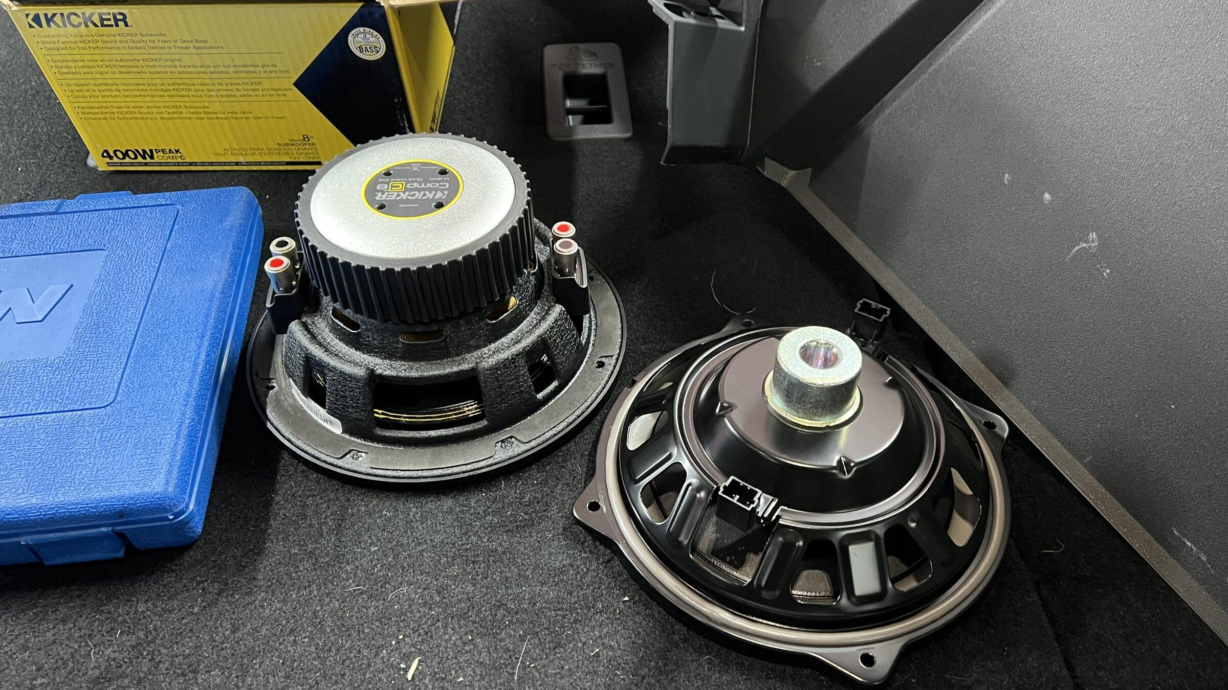

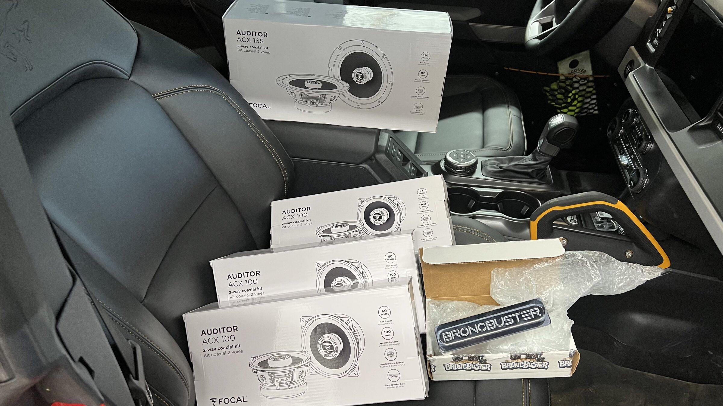

Just finished my Kicker sub replacement, sounds pretty good after getting it sealed tight and tracking down rattles. Just listened to the stock 6.5s, my iPhone sounds better, they’re outta here. Just need the bass blockers that are still in the mail, this all arrived today.
