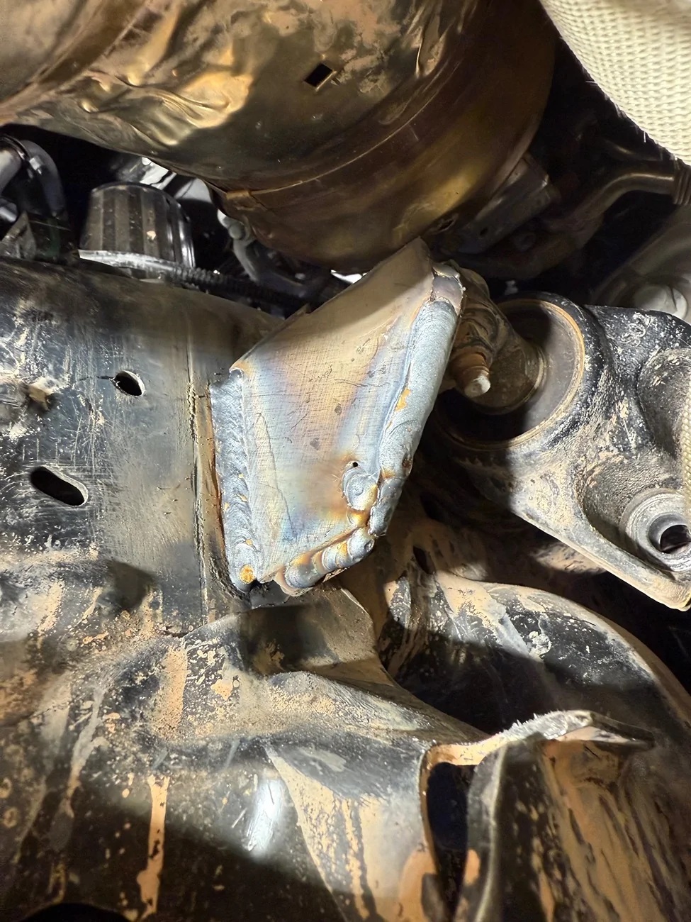

Mine broke. Thought it was the CV than today I started inspecting and saw the bracket was broke.
Dangit. It’s not too bad to get in there to repair. Granted I didn’t repair ours as it was still okay, but recently strengthened it since we had the diff out getting regeared.
Are you sure the welding heat didn't weaken it all more than the exta plate?
