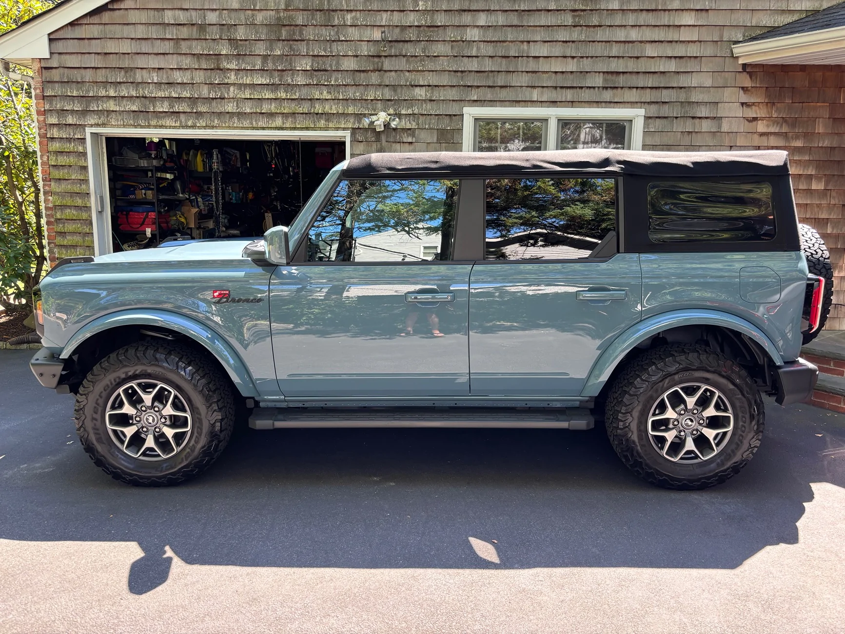

This is my Bronco, no lift or big tires either
