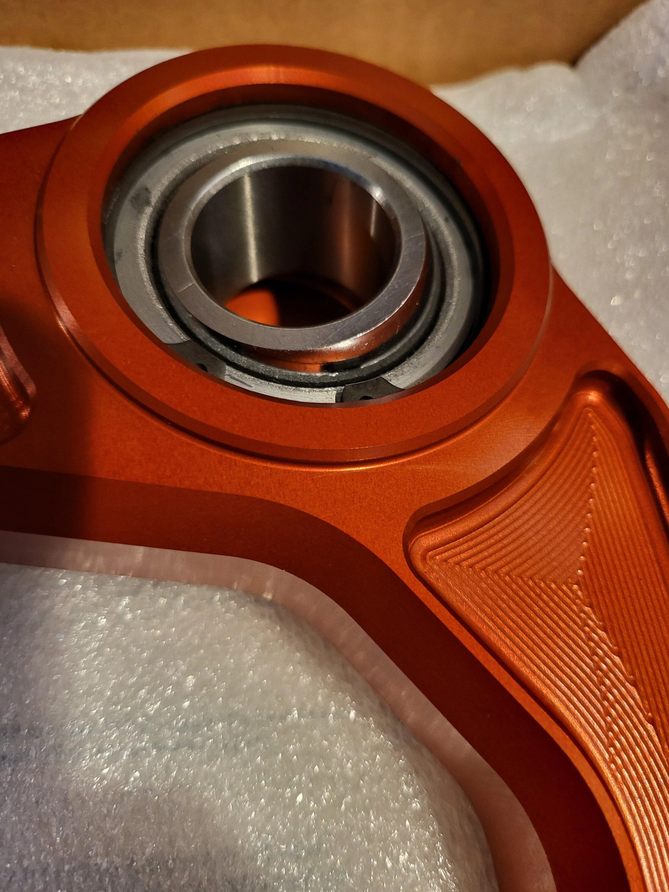

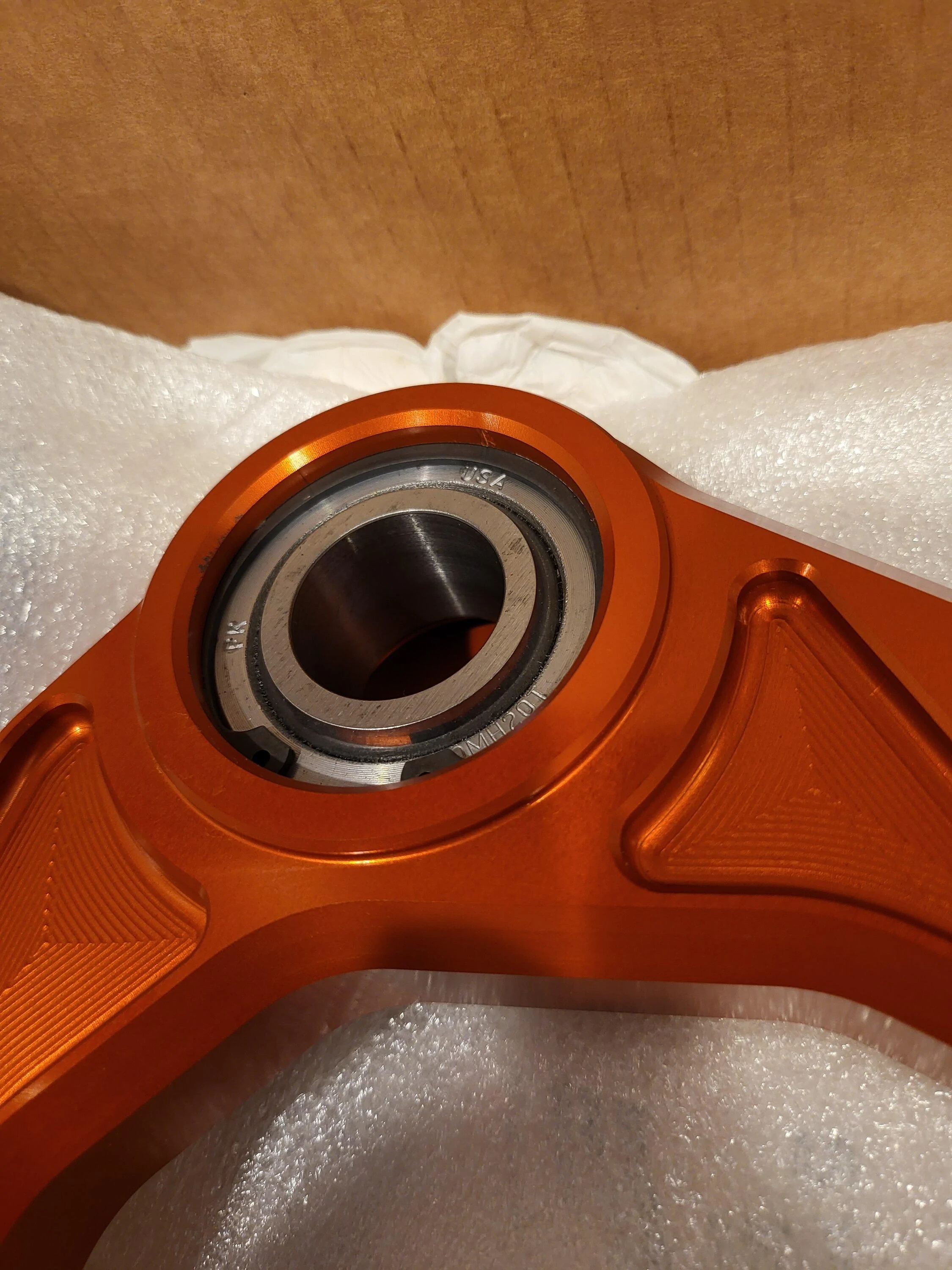

I just got my UCAs from Foutz and I'm not sure if this bushing is right or not. I've never installed a set and want to make sure this isn't something I need to address before install. Thoughts on how this bushing is sitting? The bushing on the other arm doesn't sit the same way.

Not a bushin at all, that's an unival pivot, let's say thats the current tech we using, greaseless unival pivots, they do wonders for ride quality and articulation

That part moves. As the others said, pivot for the uniball.
Word of caution>>>>>> Make sure the assembly is torqued properly. And checked regularly.
It won't be good if it comes apart.;)

Thanks fellas! I had a feeling it was ok, but needed to make sure since it wasn't a cheap investment. Also good to know about checking after its been torqued.

make sure you put the misalignment spacers in their proper position and orientation
