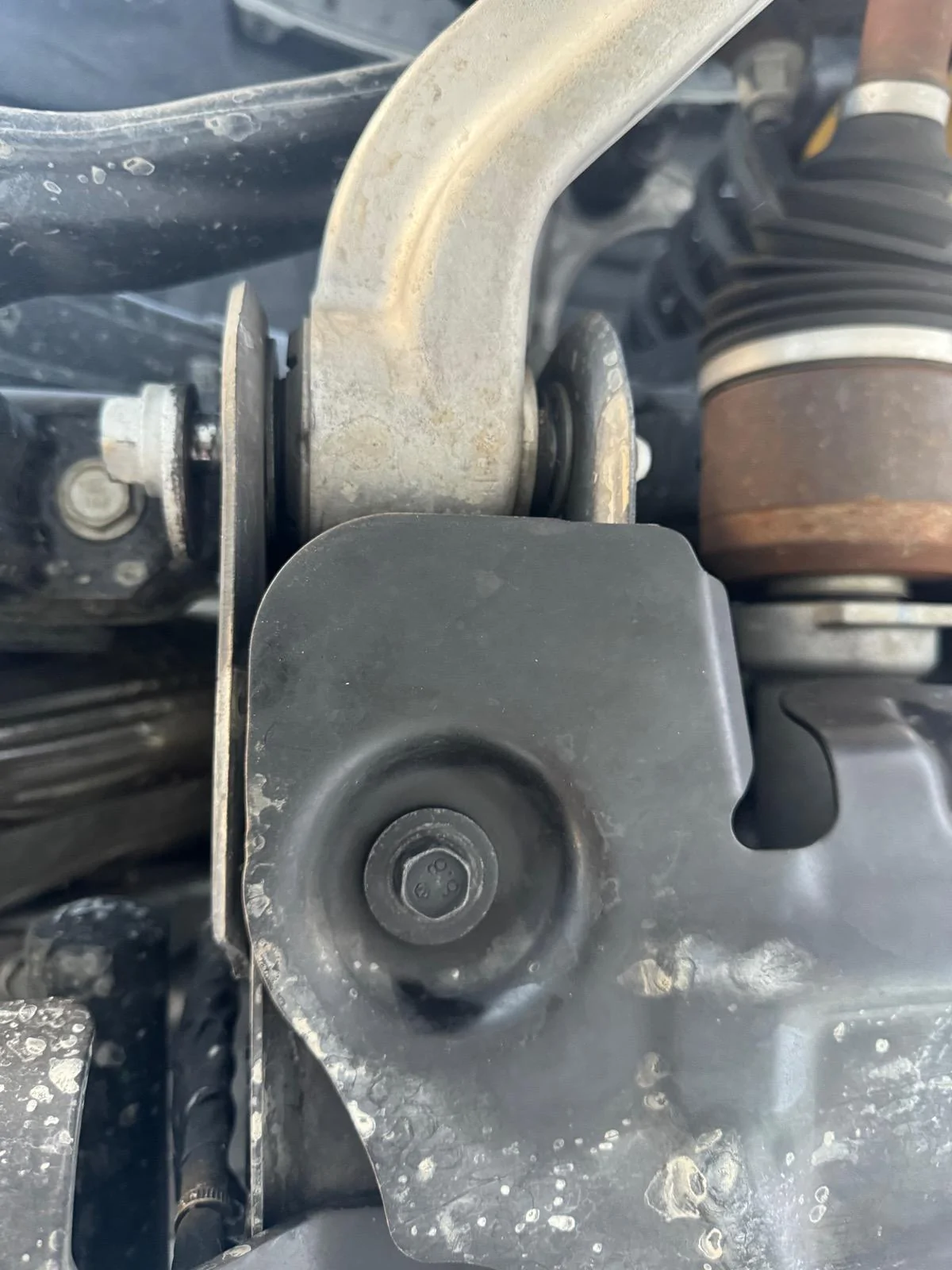

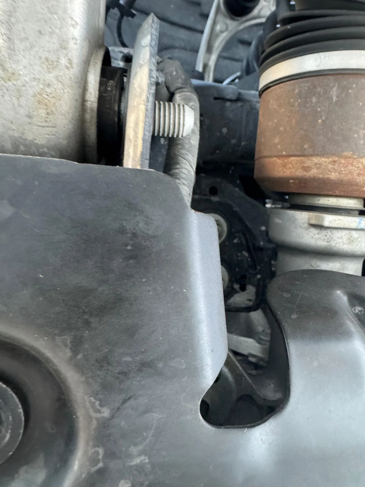

So I’ve been hearing a clunking sound every time I pull into my driveway the last few days. Metal on metal, but I don’t hear it any other time. Got under her today to this.
WTF. How does this just back off? Also, I’m sure they don’t inspect suspension during an oil change but it was just at the dealer 3 weeks ago. They sure as shit wanted to replace the cabin air filter for $60 but no mention of this.

That’s the lower, not upper control arm. Probably left loose after an alignment or lift kit installation.

Lol yes, you’re right. I was upside down so everything was backwards. No lift, so must have been during alignment.

Or left loose from the factory. My son just did the alignment on my 2024 that has less than 1000 miles on it and he said one side was barely tight at all. Ridiculous.
