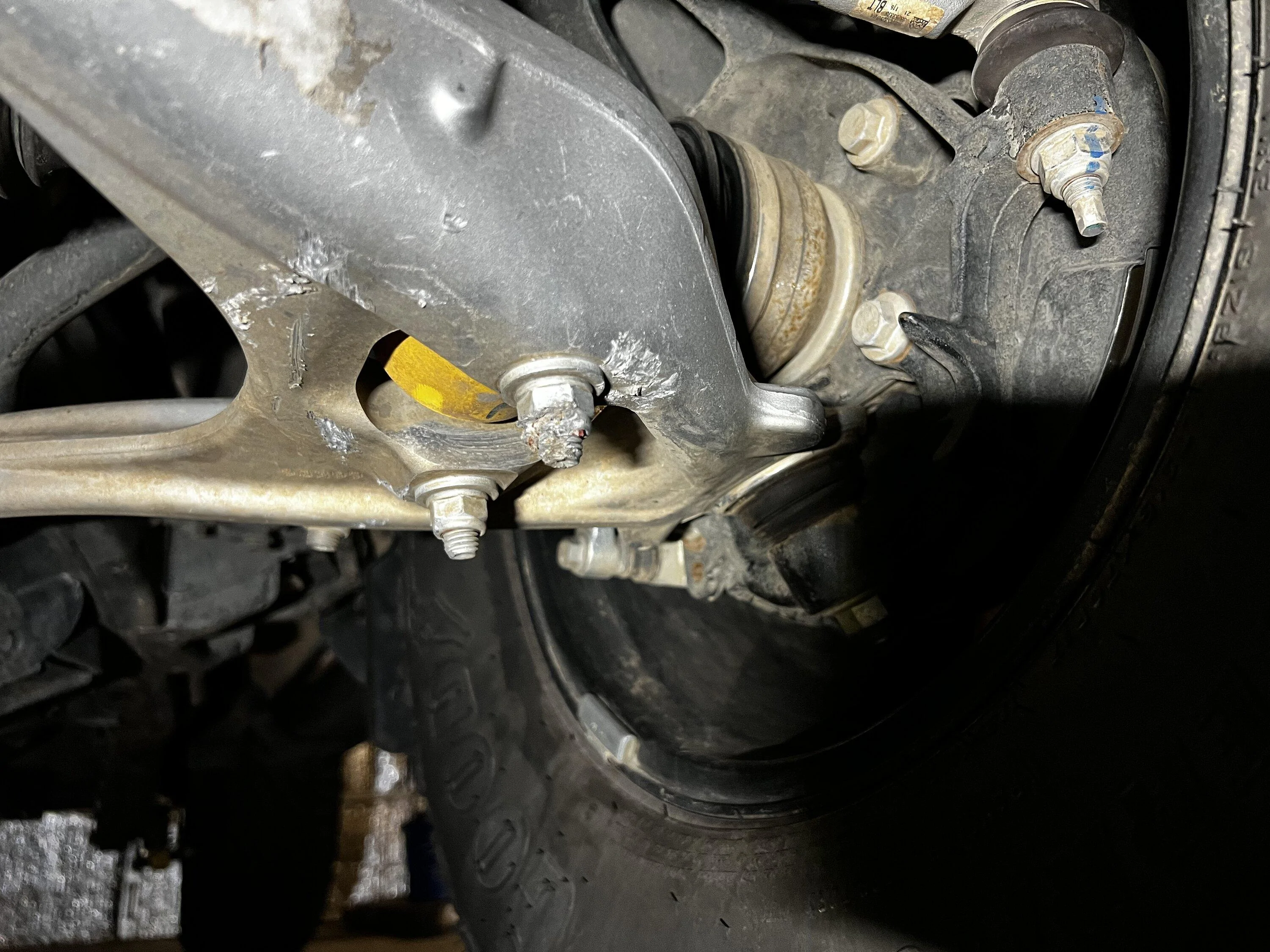

Need help with part number for the lower bolt and nut for bottom shock to A arm. As I have easily learned the hard way. This is prone to damage. I’m guessing this is also pressed to the shock? Was thinking I could do this myself. But maybe nut, not.

i recently replaced mine with new coilovers. Mine was pressed into shock. Youll need to drop lower control arm at frame side to get it out. Also will need an alignment after that. Dont take axle nut off to do this job unless you want to risk replacing the axle . Hammering the axle out of knuckle is risky.. I would leave it alone if its just a cosmetic thing.
lower bolt is a stud that is part of the strut assembly
Nut part number is W717969-S440

A lot of the lifts/leveling kits use new bolts that aren't anything special, I'd just run to the hardware store. And point them up this time.

I’d first try splitting the nut and then chase the threads with a thread die. Put a new nut on and then stay out of the water!
