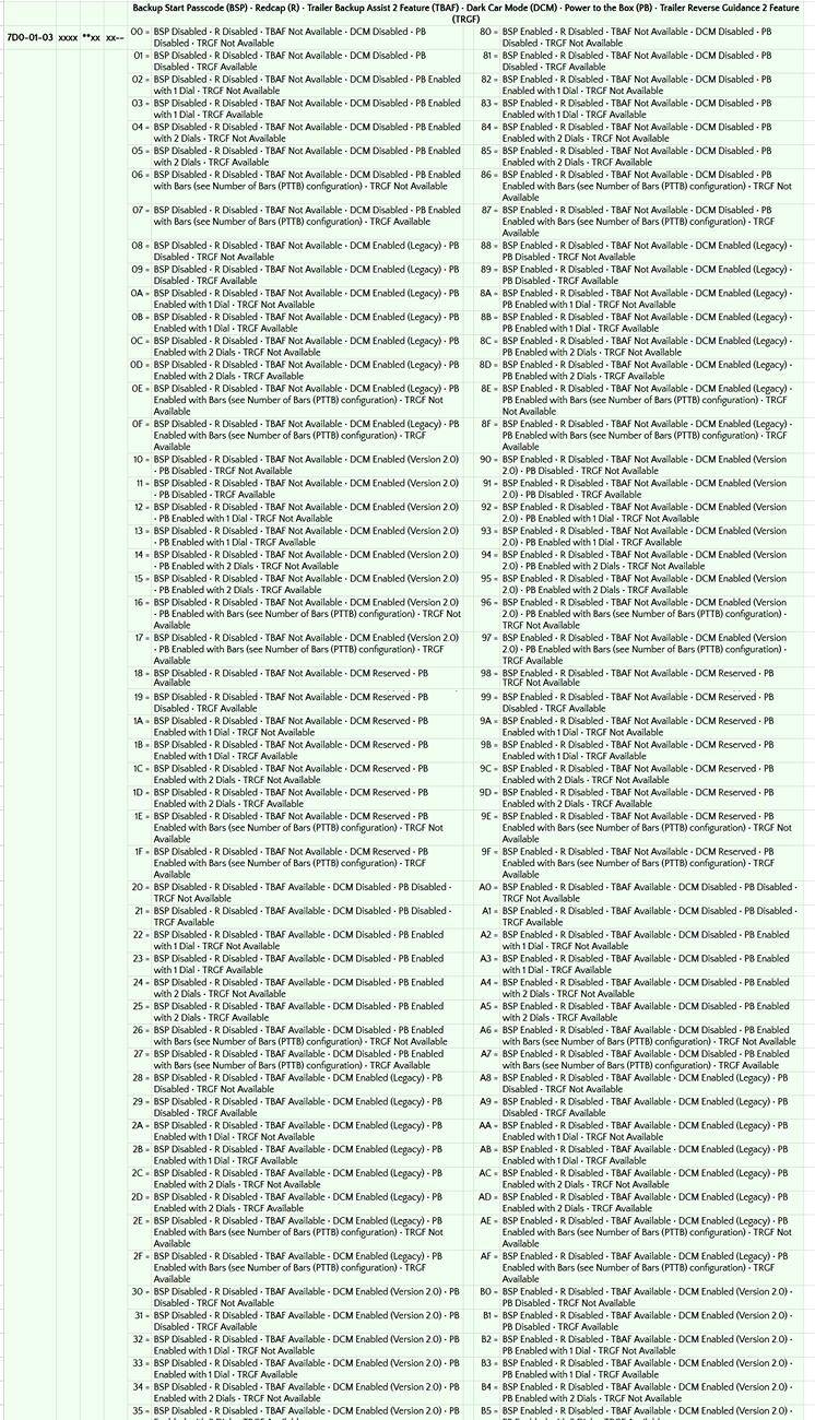

Livinitup has been on this for years now, and he's not alone. These guys have spent the time testing and documenting as many configurations as possible, one at a time. If you spend some time on the relevant F150 forums you'll see what I mean.
So you're telling me that someone sat there and tested all 256 combinations of these two bytes in the APIM and figured out all these different permutations? Then they repeated that process for tens of thousands more bytes across all the modules? No way.
I expect what they do is the get access to the main computer, have a harness that lets them get in between the signal lines and they just data log power on, startup, and some driving.
They can then look at what locations the engine computer is looking at in memory at different points. That tells them what they need to know to document what is going on.
It's not an exhaustive search. Also, all of these systems are documented somewhere. Sometimes they get access to the documentation.
You don't need to try every combination, you only need to find differences between certain values.
Those hex values are related to the equivalent of a four-digit binary number.
When you see differences, typically that is a single bit difference.
From there, you use the basis of comparison to see what's different about the vehicle, settings.
It is time consuming but you can deduct some information from that.
Really, that's all you're looking for is differences in values, and what the difference is between the two vehicles, and then you can extrapolate relevant information.
A terrible analogy would be put ting together a a puzzle.
Not need to try every combination to figure out what one piece goes, but based on relevant information like color shape. If it's a corner can narrow it down real quick.
I'm not talking about how to figure out which bits to flip to add fog lights to a Bronco. I know that can be done by comparing two As-Builts.
We're talking about how that spreadsheet came into existance. For just 2 bytes out of one module the spreadsheet lists 256 values for those two bytes and details exactly what each and every value does. (See screenshot above)
If the spreadsheet was a result of reverse engineering then you'd have to either try all the combinations or compare As-Builts between a hell of a lot of different models, and when doing that I can't fathom how you'd tell the difference between "DCM Enabled (Legacy)" and "DCM Enabled (Version 2.0)".

Again look at the bit value
If you look at the spreadsheet you attached, you can see.
None of those features are enabled at 00
01. Trailer guidance 2 is enabled
02 power box enabled and trailer guidance is not
That gives me 2 bits of value out of 8.
If you convert the hex decimal value to a binary value and then make a spreadsheet, you can determine what each bit does
It is time consuming but it not something that is not unsurmountable.
I would not necessarily need to try every combination. Just find what bits are different when I change a feature.
