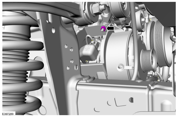

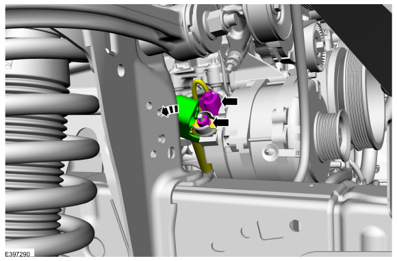

It says position it off the generator, whether there is room be removed completely or not I do not know @Jazer
Vehicles equipped with base generator shields
  1. Remove the upper generator shield nut.
    Torque: 18 lb.ft (25 Nm)
Ford Bronco {thread} {filename}
  1. Remove the generator splash shield.
    • Remove the lower generator shield nut.
    • Position the generator shield off the generator.
  1. NOTICE: When installing the B+ terminal nut to the generator, finger-start the nut before tightening or component damage may occur.
    Disconnect the generator electrical connector. Position the B+ wire protective cover, remove the nut and position the B+ wire.
    Torque: 155 lb.in (17.5 Nm)

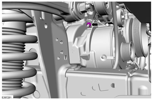

Vehicles equipped with enhanced generator shields
