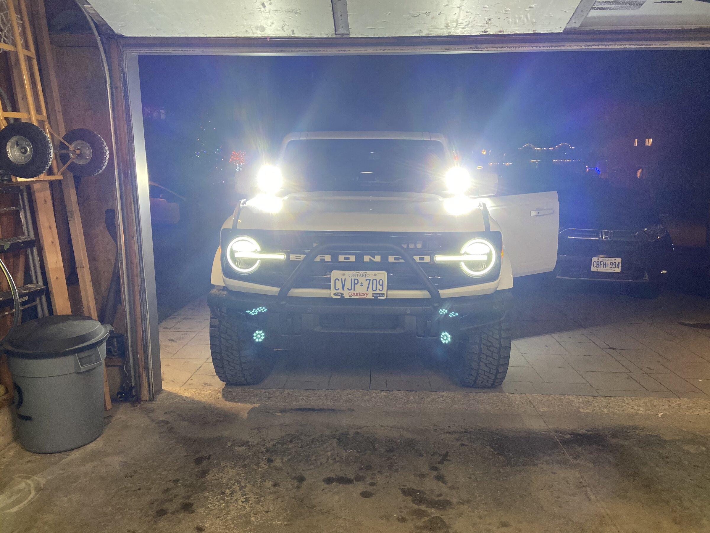

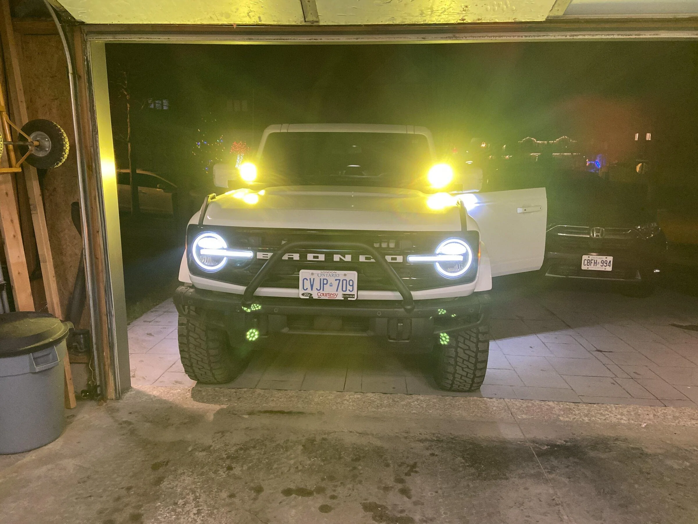

For ditch lights I installed Uni-bond lights. They are a very well known made in Canadian brand that specializes in emergency vehicle lighting.
They are both white and amber in the same unit. I wired them to Aux switches 3&4 white to #3. Amber to #4. I think the work great and look really good. They are 4”x4.25”.
I will say that visibility is better with Amber. But nice to have both options in one.

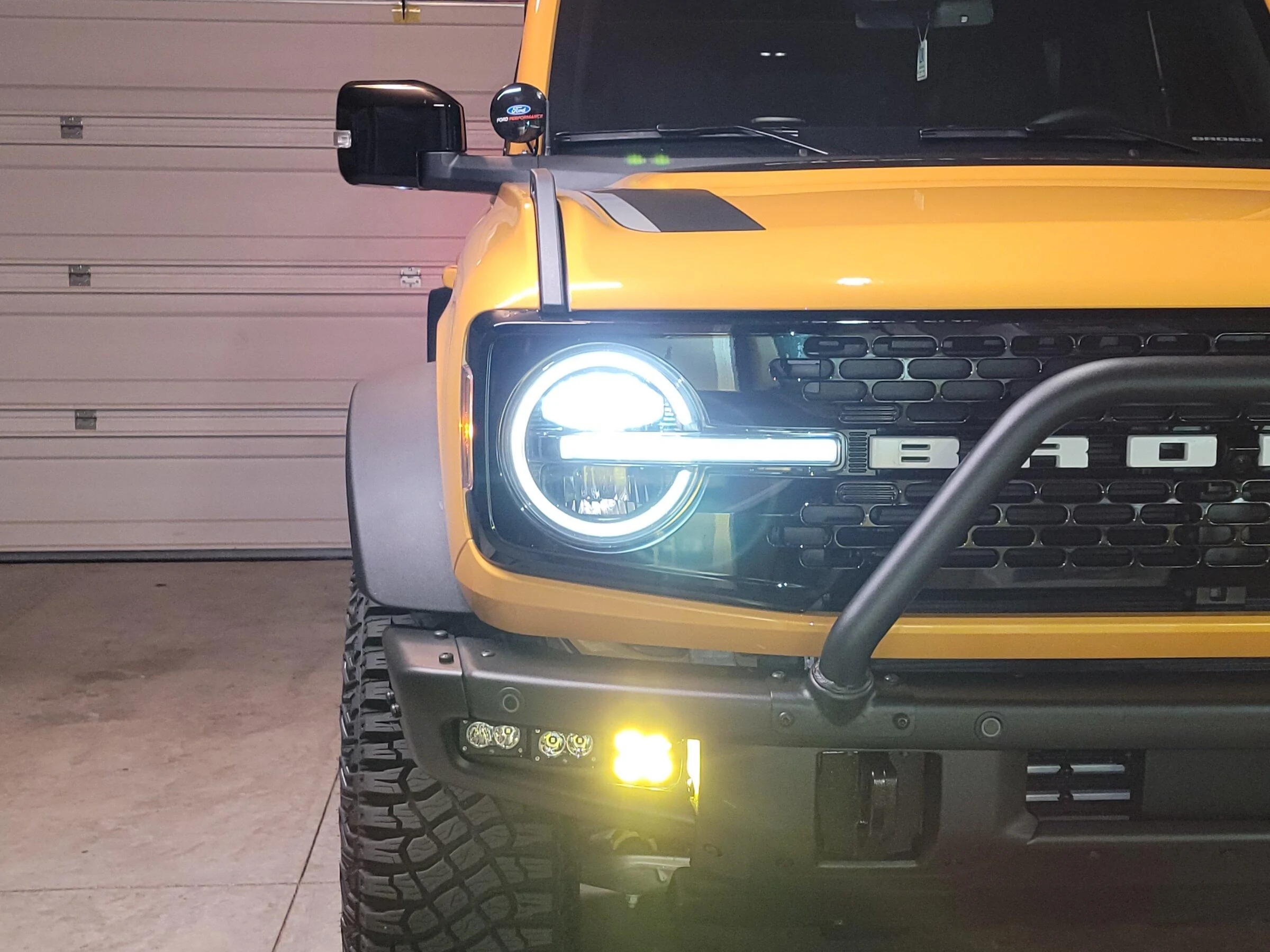

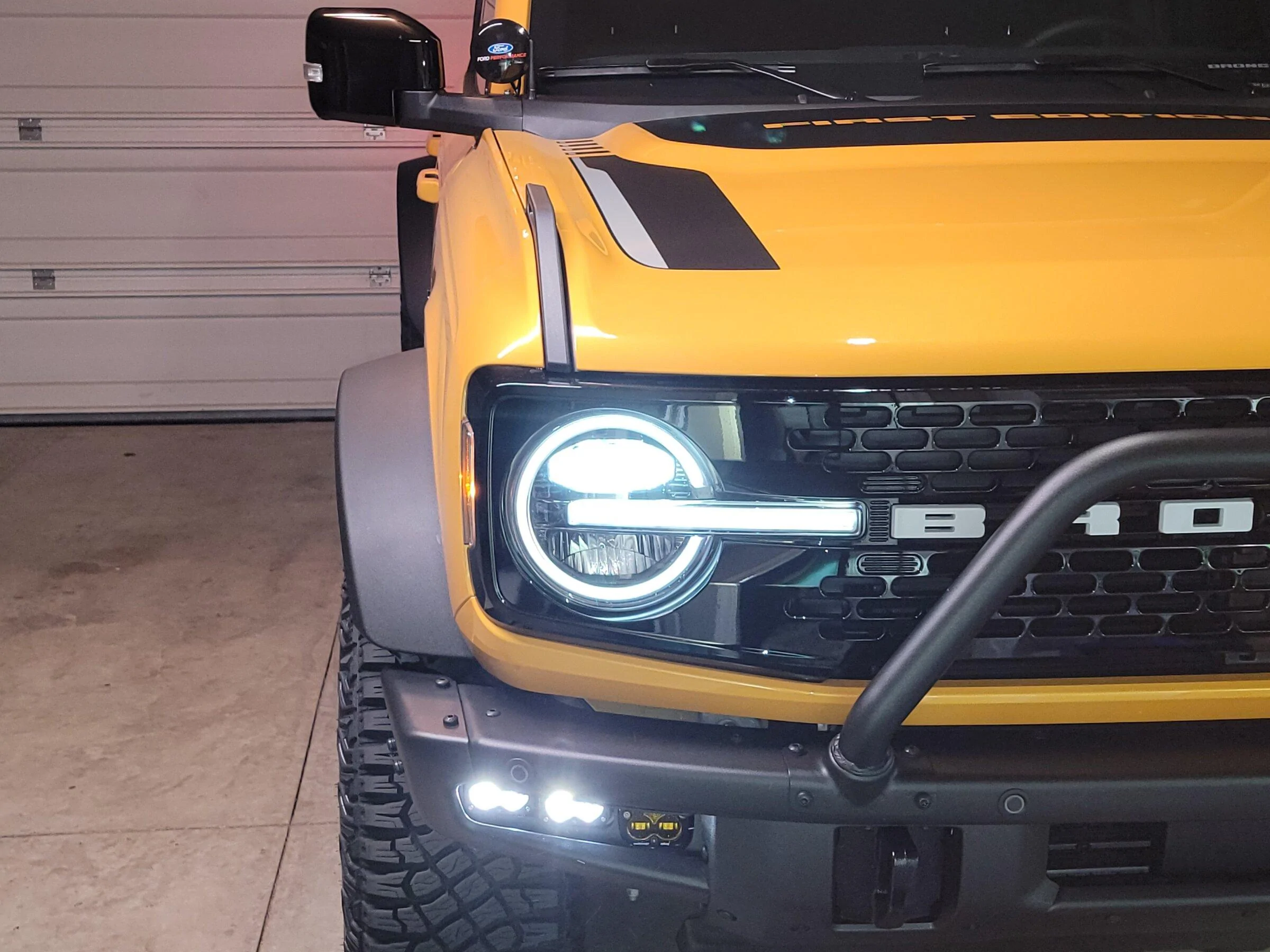

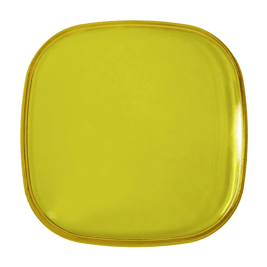

I believe Baja also recommends keeping amber below the hood/white above the hood since lower lights do a better job of cutting through the fog and don't blind you as much. Baja and maybe others also have amber (Baja is more yellow actually) rock guards which can be used with white lights to give you the option to switch white to yellow and back (and add protection for the lenses), though at the expense of you're probably losing a bit of light by running through two lenses.

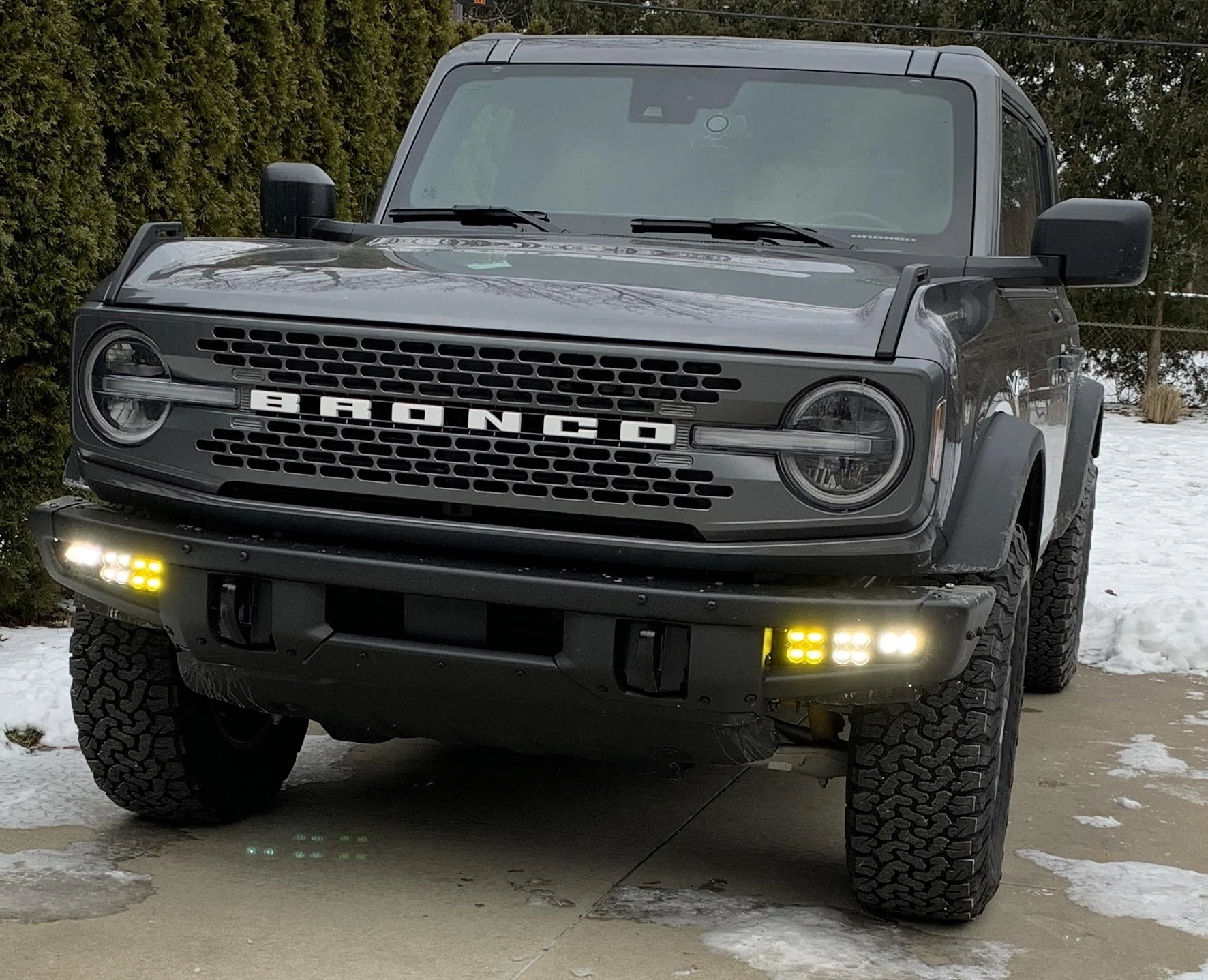

You can get 2-3 lights in the holes of the modular bumper. I got an amber and a white SAE along with an additional white trail light. In the end it depends on what you need the lights for. Some well designed pre-wired kits can be found here:
