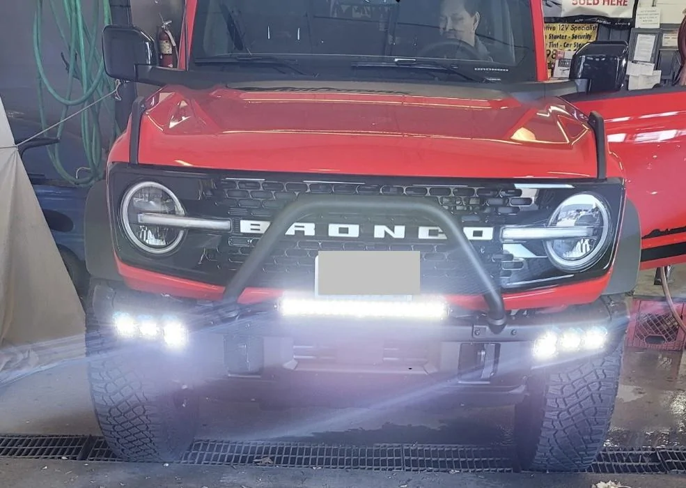

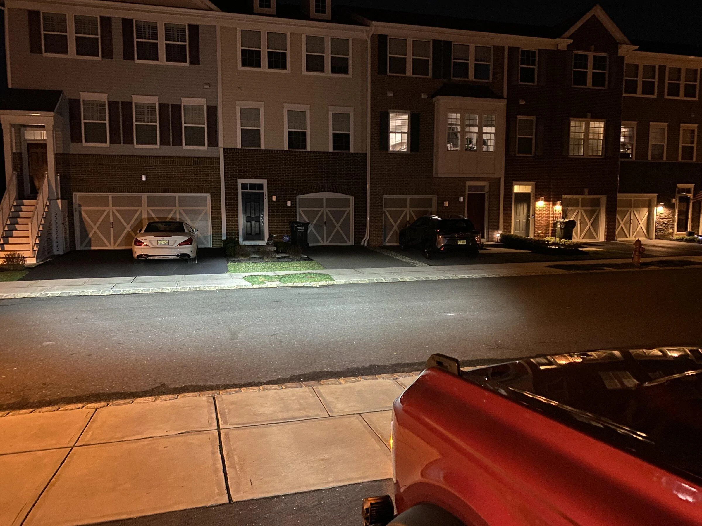

I went all clear… tbh, I went way too bright for ever using on road. At night, lights up everything clear as day though 🤷‍♂️
Ford Bronco Fog lights:  Amber or Clear? 877B9780-E62D-4767-B423-96A95073FB2A
Tdizzle
Tim
Jan 3, 2022
49
120
Boston
BMW X4M
Here’s a short vid of factory lights, plus factory high beams, then aftermarket fogs, then with mini bar in brush guard

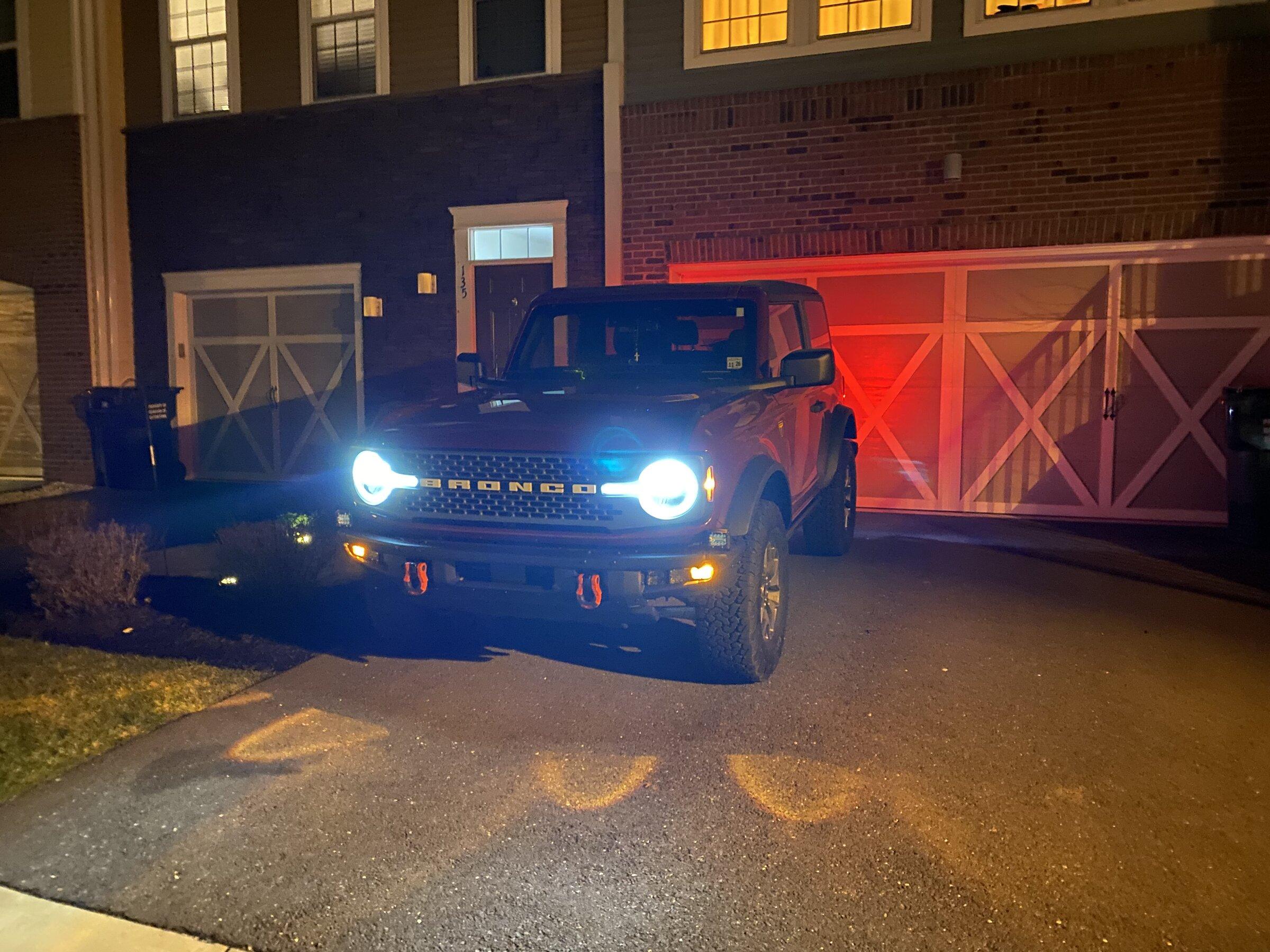

Learned the fun way tonight its not the best idea to wire the fogs all to one switch
Ford Bronco Fog lights:  Amber or Clear? C9D40FDA-2757-4A75-AE2B-E4CED24543B9
Ford Bronco Fog lights:  Amber or Clear? 595E2F76-3716-410B-8F2B-06E4BBC6E71D
Ford Bronco Fog lights:  Amber or Clear? 16B3468E-1BB3-48E1-8602-098257686DED
Ford Bronco Fog lights:  Amber or Clear? B6D96697-3788-43E7-973D-C8E7251844F6
Ford Bronco Fog lights:  Amber or Clear? F6134BD4-2003-4CB7-94B5-DF9348A1D062
Ford Bronco Fog lights:  Amber or Clear? 0AA3672B-EE43-41C7-9BFD-1837B0B5B288
Bright side, never gonna have to worry about deer ever again

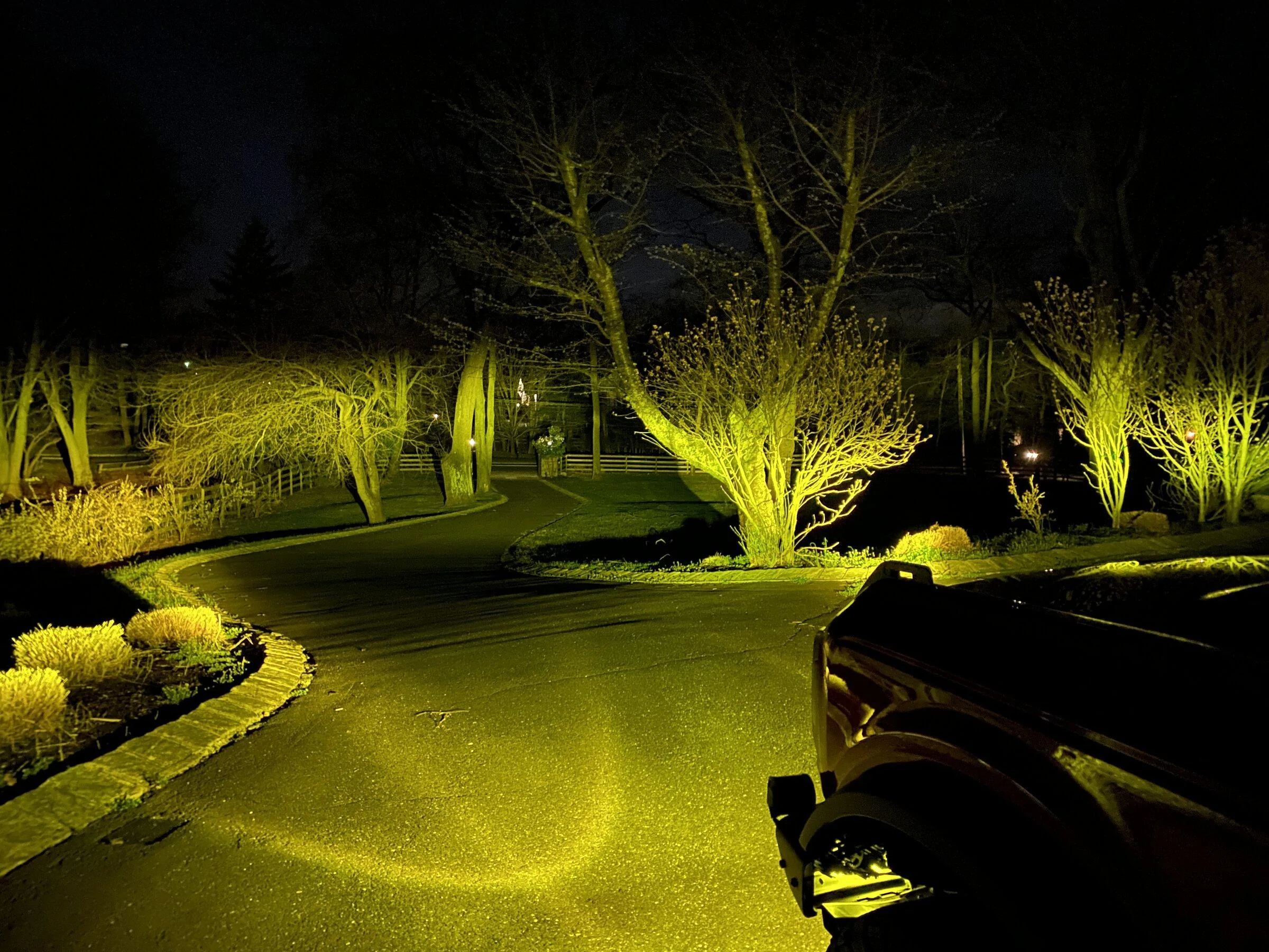

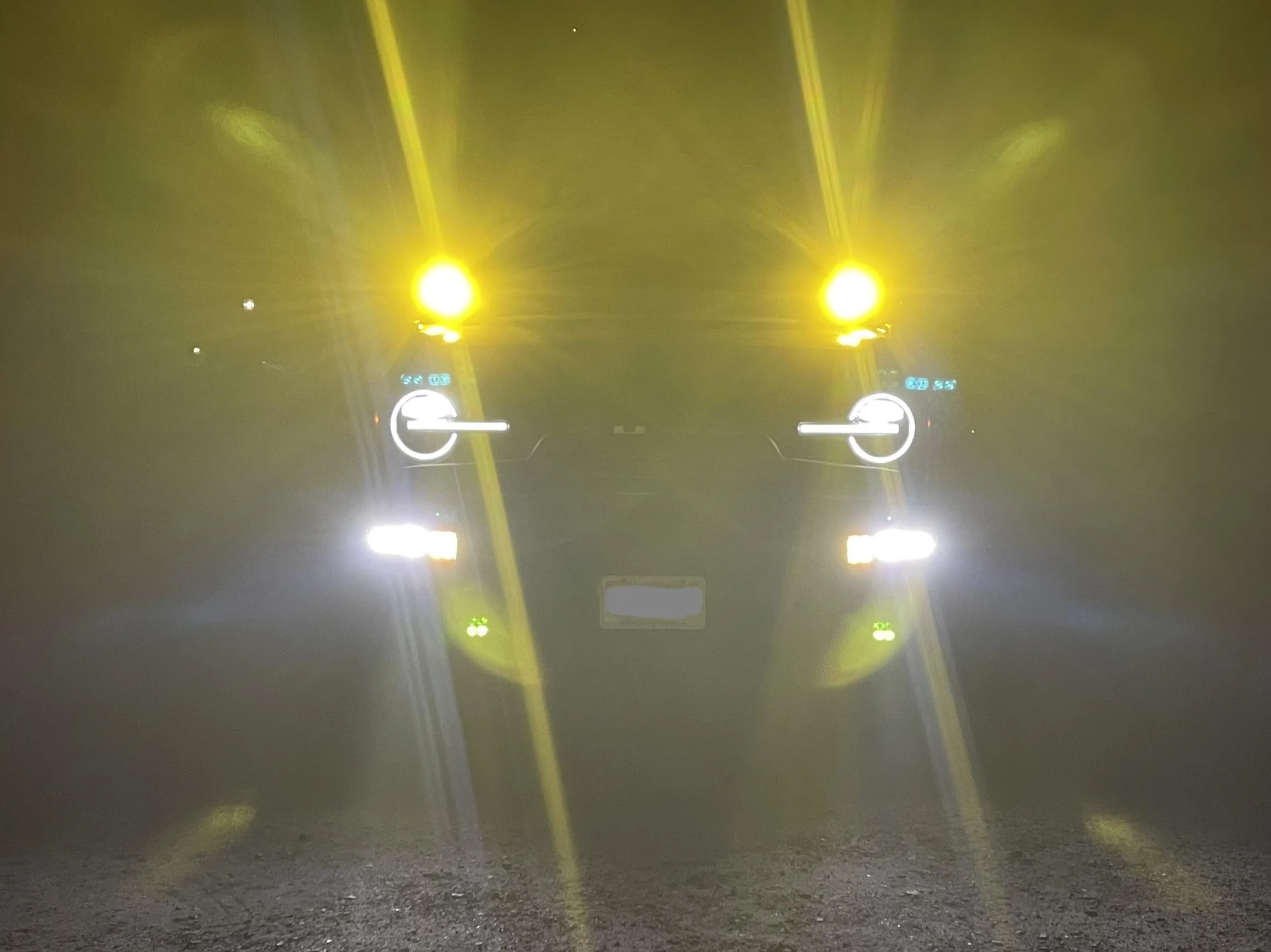

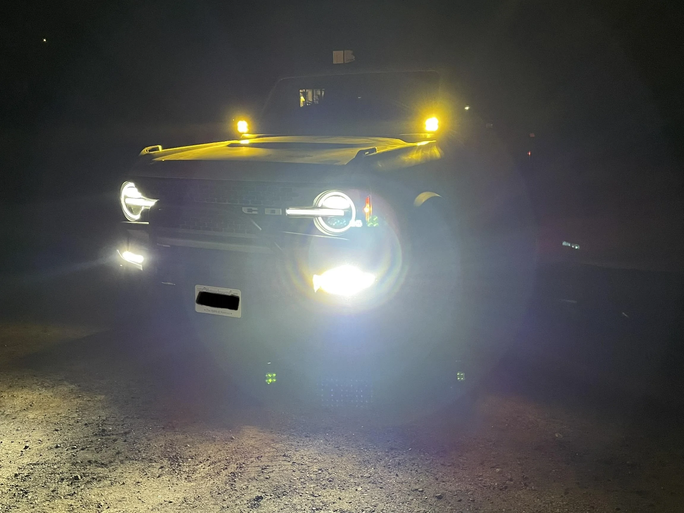

I got a chance to use all of my lighting on a trip to VT last month. I’m running Diode Dynamics because their SAE legal fog and driving lights are excellent.
4x4truckled’s mod bumper bracket
SS3 Pro amber SAE fog
SS2 Pro white flood with amber backlight
SS2 Pro white SAE driving with amber backlight
Pillar mount
SS3 Sport amber SAE driving
I don’t think my wife understood why I spent the money on good lights until this trip. We were running 50-100 miles on rural backroads after dark most days, I’d hit the lights and be able to see everything down the road, she was very impressed. We’ve had the SS3 Pro amber fogs on her Tacoma for a couple years, they work great and light up the sides of the road nicely. The most impressive lights here are the SS2 Pro driving, they are brighter than the factory headlights and reach farther down the road. The SS3 Sport amber also work great, the sport seems to be enough with the more confined driving beam. The amber has less glare on the hood that I would expect from the white. I have everything wired to individual upfitter switches, I run the amber fogs 100% of the time then toggle the others as needed. I have found the SS2 floods to be of little use to me. They light up the tops of the trees and would probably be good for slow speed wheeling at night. I ordered a set of white fog lenses for them as I think I’ll get more use from that lens and the white fogs might be better for normal night driving than amber. At some point I’d like to figure out a safe way to trigger the SS2 white driving off the auto high beam circuit, that would allow me to drive in traffic without having to reach up and hit the switch for every car. A floor mounted dimmer or small push button switch on the console with a relay controlling the light’s ground is also a possibility. One more comment, the mod bumper wiring harness from @4x4TruckLEDs.com was perfect for my setup. I made my own harness for the pillar lights.
If I were buying everything again I’d do the SS3 Pro white SAE driving, SS2 Pro fogs in white and amber, and keep the SS3 Sport amber driving on the pillars.
