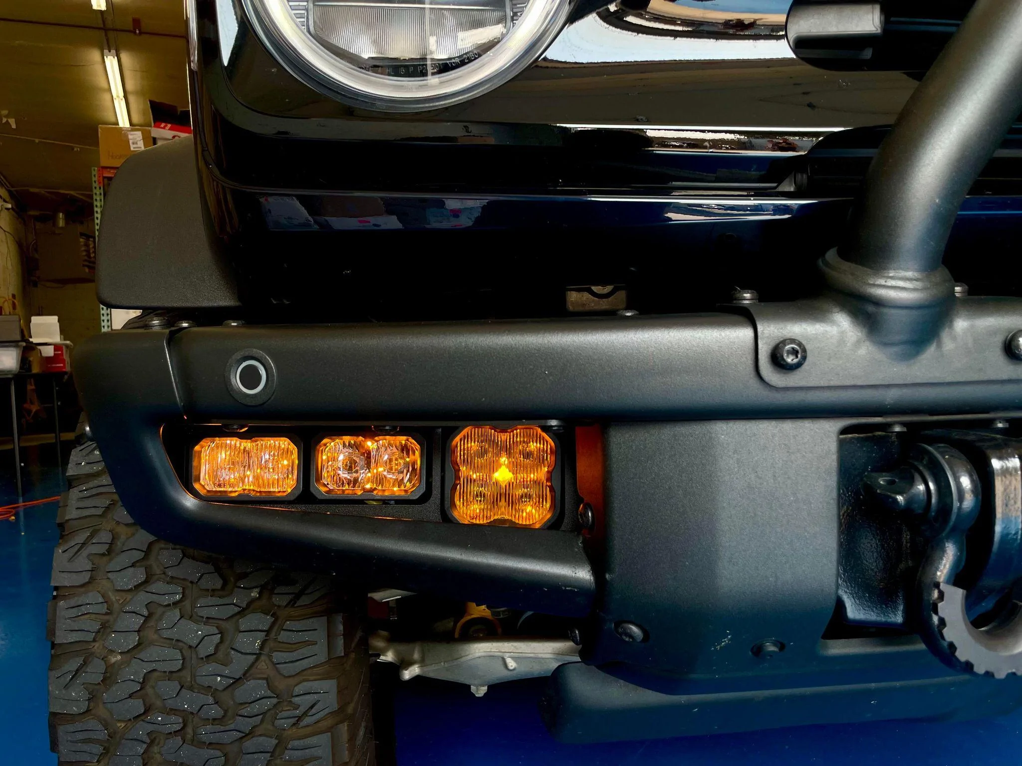

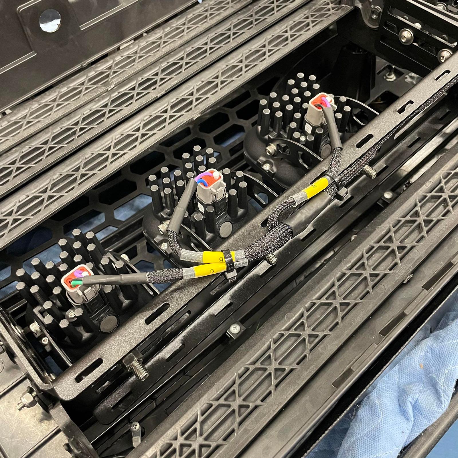

What's nice about our harness is it plugs directly into the light. Our harness is made for the light you get, so there is no need to plug our harness into an adapter and then into the light. It plugs DIRECTLY into the back of the light. Here is a photo as an example of the harness you'd get from us where it plugs DIRECTLY into the light. In this example we have 3 Diode Dynamics lights connected together. See how it's nice and clean, no additional wires hanging off
Ford Bronco Amber vs Clear Aftermarket Lights Truck8

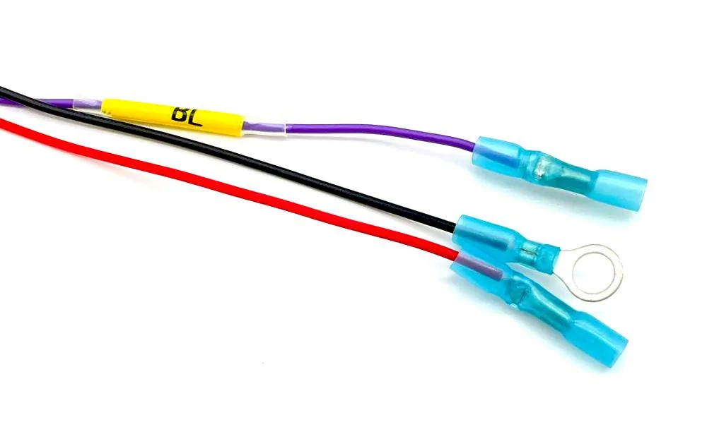

Then at the other end we have weatherproof, heat shrinkable connectors. Simply strip back some wire on the upfitter, insert it into the connector and crimp down. You can then use a heat gun or a lighter to shrink the connector which encapsulates the wire so water cannot get to it.
Ford Bronco Amber vs Clear Aftermarket Lights A-Pillar End (3 Wire)
Ground gets bolted to an existing bolt by the upfitters for the ground.
Red wire gets crimped to an upfitter for main power
The purple (BL) wire is the backlight, that gets crimped to another upfitter for the back-light control.

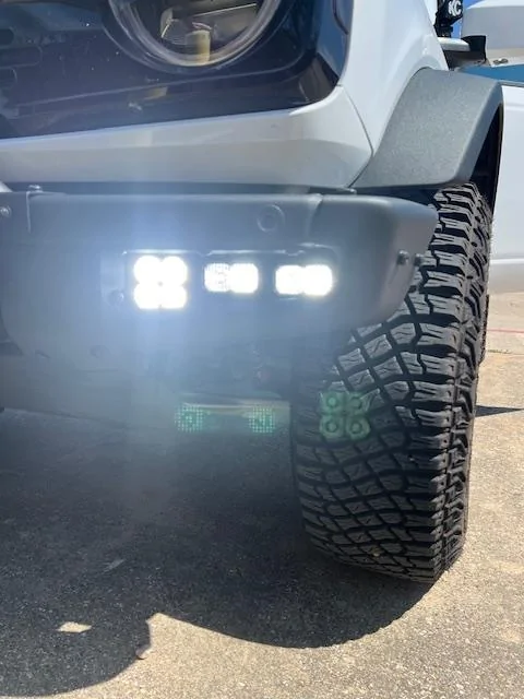

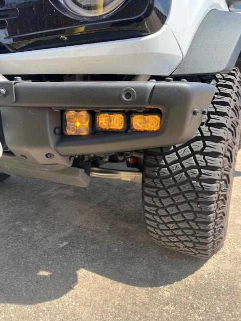

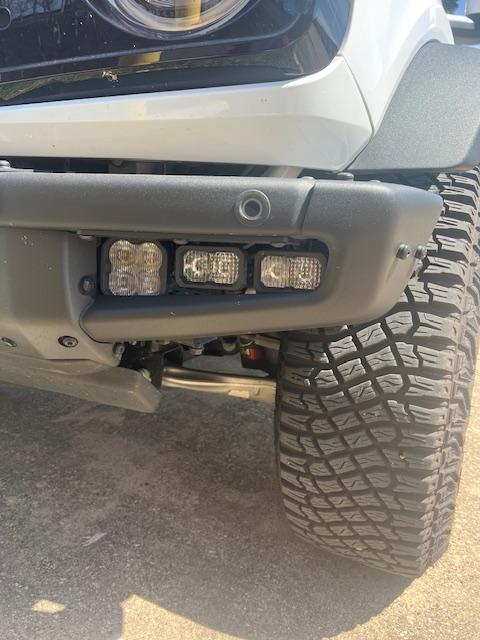

Silly question, but how to the back lights work? The post by ajnotoj shows all the lights off, then backlights on and finally full power lights on. I see the there is a pigtail specifically for the backlight for the stock wire harness connections. Will the backlights also work with the aux uplifter switches from the factory?

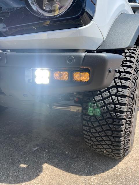

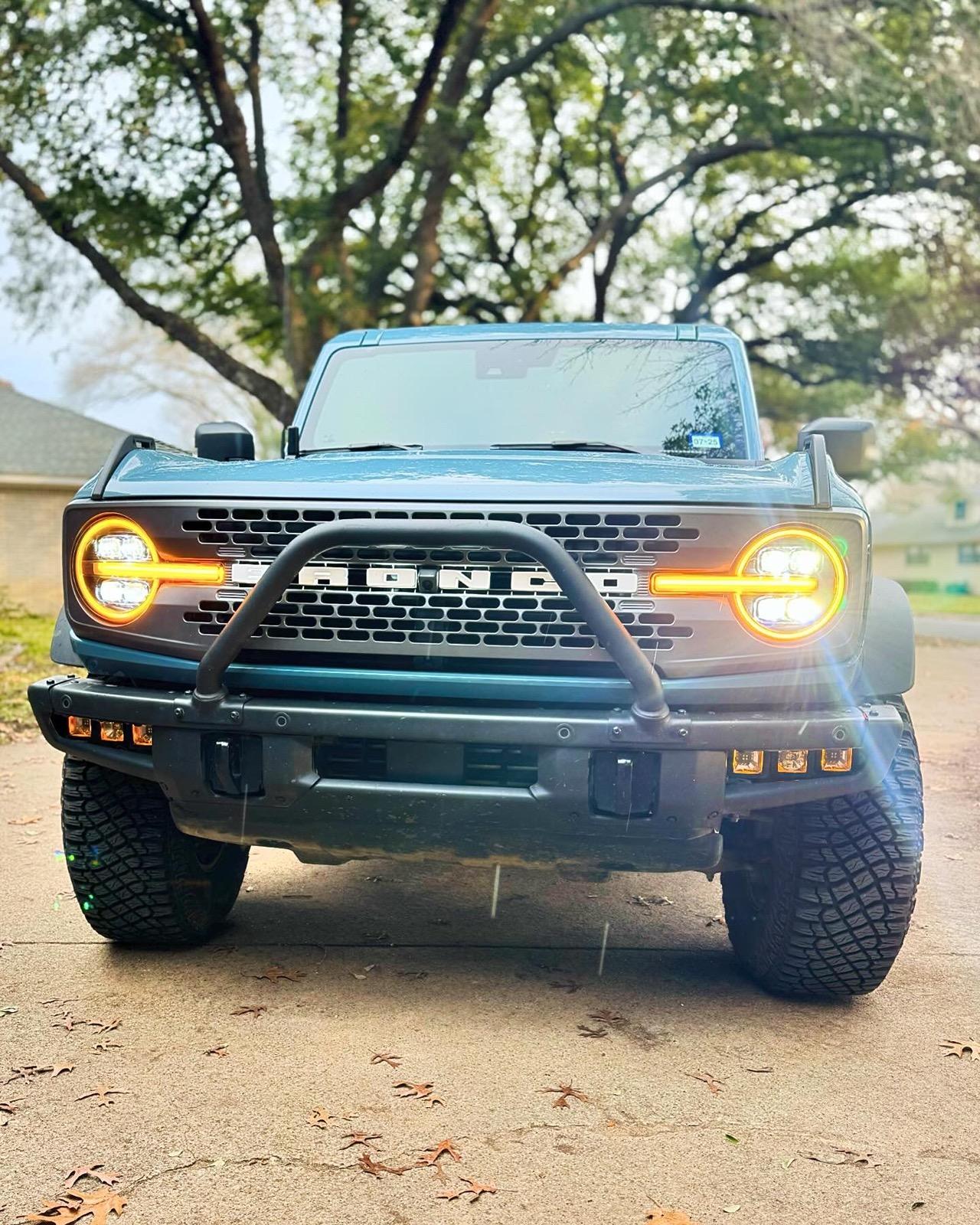

@Bronco_MI I have the amber backlights for all six pods wired to AUX 2, the two SS3 street legal pods to AUX 3, and the four offroad SSC2 pods to AUX 4 (and similar backlight/lamp setup in AUX 5 and 6 for ditch lights). To get the picture from above with the the SS3s and amber backlight, I flip AUX 2 and AUX 3. Small detail, but got these from @StickerFab for organization and they just look cool.
I don't understand these multi light fog kits. As far as I am aware, many states allow only one pair of lights to be active at any time, and most (perhaps all) states do not allow more than two. I see so many pics of Broncos with three lights on at the same time, including in this thread. Sure, you can hope that the cops have nothing better to do than ticket you, but what's the point?
@GroovyGeek so the first picture with amber backlight does not really emit much light, it's just for aesthetics. The second picture with only the single SAE SS3 pod showing is street legal. The last picture with all of them running is strictly for off-roading.

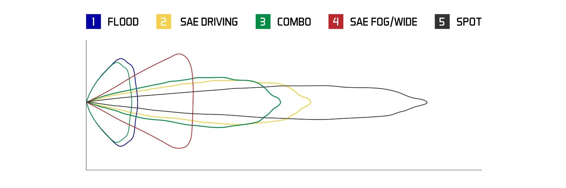

Diode Dynamics makes a variety of lenses for this SS3:
Ford Bronco Amber vs Clear Aftermarket Lights Stage_Series_C2_LED_Pod_Beam_Patterns_-_Description
You are correct that you can only have two additional foglamps to supplement your headlights in California (and probably most states). These SAE Driving SS3 pods meet the SAE J583 standard that California (and probably most states) follows. These are super helpful driving at night, I personally don't think the stock headlights are strong enough. The rest of the lights are only for off-road use, and people can (and should) get ticketed for blinding people with those on the street.
