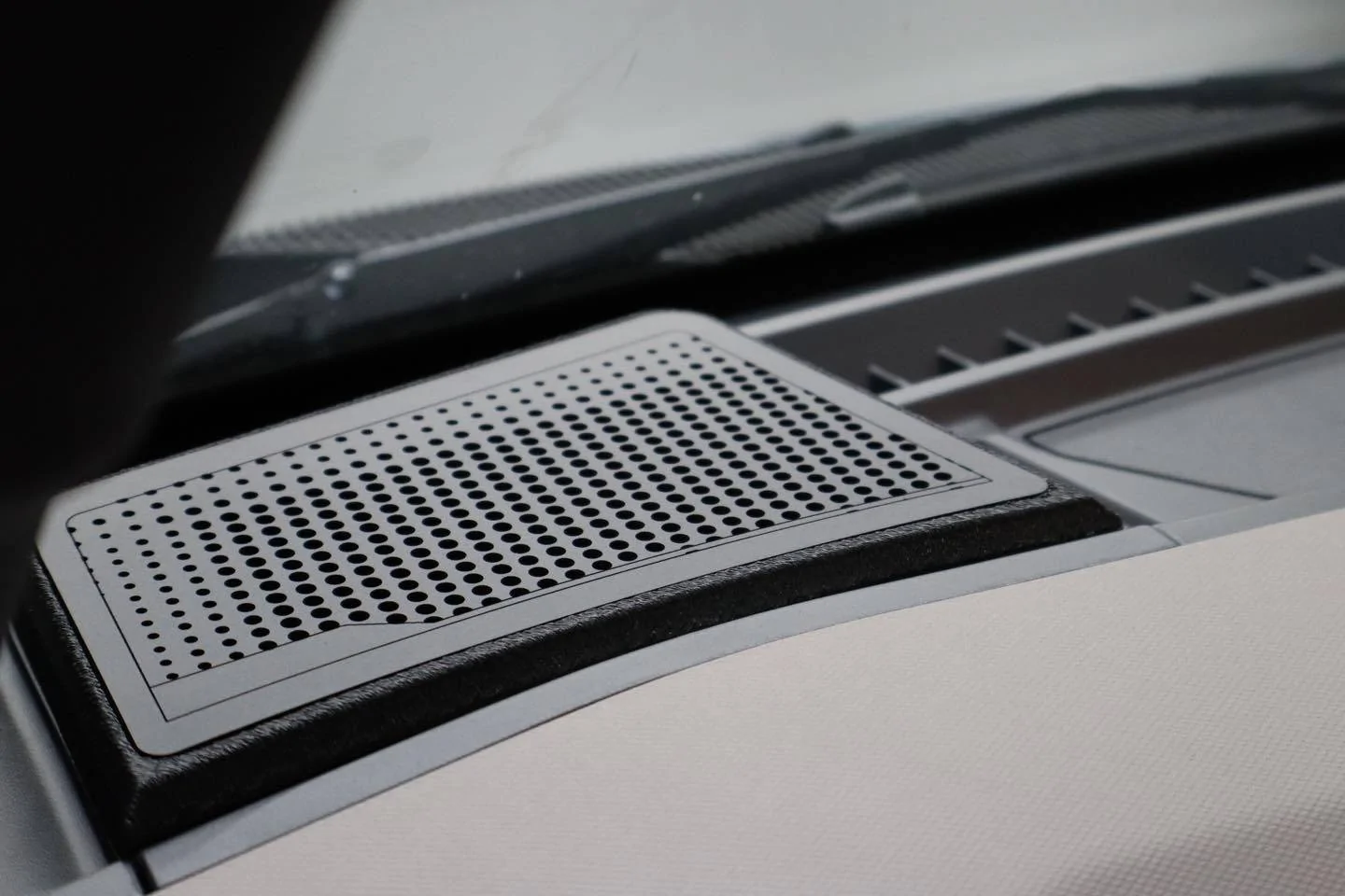

I saw the image below when searching for in-dash component speakers for Broncos and looking at how people modified the OEM mounting and covers to fit them. This is from Sound Source Inc. in Idaho - I asked them for the part number(s), because I'd be interested in moving in that direction, and they said it was Bronco3wKME.
Does anybody know more information on this kind of a setup?

The post was here if its anyone on here's Bronco:

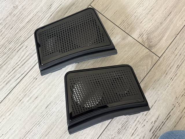

If anyone wants a set of Focal Flax EVO 3-way components with the MTI dash plates, I have a set available in the original box, plus the dash plates for $750. I upgraded to Focal Utopia.
