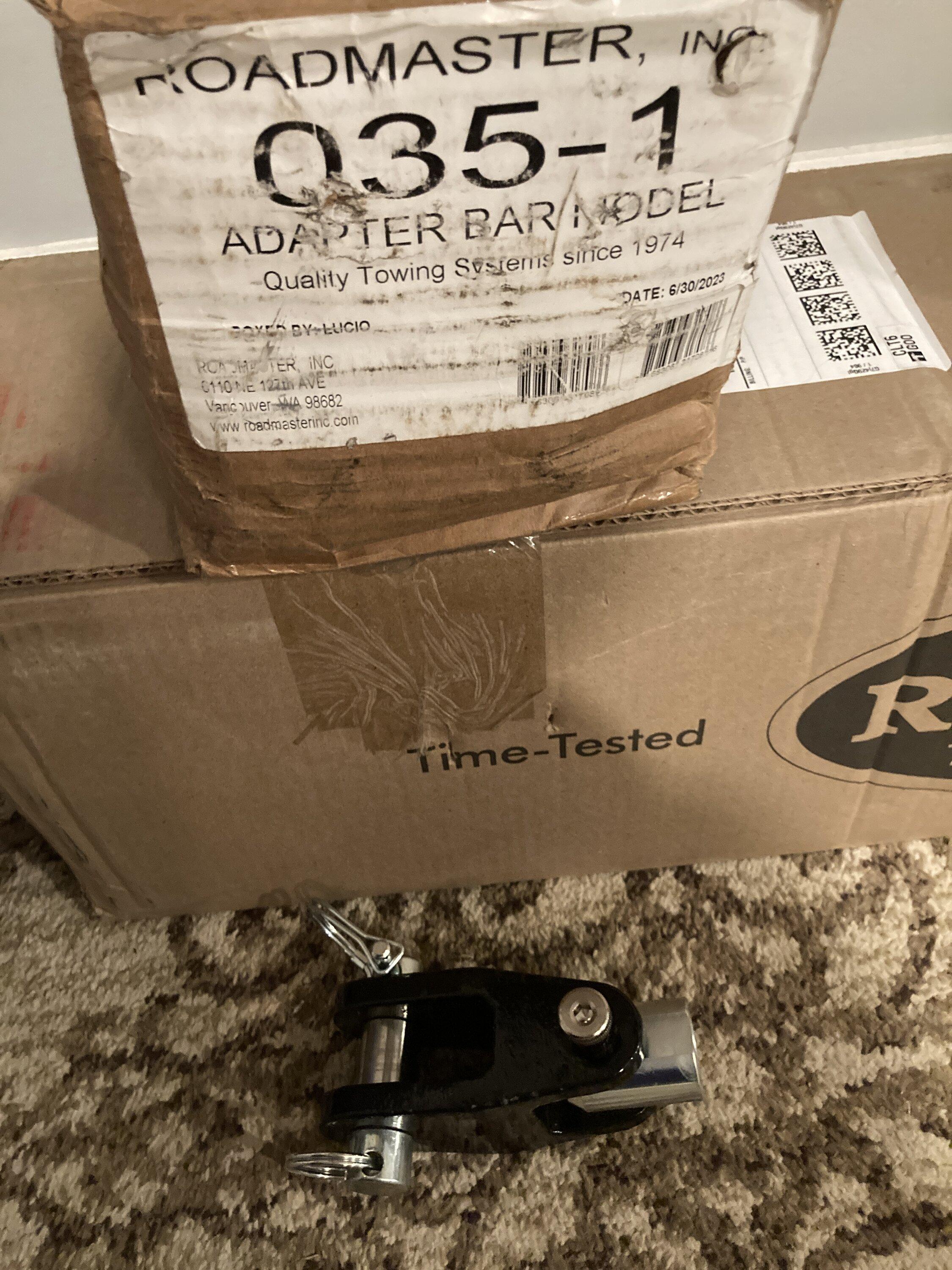

we bought the Curt adapters from Amazon as well as the Curt wiring kit. Etrailer is also a good resource
https://elitetruck.com/products/701...MIqI715_yTgwMVhYGGCh2ruAZAEAQYAyABEgLaWvD_BwE

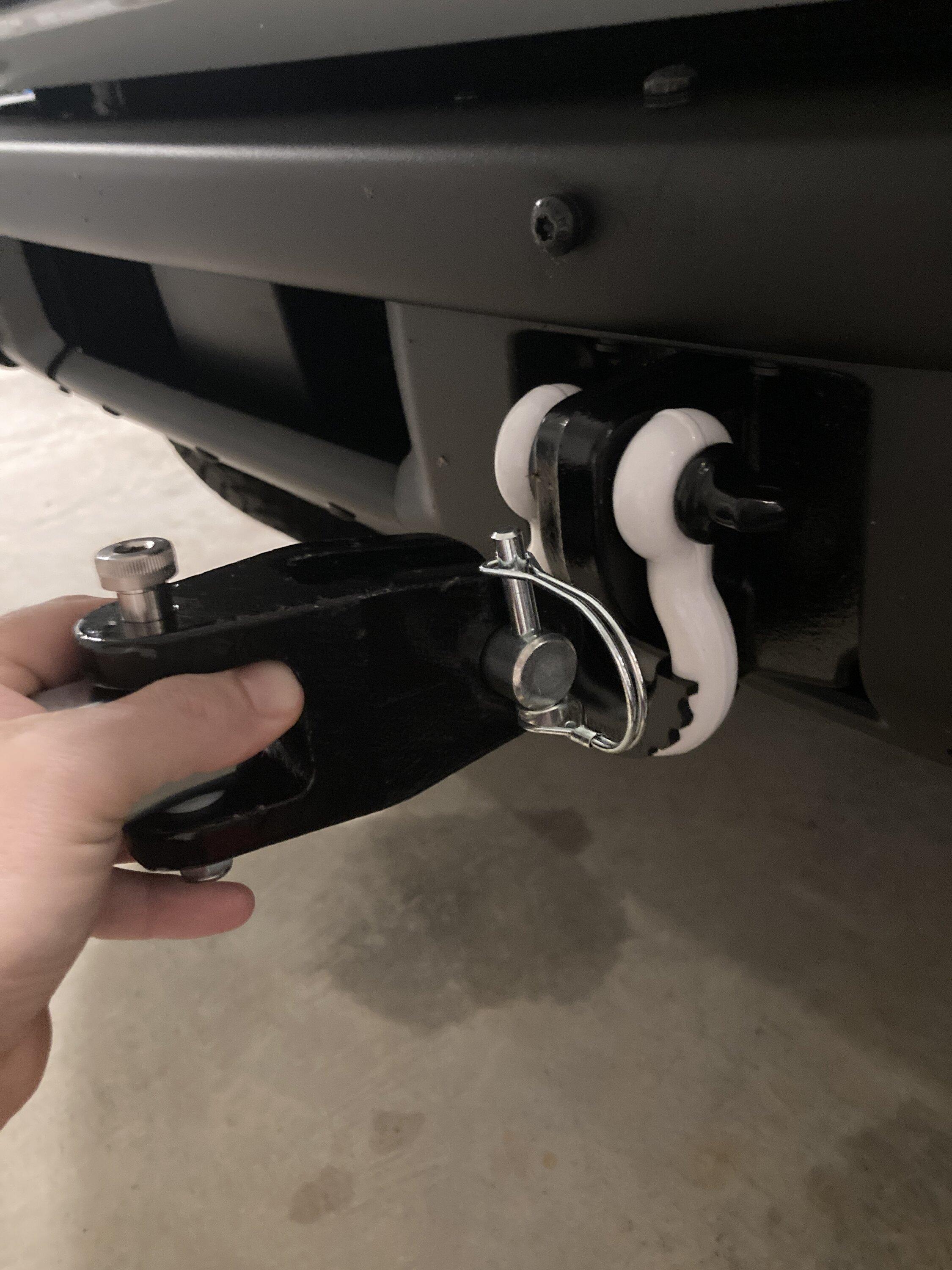

The tie in brackets are pretty important. Some conflicting info out there on whether or not you can flat tow off of the factory recovery points. It was strictly a visual for me. I think blue ox, road master, etc base plates and brackets look hideous
https://lodoffroad.com/assets/pdfs/BFT2100 Bronco 2021 Front Bumper Frame Tie Brackets.pdf
I wanted to use the demco air brake system but didn’t want to cut into the vacuum lines, so we use the blue ox patriot 3 brake system.
I wired in a constant 12volt power outlet that is under the drivers seat and out of sight as well as a constant power to the battery from the 7 to 6 wiring from Rv to bronco. Mounted the 6wire plug into the skid plate it too is out of sight. You have to squat to look under the vehicle to see it.
I just find many of the required pieces to tow your vehicle unsightly and took a little extra effort to camouflage them
