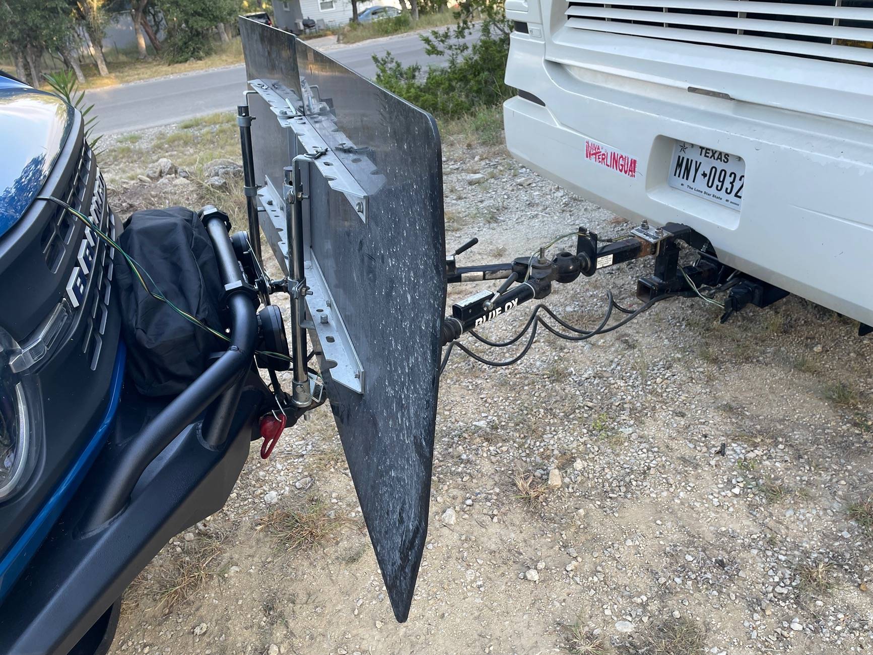

It depends on what bumper you have. You may just need adapters to pin to your recovery hooks. Or change your current recovery hooks to the style most aftermarket have. Or buy base plates, but they are pricey.
There are multiple threads on this forum that discuss options.
I simply bought adapters to adapt my Blue Ox tow bar to my aftermarket bumper. I think they were $60

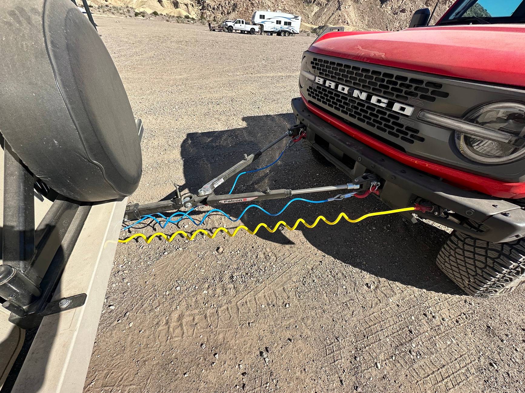

You don't need a Baseplate if you have the modular bumper. Mine is a Badlands. I use a Roadmaster Falcon 2 tow bar and the Demco Stay 'N Play Duo auxiliary brakes. Depending on the receiver height on the motorhome and the level of the front hookups on the Bronco, get the riser to get the tow bar level as possible.
