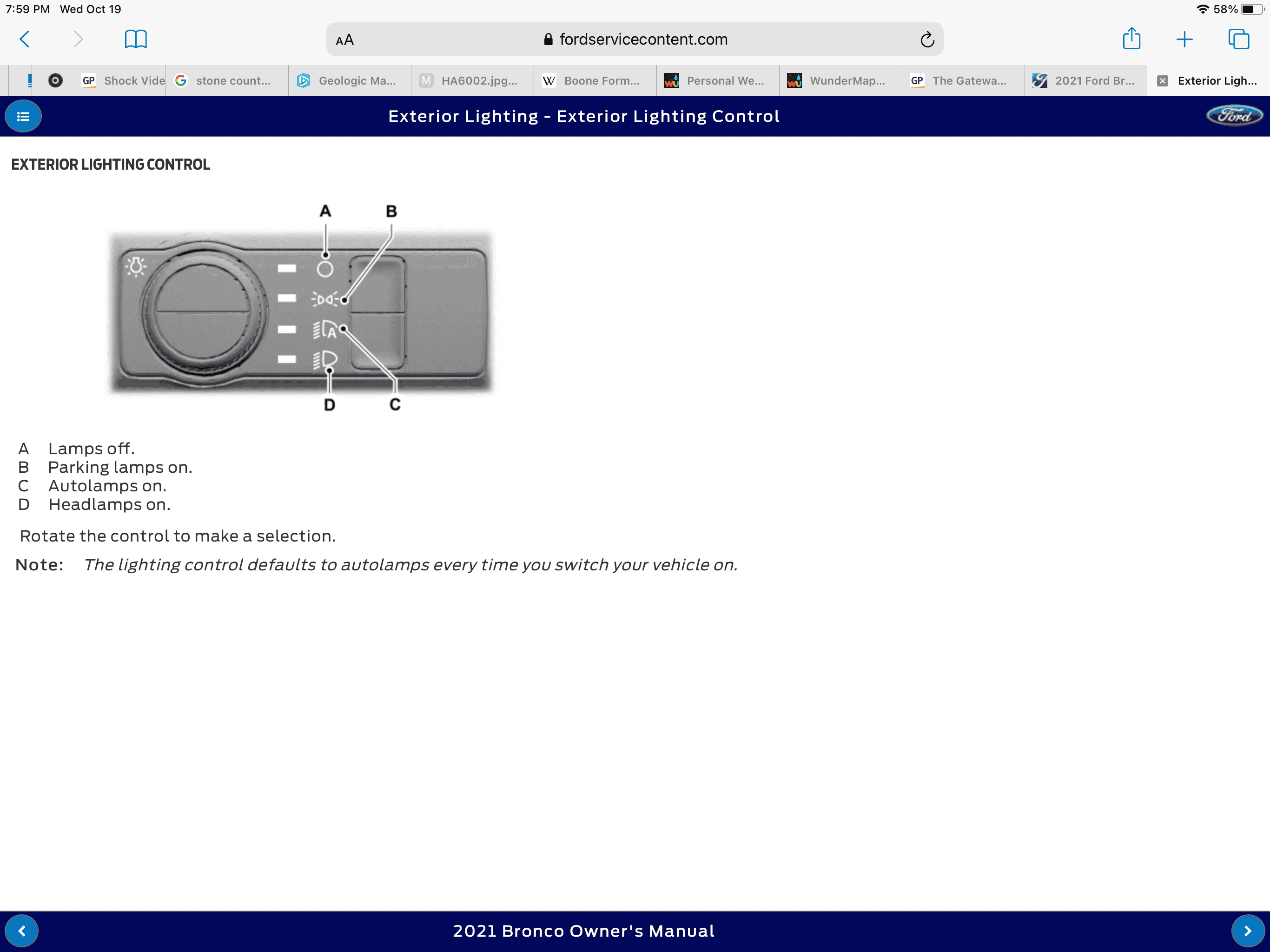

Ford Bronco FIXED: Headlights turning on when switched off 0E1F0024-C011-442E-9FF5-C0A7DFBD25DC
this is from the owners manual online
