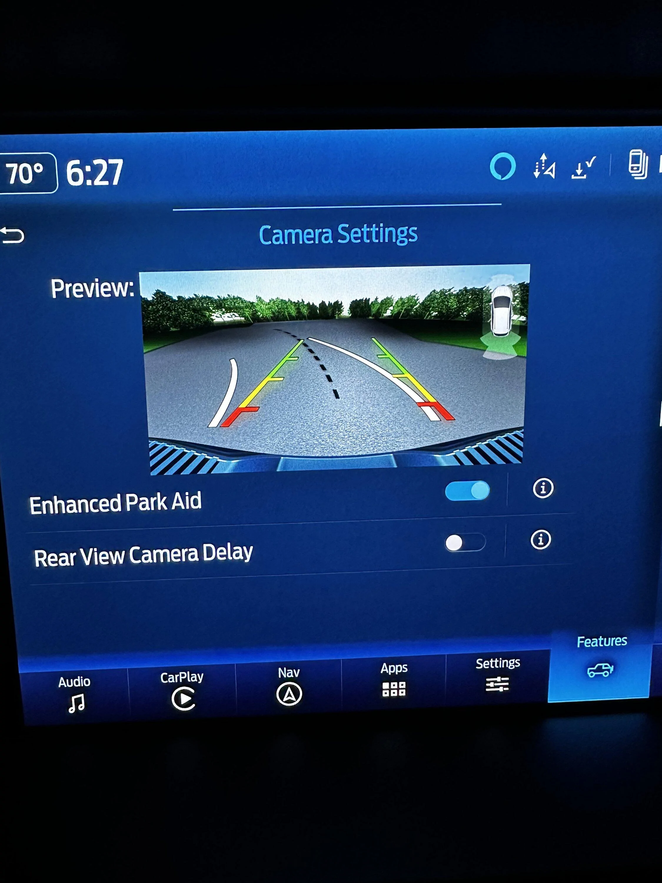

FEATURES > DRIVER ASSISTANCE > REAR VIEW CAMERA > REAR VIEW CAMERA DELAY (Turn Off)
Ah, thanks. Didn’t think to look there. Mine was in fact off…so, that’s not it.

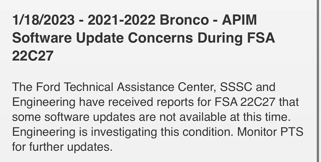

Yeah, hence my post above bringing it up again. They took care of the recall - and it's still happening.
Ford is having issues with the latest updates currently. They still haven’t resolved it yet

Ugh. What a waste of time. My preferred dealer is like 40 min away and they had to keep it overnight. Guess I’ll just wait this out until they sort out the airbag sensor recall too.
Obviously not detrimental - just funny the recall is “cleared”.
