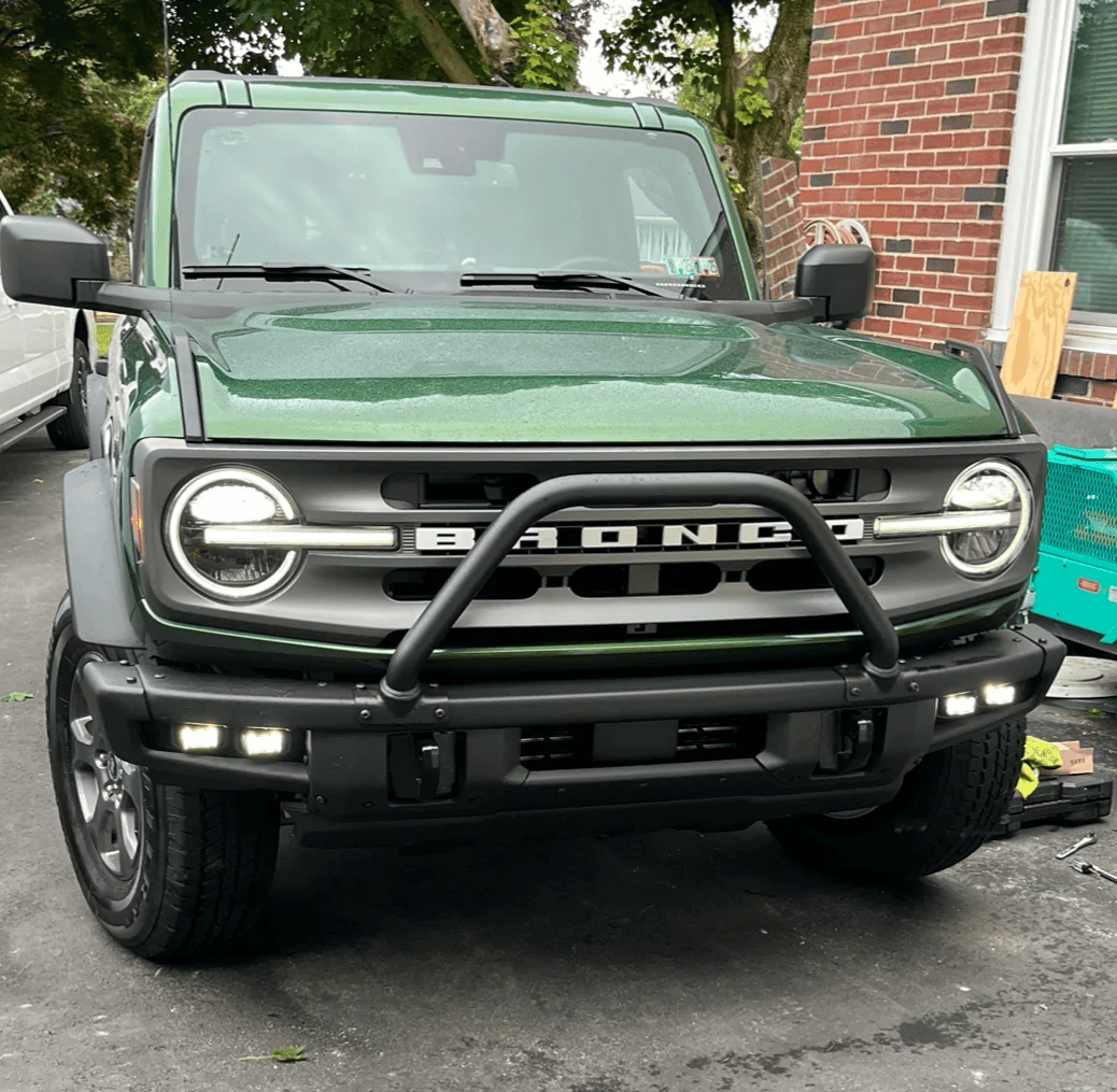

i can verify the wires are the same!! success took me about 3 hours the hardest part was the torx screw that screwed into the bumper after the lights were installed
Did you cut and spice into the two wires? Been putting this off myself as well. Badlands modular bumper no front sensors
Yes I bit the bullet and I cut the wires about 3 inches shy of the harness. I soldered male crimp connectors to each one because I wasn’t sure which was right and which was left. I bought about 50 ft of wire that had both red and black in it that was weather proof. It was a pretty simple mod. I ran a ground back into the engine compartment I didn’t want to ground the lights anywhere close to the bumper.
