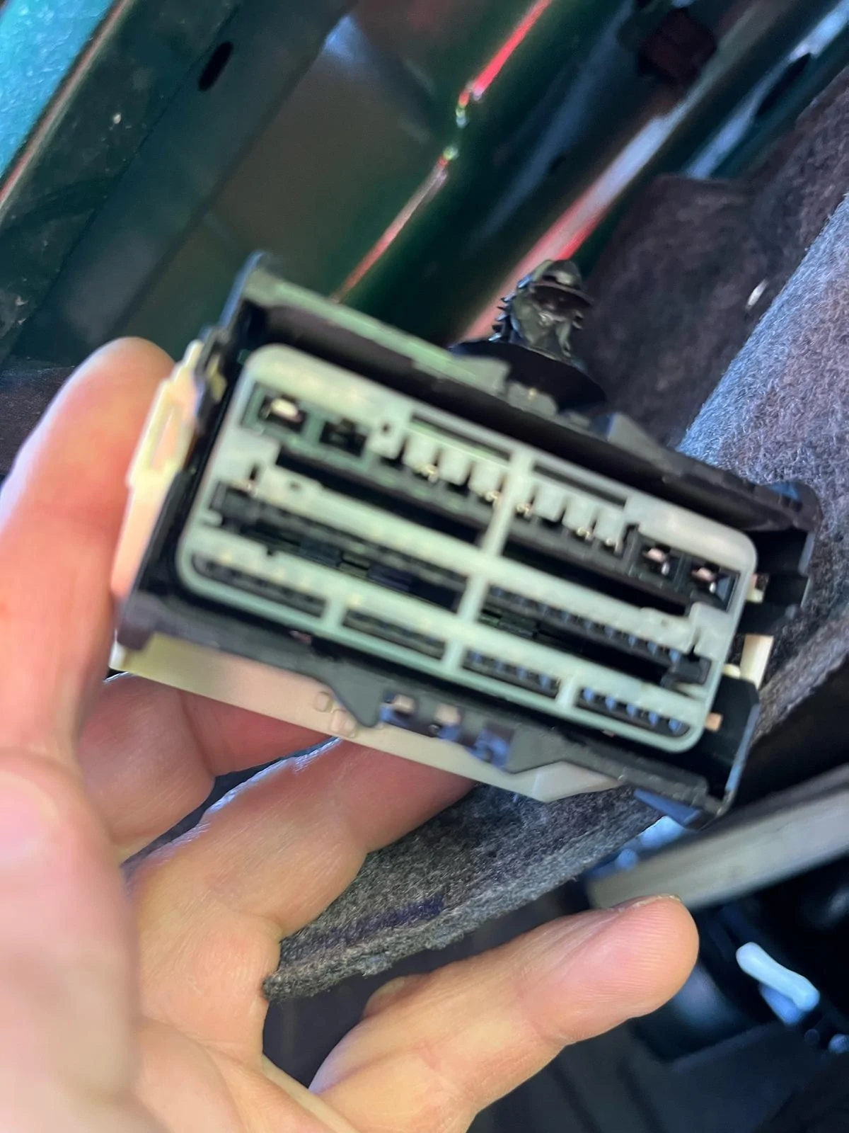

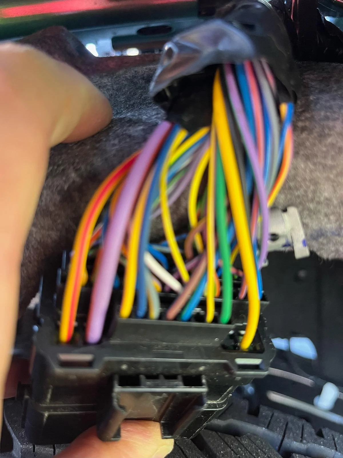

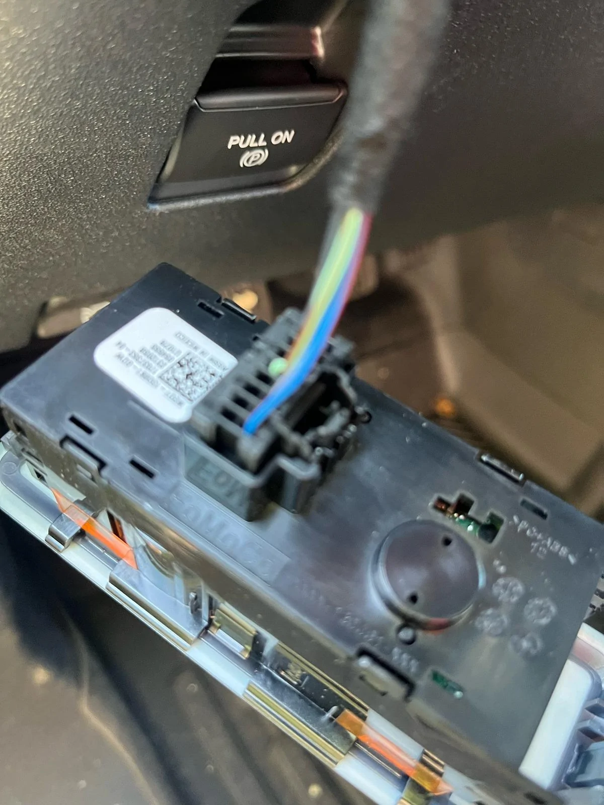

These may help someone. The documentation says the wire is brown but it’s grey with brown stripe, position 43. That’s for the left fog. The right fog light is yellow with orange stripe, position 48. Both are 16 gauge wires.
just pulled this out on mine and my wires are completely different in color...
also i pulled the switch to see what wires are there it doesnt look like a whole lot
The good news about the switch is that all the wiring harnesses seem to be the same. There’s only like five wires going to the dashboard switch regardless of whether you have fog lights, side lights, etc.

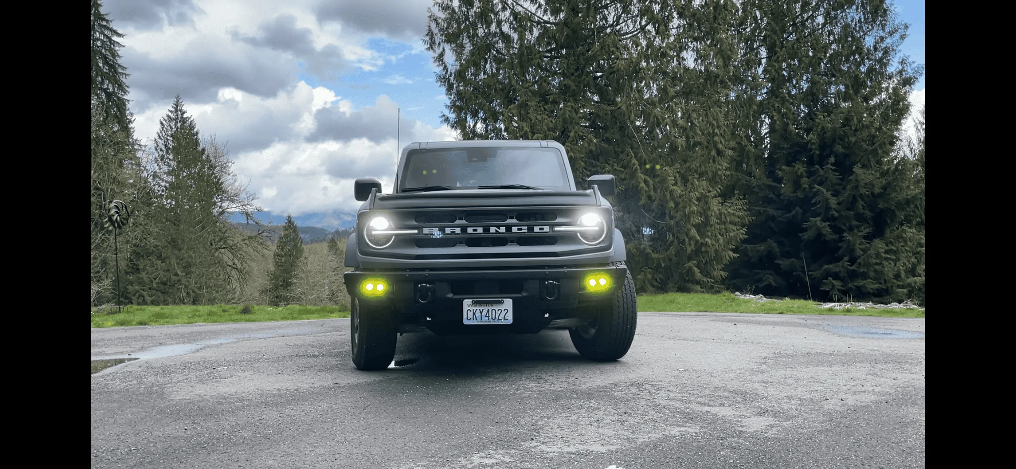

i can verify the wires are the same!! success took me about 3 hours the hardest part was the torx screw that screwed into the bumper after the lights were installed
