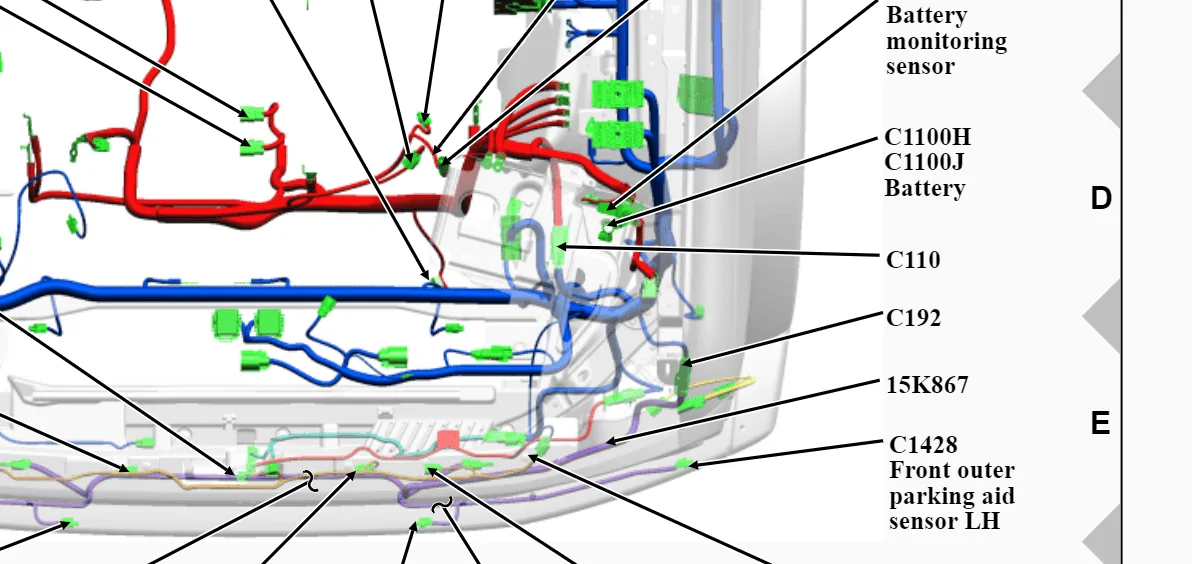

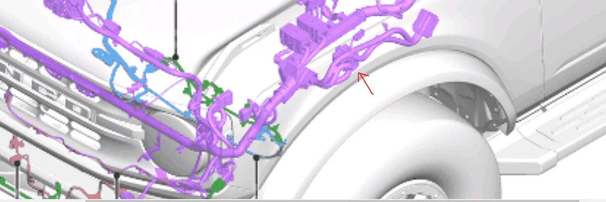

@flip - can we have the part number for the wiring in the modular bumper? Assuming that’s an available part?
Anyone with a VIN (modular bumper with sensors) they can share?
Assuming it’s two parts. Wiring from C203 to C192 and then from C192 to bumper. That’s what you’re missing if you have the modular bumper w/o sensors.

There are a few options dependent on build date. Not sure what the difference is but here are a few.
H - W/MODULAR, W/O WIDEBODY, w/frt park aid (replaces F)
L - W/O Modular, W/STEEL. Distance SE. System Wiring. (Replaces AA) - CAPABLE?
M - Without modular, with steel, without frt park aid (replaces BA) - CAPABLE?
So, I’m guessing H is the winner for those of us with Modular Bumper, Standard Package.
What about the wiring one step up? From C192 to C203? It’s gotta be a short run from fender under the headlight.

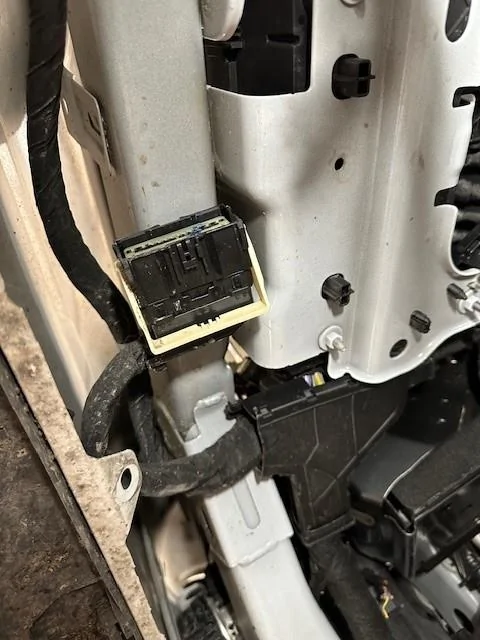

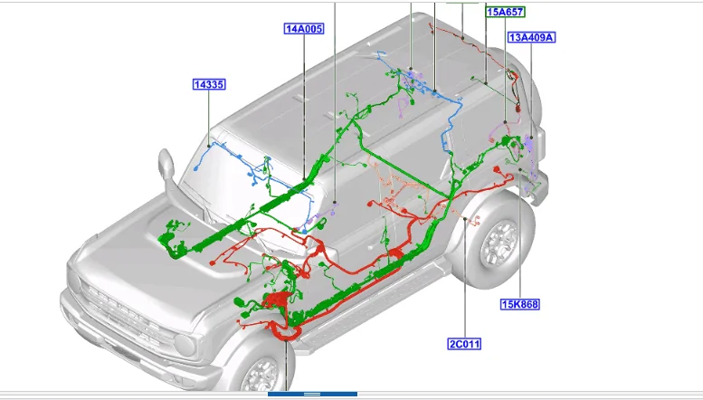

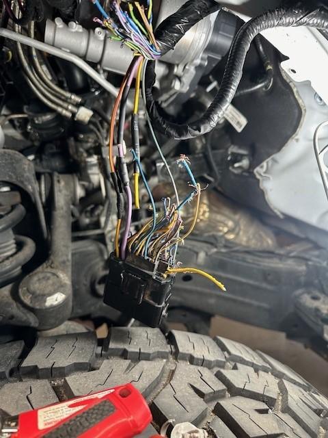

C203 is part of the whole 14290 harness. Which is immediately relevant to one that's on the lift right now that a demon worked on.
Ford Bronco Factory Fog Light Switch 1702646140429
Ford Bronco Factory Fog Light Switch 1702646307934
No nest, no evidence of food or nuts being stored. Going to repair because the other option is getting the green harness in the last pic and completely gutting the interior.
Ford Bronco Factory Fog Light Switch c203
Ford Bronco Factory Fog Light Switch C203 damage
Ford Bronco Factory Fog Light Switch 1702646630833

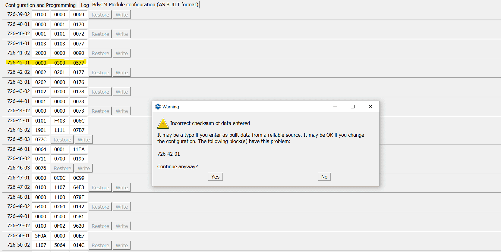

I'm in a similar situation but when I tried to change from 0101 to 0303 I got an error for the auto checksum. Sorry if this is a basic Forscan question but am I doing something wrong or just continue?
Did you get this figured out? I received the same message yesterday. I went on and wrote the changes and received a error that the changes were not made but after checking the changes were made and my fog lights work off the factory switch. Just not sure if something is messed up.

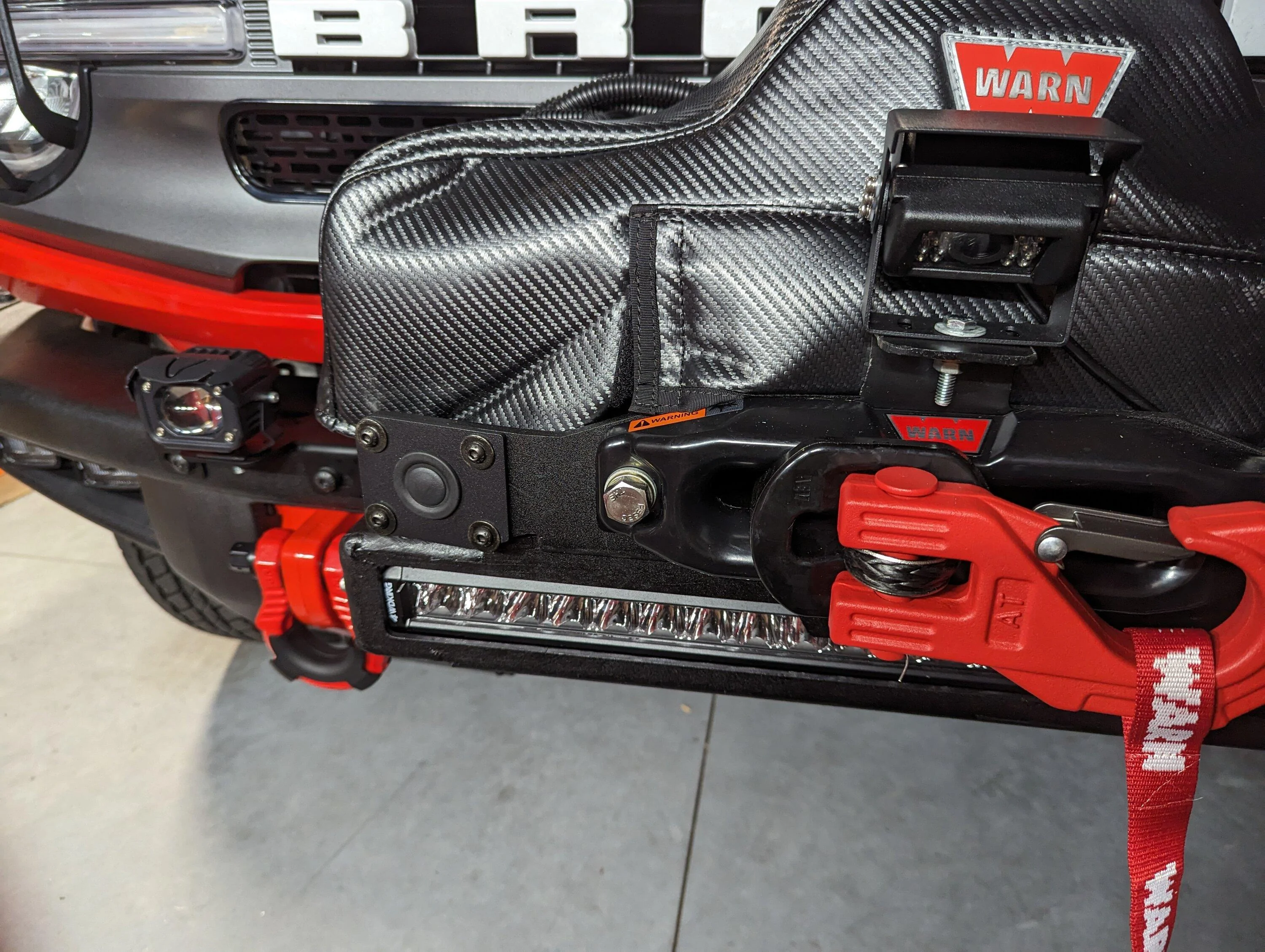

When I replaced my standard plastic bumper (with fogs) to a modular bumper I added after market fogs and used the original wiring harness to connect them to the stock fog switch. I have a 23 Big Bend mid package and I didn't realize until this past weekend that I had auto-sensing bright lights. So as I'm driving down the country lane with brights on, when another car approaches they brights turn off and the fogs come back on (I had previously turned on the fogs and then switched the brights on). You can see the passenger side in the attached picture. I also added the RC high winch mount with a Warn EVO 10S. In addition, I installed the TD Distributions frame horn strengthening kit.
