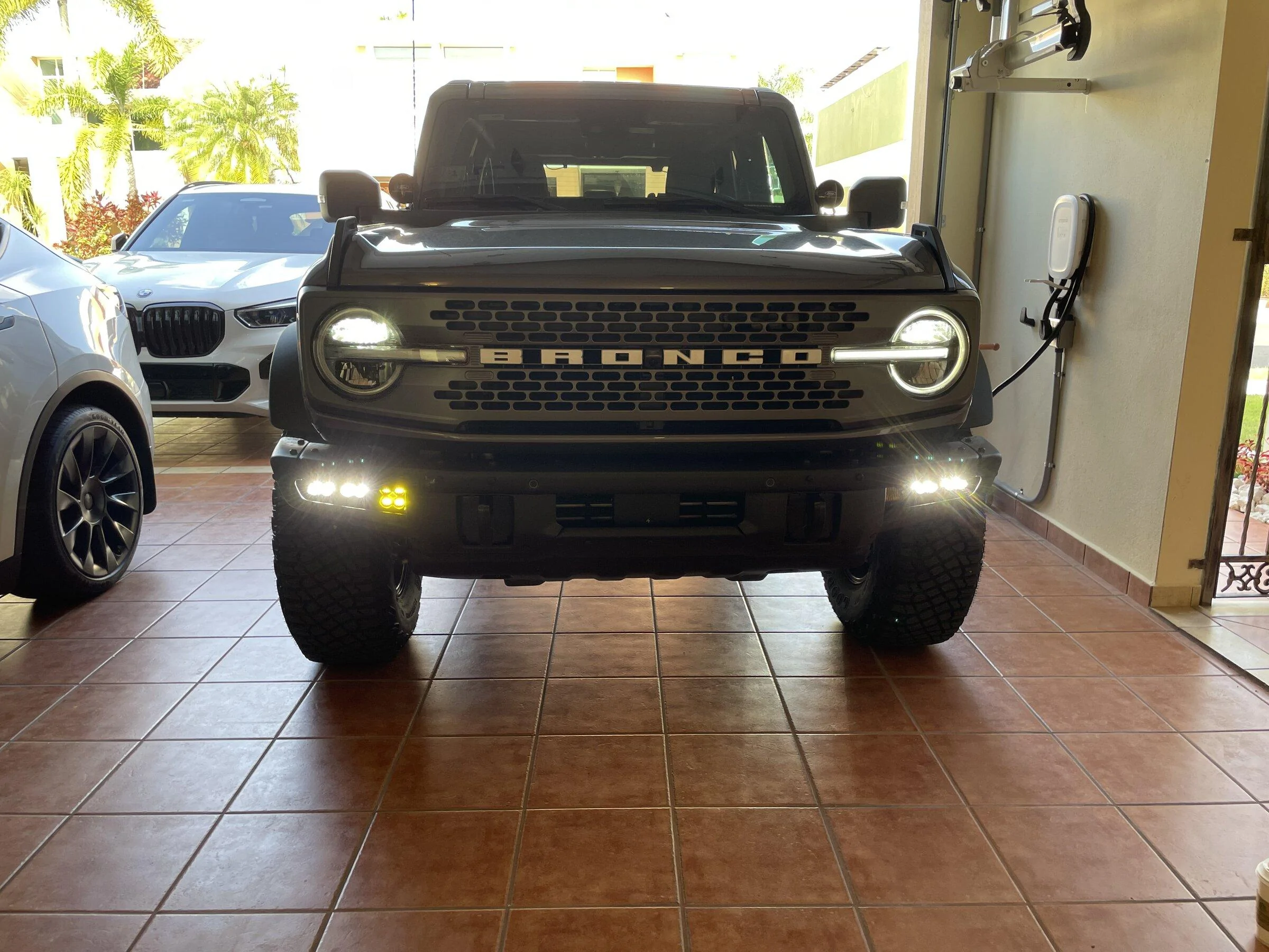

Luyi_PR
Enrique
May 2, 2022
Puerto Rico
Tesla Model Y, BMW X5 xDrive45e
I just did the changes, some how only the passenger side fog is turning on. Any idea what I’m missing? I’m using 4x4 new pigtail which isn’t the problem as I just switched between sides and tested both. Neither is the actual fog. It seems I’m not getting power to the driver fog oem plug.

drew707
Apr 9, 2020
875
1,444
Ford Explorer
This may sound silly but did you enable the drivers side? They each have to be enabled individually.
May not be silly at all, in which of the steps should I a had done it.

was
The step where you enabled the RF (passenger) fog light.
i don’t recall 1 step where it noted RF, the steps I follow were these
BdyCM Configuration
Front fog lamps - change this to "Enabled".
Fog Lamp Switch - change this to "Enabled"
Using Front Fog With High Beam - "Allowed"
IPC
BdyCM (As-Built Configuration)
726-42-01-xxxx-xxxx-xxxx - Change this to 726-42-01-xxxx-0101-xxxx
I rechecked and everything was as updated. I am definitely not getting power there. could I have a bad factory plug?
drew707
Apr 9, 2020
875
1,444
Ford Explorer
was
BdyCM Configuration
IPC
Apologies, it wasn’t specified since it didn’t really need to be. It would be
The first 01 is the Left (Driver) and the second is the Right (Passenger). If you double check that it’s enabled then yes it could be a faulty plug or a problematic pin in the main harness. You’d need to diagnose with a multimeter to see if you receive anything at all and depending on your skill set you could check continuity through the harness to verify it’s the harness or something else.
Cfield90
Oct 28, 2021
642
1,060
South FL
21 Bronco/22 Escape/01 Softail/90 Bronco (former)
Not sure if it was the factory plug or my wiring of the pins (I got a good crimp on it, so subscribing to theory it was the factory plug), but the passenger side didn’t light up. I didn’t test but just cut off the factory plug, wired direct, and poof, they worked, so for me it wasn’t a harness issue.

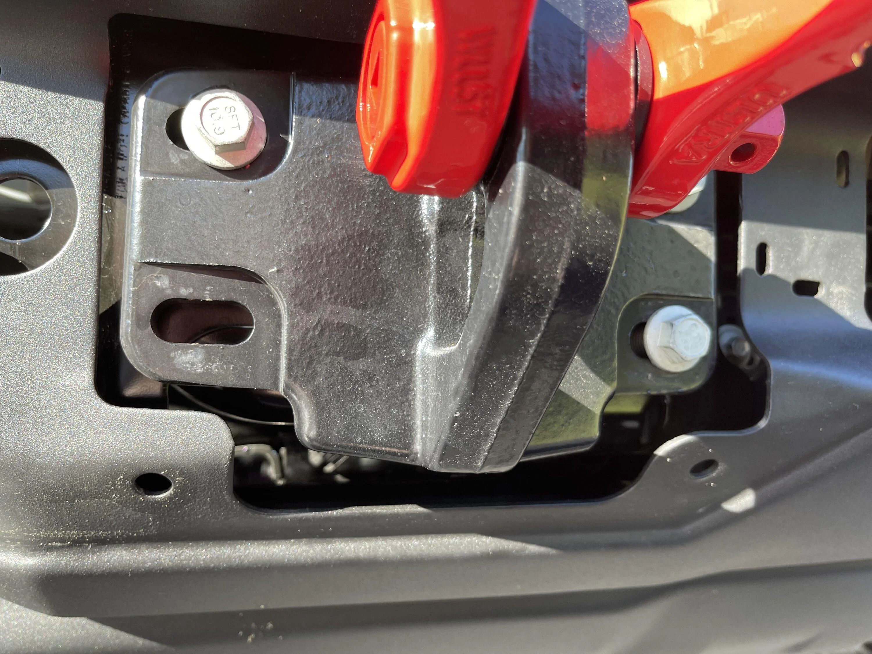

It looks like the harness for the fog lights has been eliminated on 2022 Job2 builds-I can’t find it behind plastic covers and looking under and behind the bumper I don’t see anything.
I have a Big Bend Mid package with the modular bumper.

drew707
Apr 9, 2020
875
1,444
Ford Explorer
This is a Job 2 build? What’s the build date?
Looks like I can see the push pin the plug is mounted to on the bottom left of the crack/opening but not for sure.
Ducati1098
10,044
23,411
Midwest
Willing to bet it’s in there. Just a little difficult to find. I doubt they made a new separate harness
Deltamav
Ben
Nov 27, 2021
127
366
Cherry Hill, NJ
2022 Badlands
I recall reading somewhere on these forums that it was restricted to high and lux package builds.
