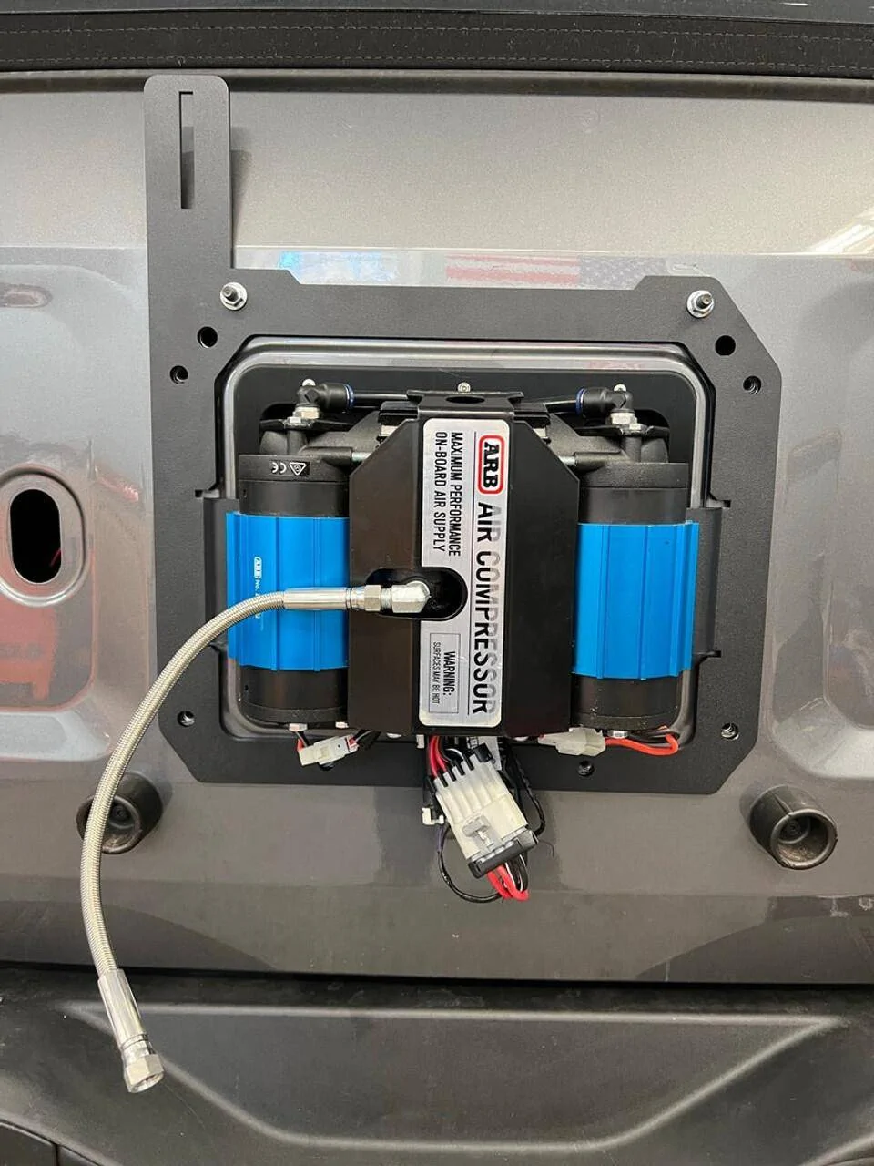

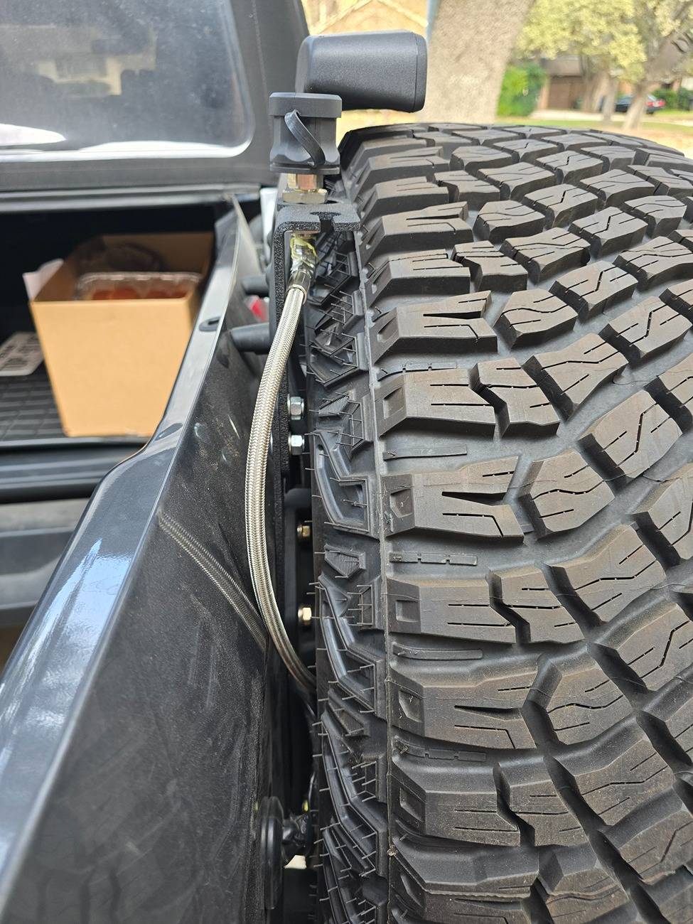

There's a couple of options to install in the rear cargo area - seem to recall one going in the tailgate, one going down where the cooler/jack are, and someone installed one up near the fuel tank.

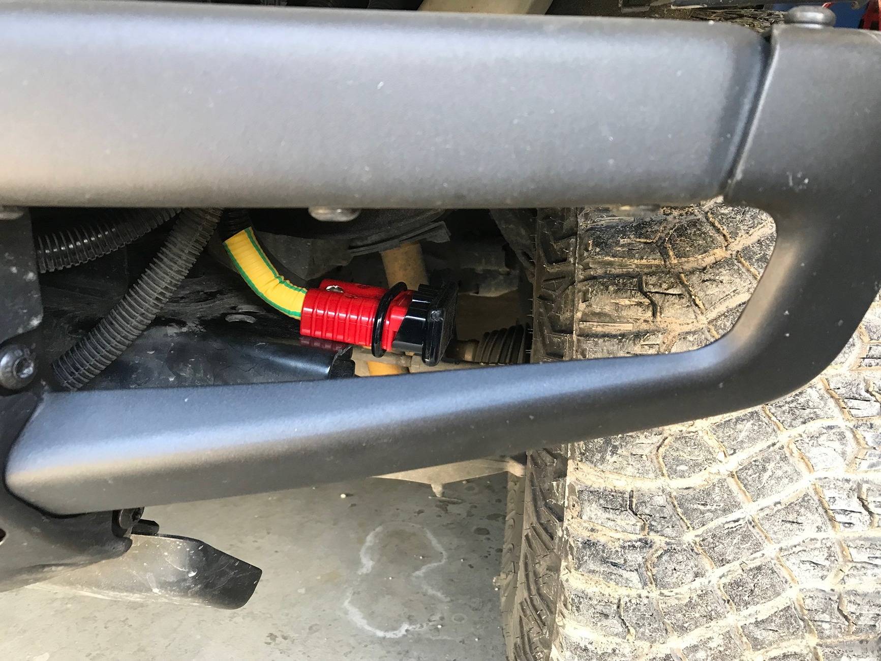

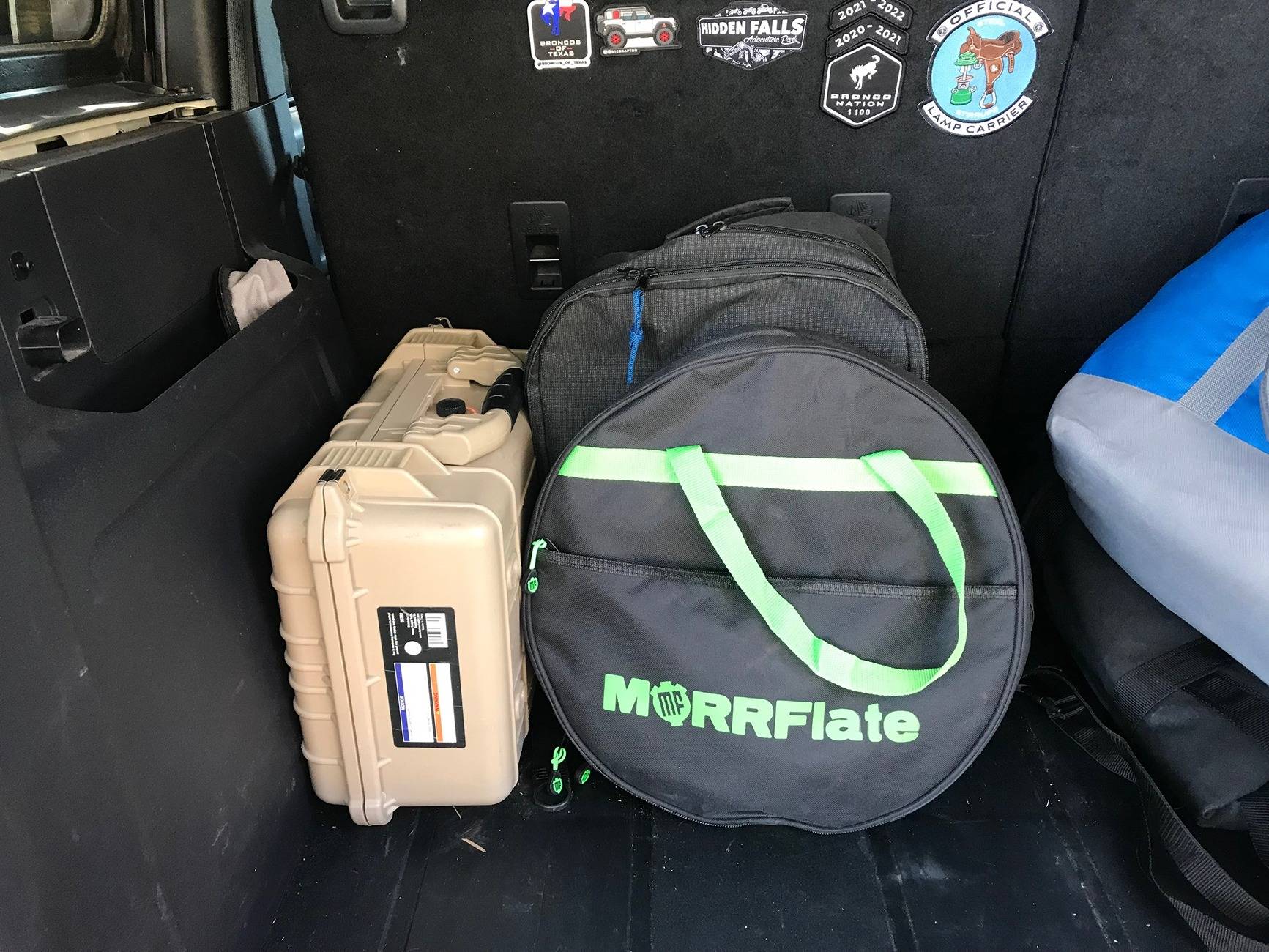

I keep mine in a HF box in the back. added an anderson connector so I don't have to use alligator clips to the battery nor do I need to open the hood. these Napa style compressors are inexpensive and work very well. mine is a Trickflate 300. I also have the MORRFlate 4-way

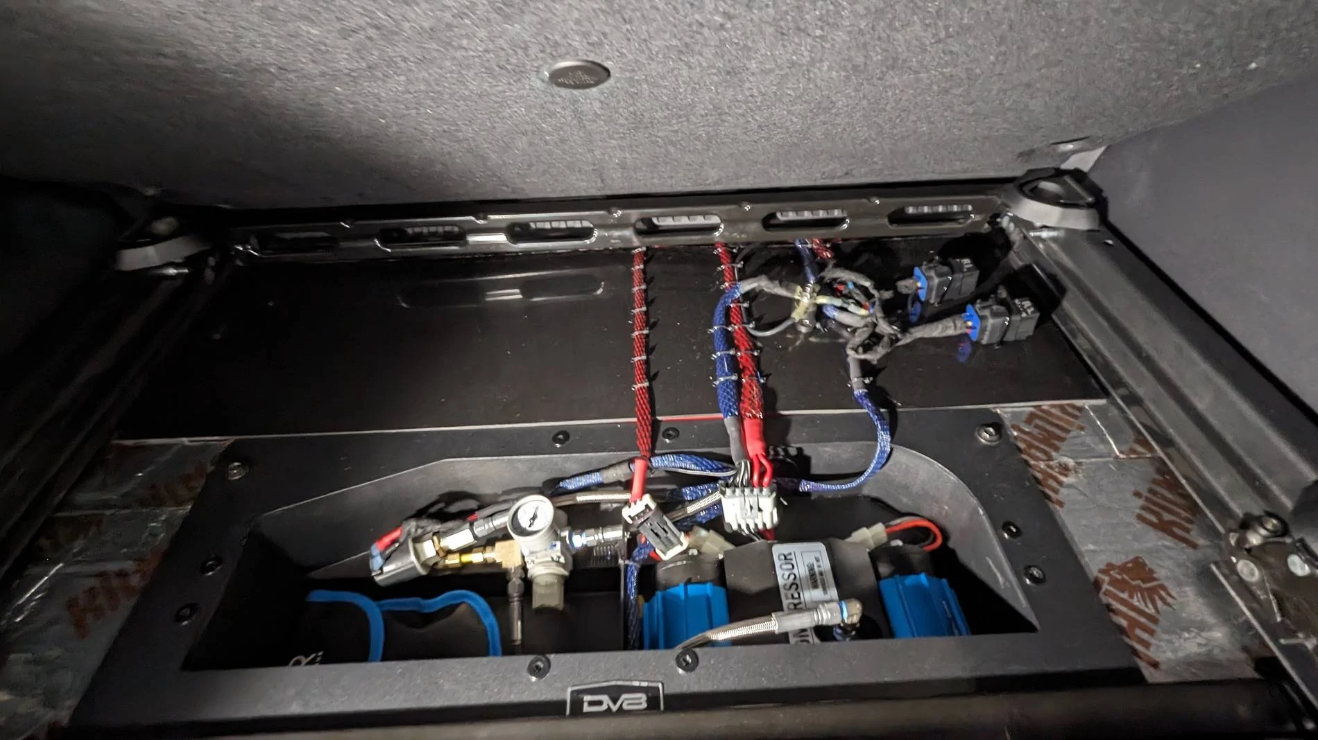

DV8 Storage Compartment mount. Includes 2 gallon storage tank, remote air chuck, regulator for Air tools, water separating filter and a Hadley Big Bully air horn. Running of Aux switch to shotdown air system in event of malfunction and reverts to factory horns. (thus the 2 relays in upper right of photo below) Works better if you have the slideout tailgate.
Full build photos here:
https://photos.app.goo.gl/JK9DzkcMWQaB368UA
