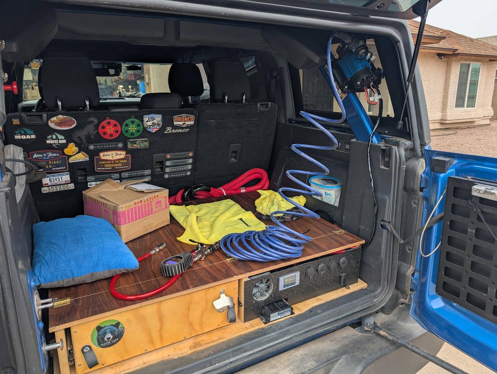

Posted this elsewhere, but posting here to maybe give you a different idea. I just printed a bracket to mount to the roll bar, and mounted it up there, then ran to my aux batteries for when I need it. Keeps it inside and out of the dust and dirt, and plenty of ventilation around it to keep it cool

I have seen that before and think it is a great idea. I will be building lightweight shelves that will probably cover that area. I could still make it work but right now am leaning toward under the Bronco. Your option is still a possibility. I am waiting to get an Ursa Minor camper installed so I can start designing my shelf system. Thanks for the reminder.
