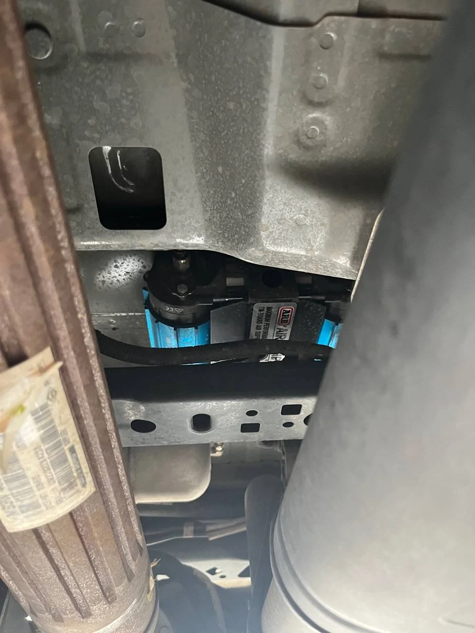

Mine is tucked up next to the gas tank with no issues, it barely gets wet there and there is plenty of ventilation. Intakes routed to interior space under passenger floor, coupling hose run to an footthold in rear JCR bumper. Every couple of weeks I spray the road dirt off with a hose. Stiil, eventually I will move it to the DV8 floor cargo box I just bought for ease of access if there is any issue with it.

That looks like a good place too. I have seen online that other people have mounted under the vehicle with good results. I am going to give it a try too. I will probably go with the ARB single for size and simplicity. I am usually in no rush to air up.

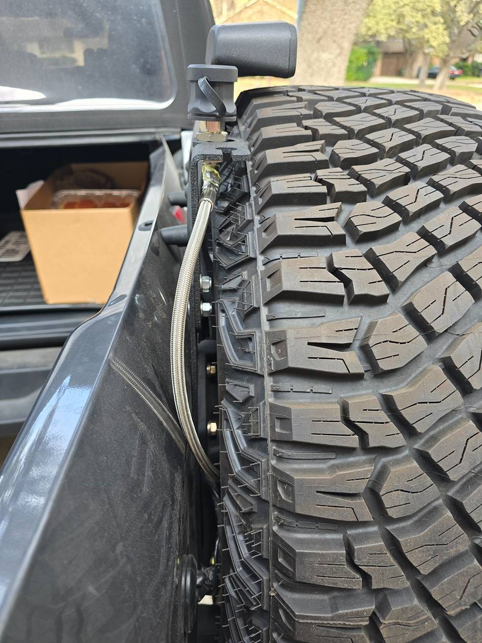

Have you looked at any of the tailgate compressor options? I installed one from IAGOffroad.com that came with everything you needed. It mounts inside the tailgate with a small air tank behind the spare tire.

That is a nice system with the VIAir compressor single. I have the AAL mount with an ARB single in the tailgate as well. I think though that people want to go with the dual compressors, so both of our options are out. AGS has a system that allows the dual system behind the tire mount. As mentioned the DV8 tray allows the dual system, and it's a nice setup.

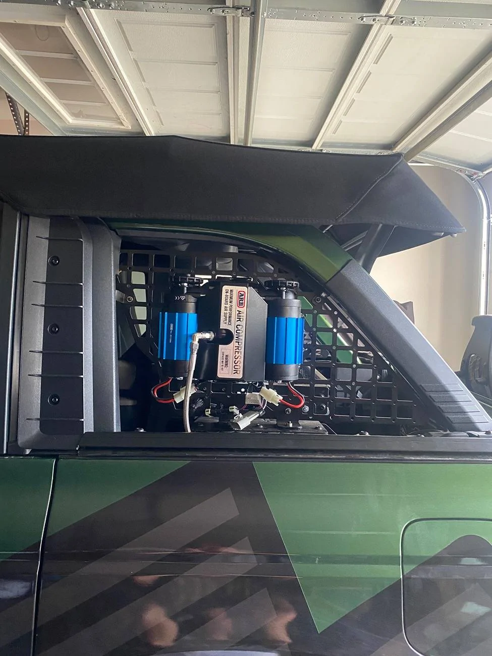

I use a molle panel mount option from @Mountains2Metal . The compressor fits nicely between the roll cage and the window , using otherwise unused space and the switch/chuck are easy to get to
Ford Bronco Mounting an air compressor under the bronco? IMG_3904
Ford Bronco Mounting an air compressor under the bronco? IMG_3901

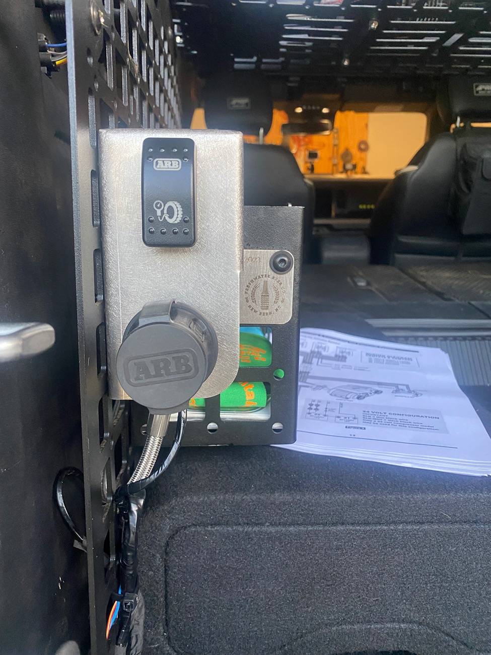

Have you looked at the DV8 storage compartment option? It works great! My install was a bit more involved, but the picture album should give you an idea.
https://photos.app.goo.gl/JK9DzkcMWQaB368UA
Yes I have. Unfortunately, that area is already reserved for other storage. I am used to exploring with a Supercab Ranger with a 6ft bed. I must down size with the Bronco and rethink how I pack. Storage space is going to be at a premium for me now. I also don't want to have stuff hanging outside my vehicle.
