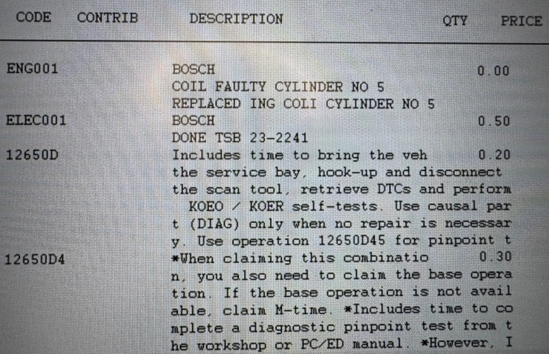

Also, I asked the dealer again about what was done back then, and they confirmed that the repair involved replacing the coil assembly for cylinder number 5 under warranty.

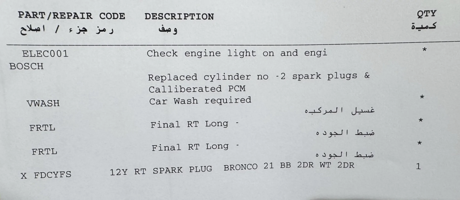

Hey guys, so I just picked up my car and the following is what they did as shown in the report.
Ford Bronco Engine Misfiring Issues Right After Service 1754214219949-m2
Then I also asked them what they did the last time the same issue happened they showed me the following report
Ford Bronco Engine Misfiring Issues Right After Service 1754214338687-ar
Do you guys think I should just let this go? I still have around 2.5 years on my warranty.

Does it drive normally now? If so, it was obviously just a separate concern. Parts fail sometimes, nothing I would worry about.

Oof-that’s rough. Hopefully they’re better at calibrating than they are at spelling. Is calliberating another word for Crank Relearn? That seems to have helped ours.

Yes, they were both misfire issues. But as long as it isn’t misfiring anymore, it sounds like they diagnosed and fixed it correctly both times on 2 completely separate cylinders and 2 different parts. There’s nothing to suggest you will continue having any problems.

That would be difficult to do if your truck is running fine now. Two issues, it was solved both times; and it was two different parts on two different cylinders that failed.
