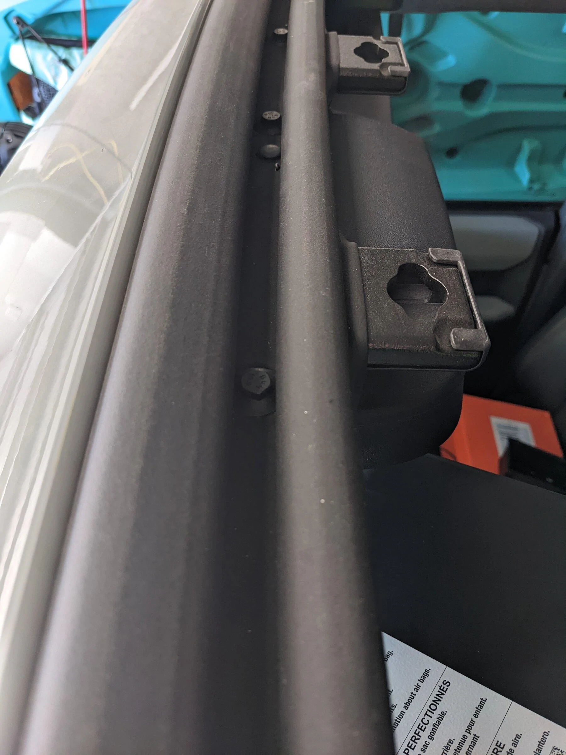

I removed the panels for the first time and did not see any missing bolts. It looks like there are two drains in the channel, one on the left side the other on the right side. The drains run the water out through the pillars.
