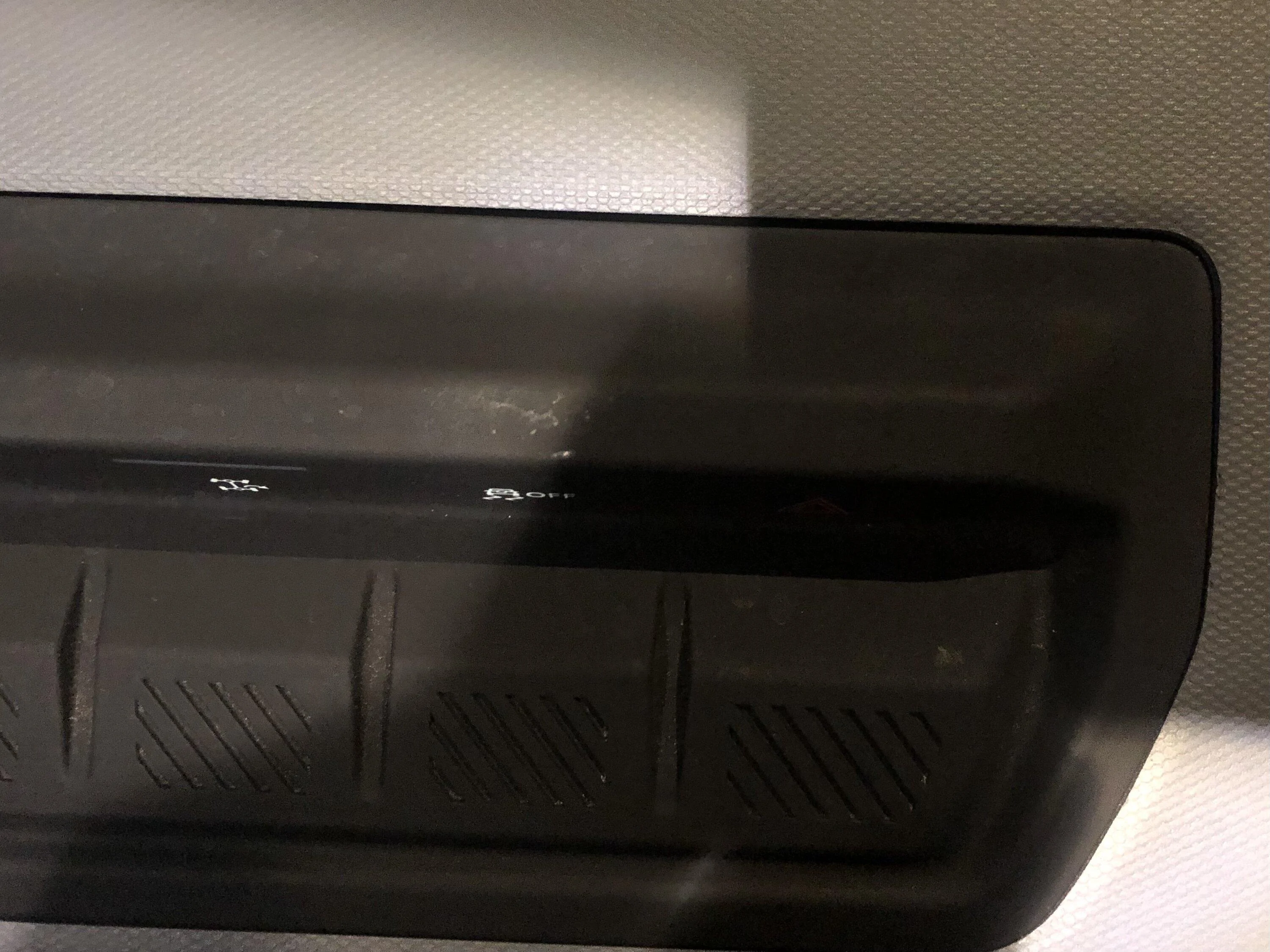

@flip do you know if the hero switches are supposed to be sealed or is that gap actually supposed to be there. Seems like real flaw for an open top vehicle to have a really easy way for water to drip all over electronics...

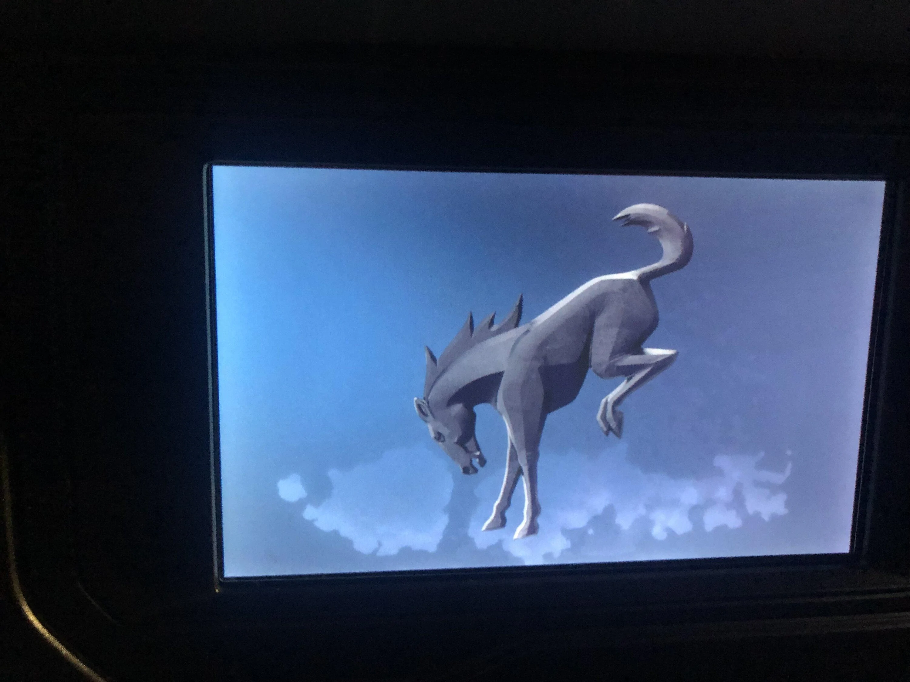

The switch is coated with silicone or some type of rubber so it's fairly sealed but the unit drops down into the dash almost directly above the display. I can easily see it running around the edges and dripping directly onto the screen.
I think Ford did some stuff to help make it a little more water resistant as well as for the tactile feel. Yes, rain is going to get into the electronics from above and if you swamp the interior, going to get into connectors and maybe some modules. The did a fair job at moving modules and other sensitive electronics higher up in the body to give them more of a chance when people get into mud or spray. The probably assume you'll be throwing the soft top or panels on at the first hint of rain and it won't be that bad. It's always leaks like these that they didn't or couldn't account for. Much like some of the F150s and Expeditions years ago that had windshield delamination and let water enter and run down directly on the back of the GEM module/fuse box.
Make sure they pull the upfitter switches down and make sure there isn't any water sitting in the connectors or switches. Last thing you want is corrosion starting that doesn't show up until 37,000.
Thanks @flip. I always park it with a garbage bag and towel on the dash over the hero switches. Of course I thought the issue was fixed by the dealer so didn’t do it on the last wash and now my screen is cloudy again. I’m also worried what all the water going through the over head lights and aux switches is doing. I’ll make sure the dealer pulls the upfitter switches down to be sure there isn't any water sitting in the connectors or switches, as you mentioned.
