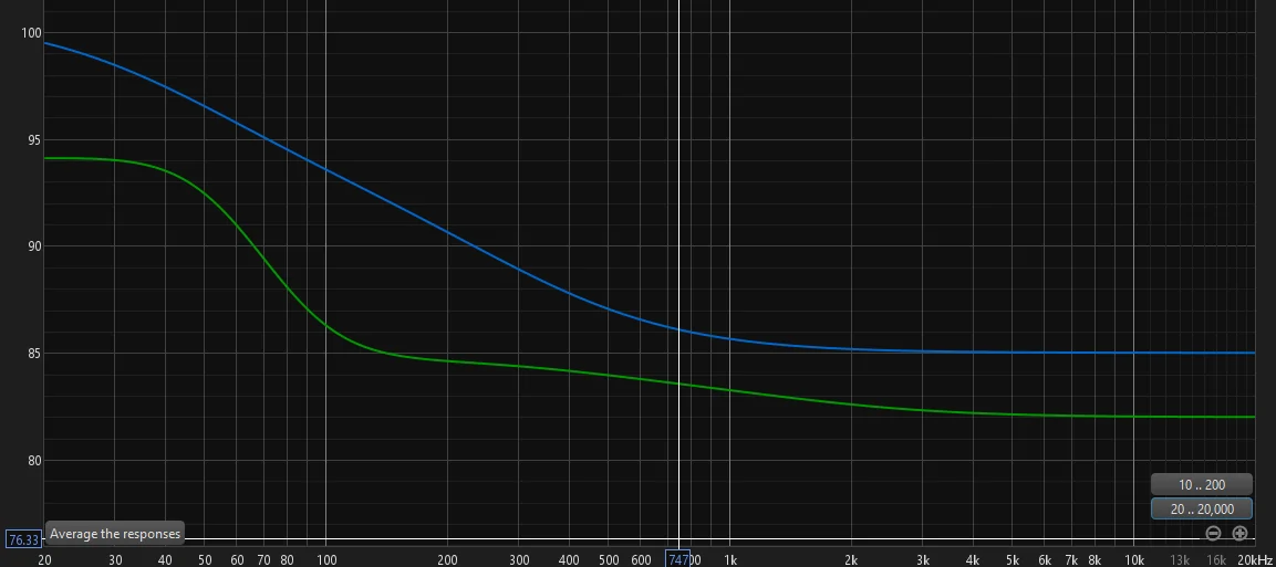

i made a small write up on this topic in another forum, see below for a copy/paste- DIY mobile audio should have some curves you can steal. but i think getting everything in the bounds and playing around a bit will give you a better idea of what you want.
much like with speakers, a frequency response curve does not tell you everything BUT it is the single most useful piece of information about your systems sound. there are a wide number of curves, and although attempting to get 100% adherence is not recommended, having a target to compare against will make your life much easier. I looked at a plethora of targets and created upper and lower bounds that capture almost every target. you can take these two curves (the spacing is important!) and import them to REW to check your own systems FR against them. you can then use the bounds of the curves to inform you on where adjustments for taste are typically made.

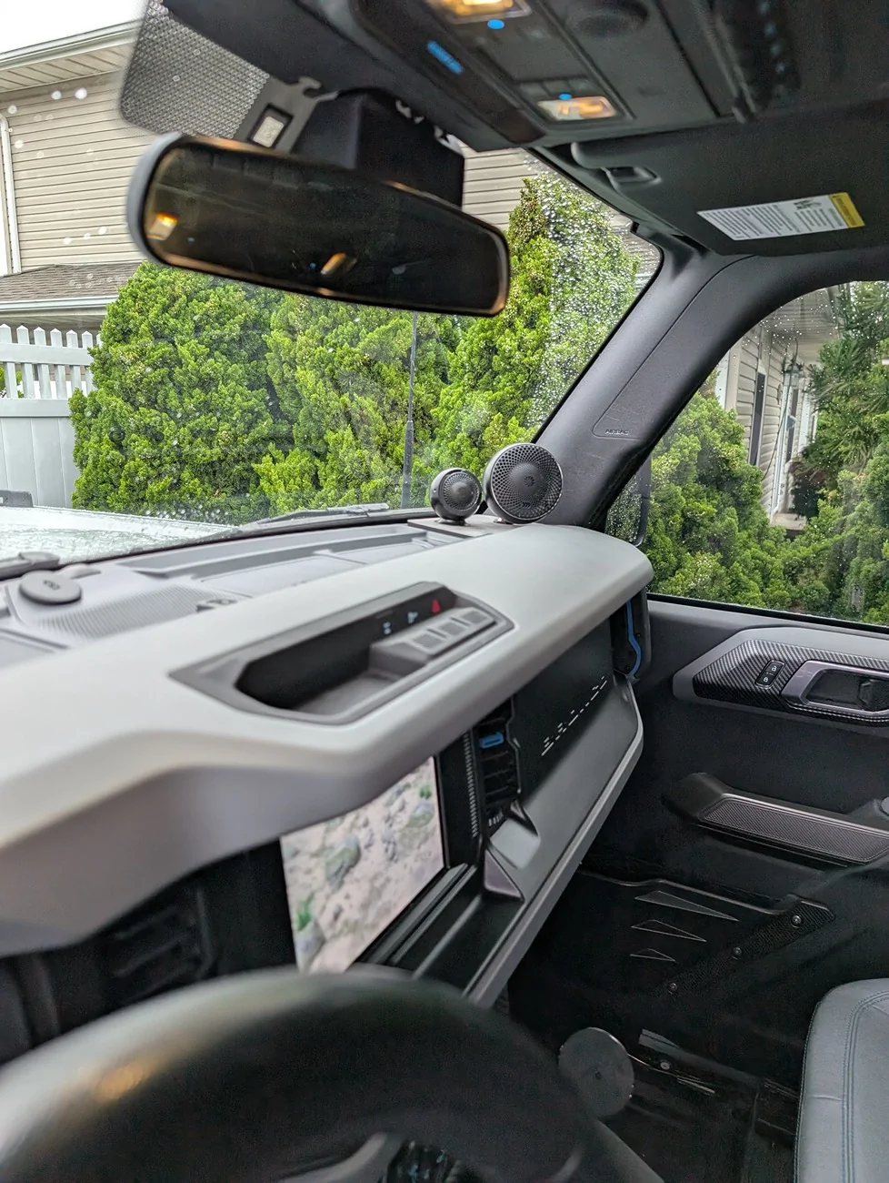

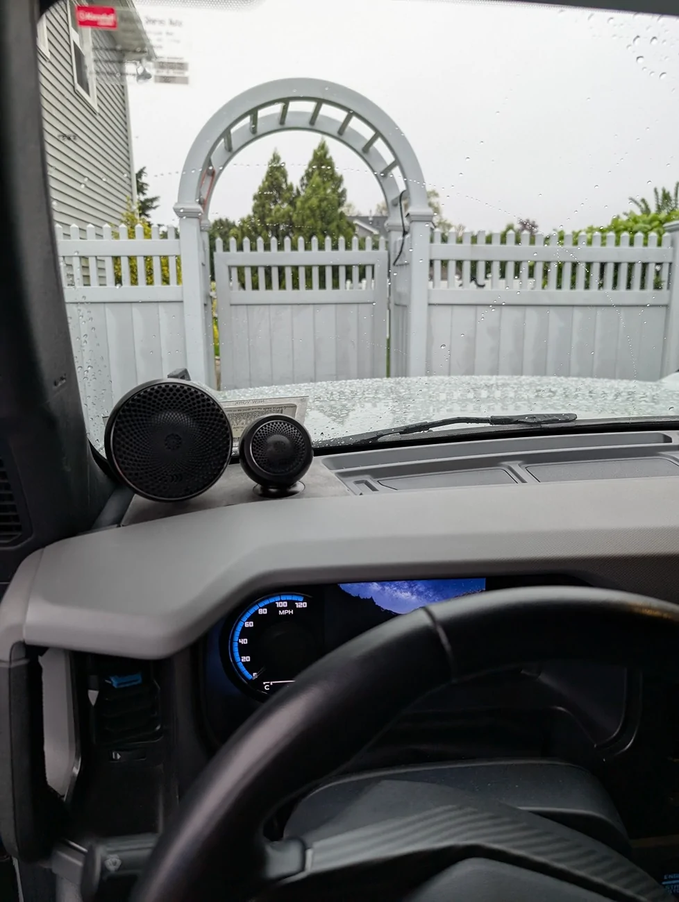

I ended up using speaker pods to aim the tweeters and mid range drivers towards my listening position in the driver's seat.
Ford Bronco DSP house curve for tuning fe5a63e1-a5bc-4983-be2e-3888007b95d2-1_all_1813
Ford Bronco DSP house curve for tuning fe5a63e1-a5bc-4983-be2e-3888007b95d2-1_all_1814

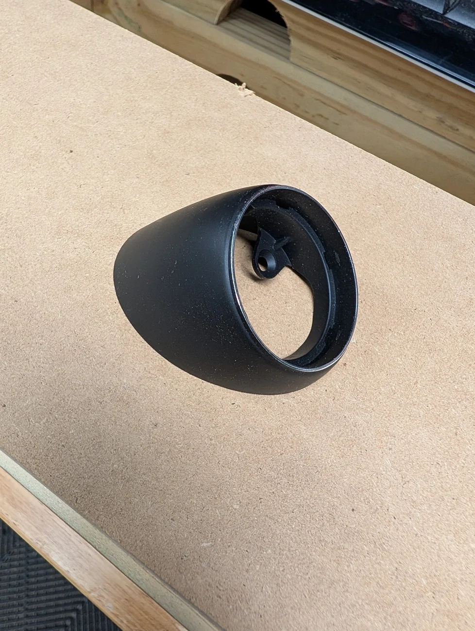

When I had these speakers mounted in the dash pointed up towards the windshield I found the reflection of certain frequencies unpleasant. I tried tuning down various frequencies but the results weren't great. I would try to find a way to aim your tweeters if you can. Some manufacturers include different tweeter mounting options like these from Morel:
