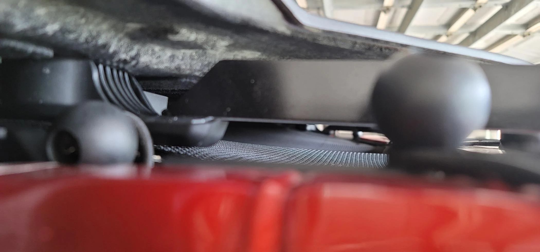

I did this just this past week, but I didn't trust it at interstate speed for the trip I needed to make, so using some scrap 1x1 aluminum angle I fabbed up a couple quick hold downs for the rear roof section. Used factory roof bolts and some random spacers I had in the garage.

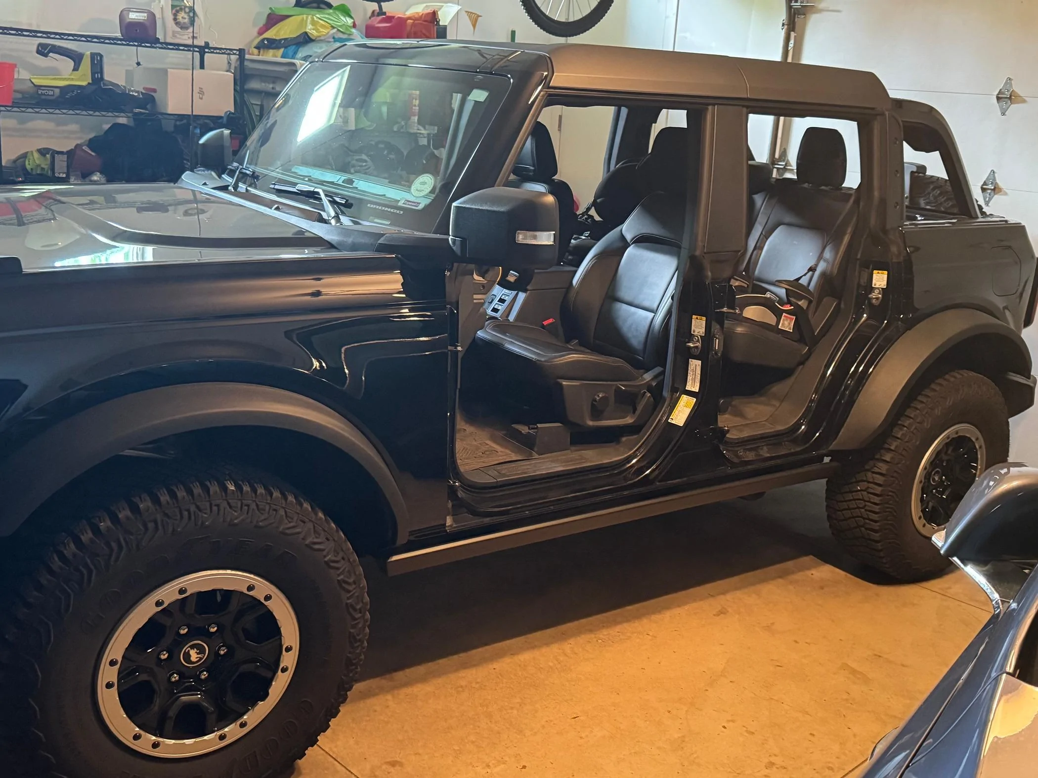

2 door, just did roundtrip to Miami and back through the everglades. 650 miles of everything from highway to 2 lane to dirt from 35 mph and up to 80mph with just the 2 front panels. Those suckers never moved a bit. I will be running her like this until December I think!

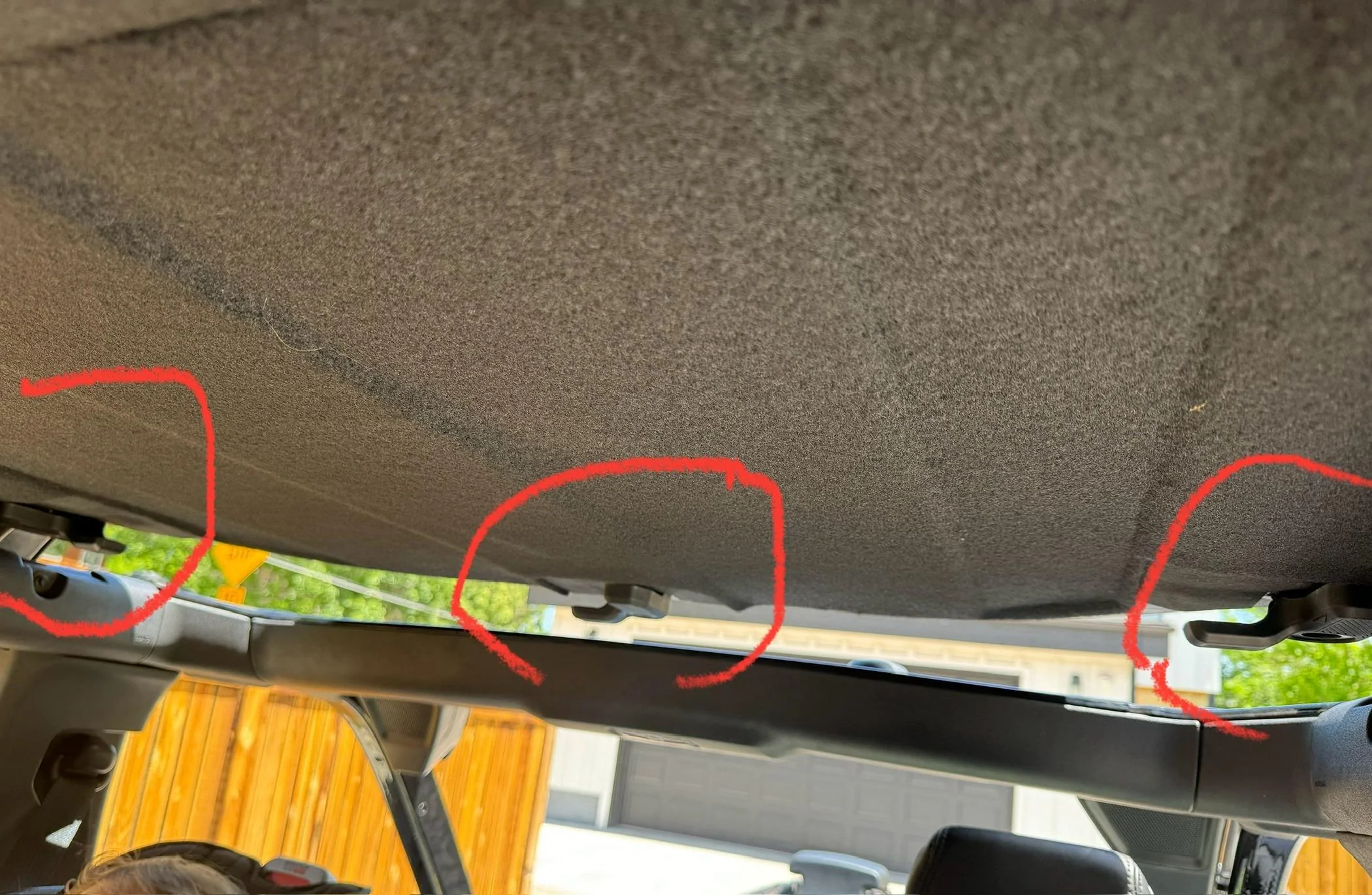

BUT, the midpanel is only attached with 2 of the 5 attachment points. The 2 j-hooks on the front end are connected but the 3 latches in the back are loose. 80+MPH is a good test and the bungee to the car seat connections is a good idea, but I'd feel better with those remaining attachment points connected to something firm.
Anyone know someone who could fabricate a part that would sit on top of the rollbar to replicate the 3 attachment points the rear clamshell provides? I would think the 2 boltholes the rear clamshell uses on top of the rollbar could be repurposed to secure this fabricated part.

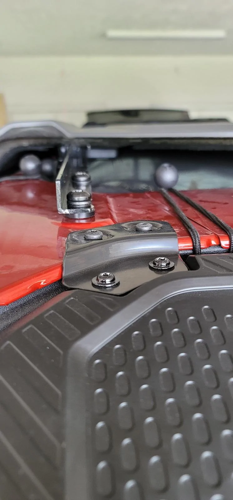

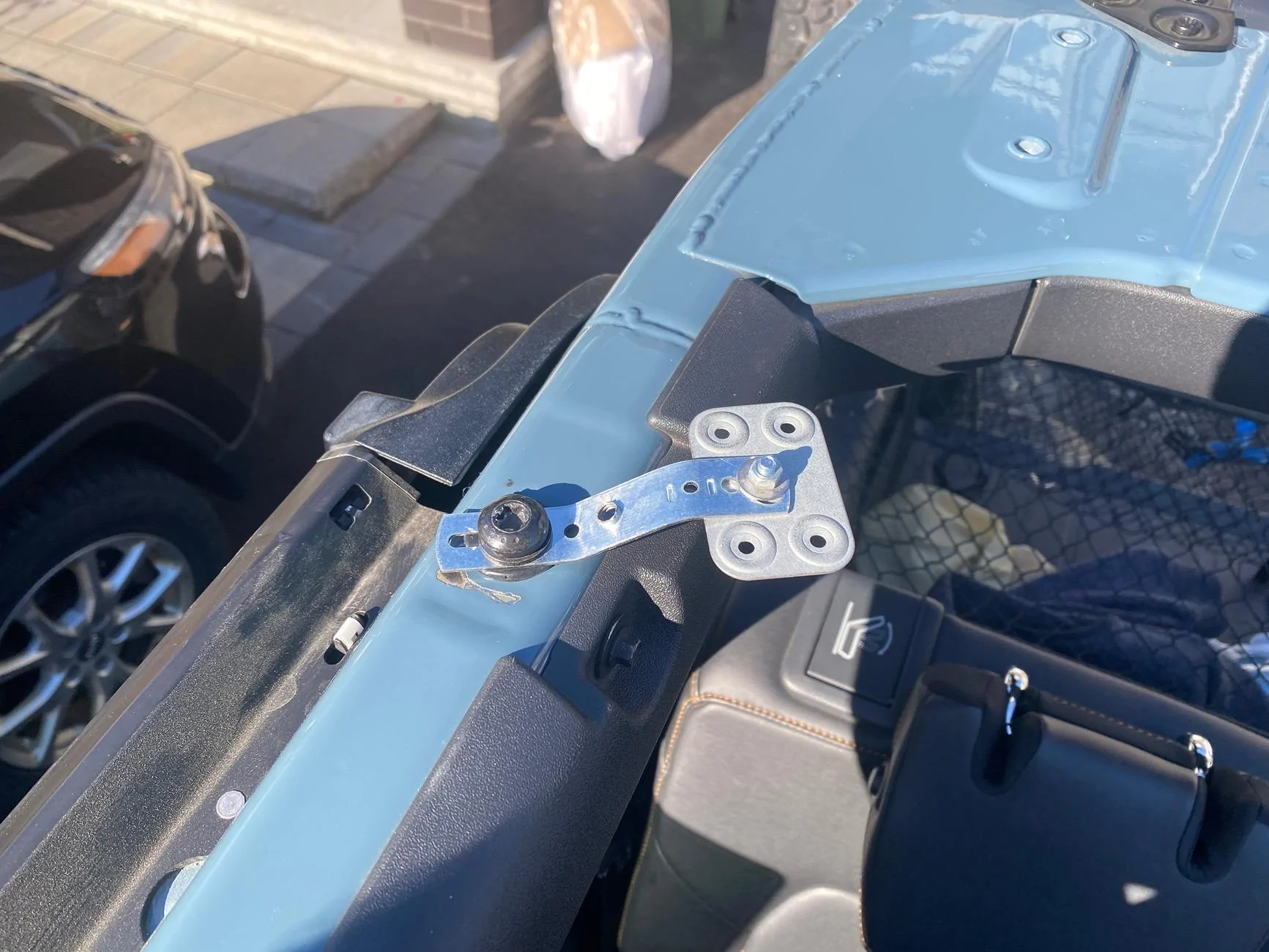

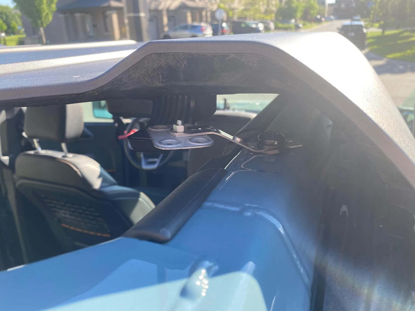

I am also looking into getting a way to secure the middle panel to the bar. I am discussing some ideas with a local machinist for something sturdy. In the mean time I used some leftover hardware I found in the basement. Not fully reliable (I'll definitely have to keep an eye on it) but it is fairly stable and the panel is not moving. I didn't go for a drive yet. I'll test it later.

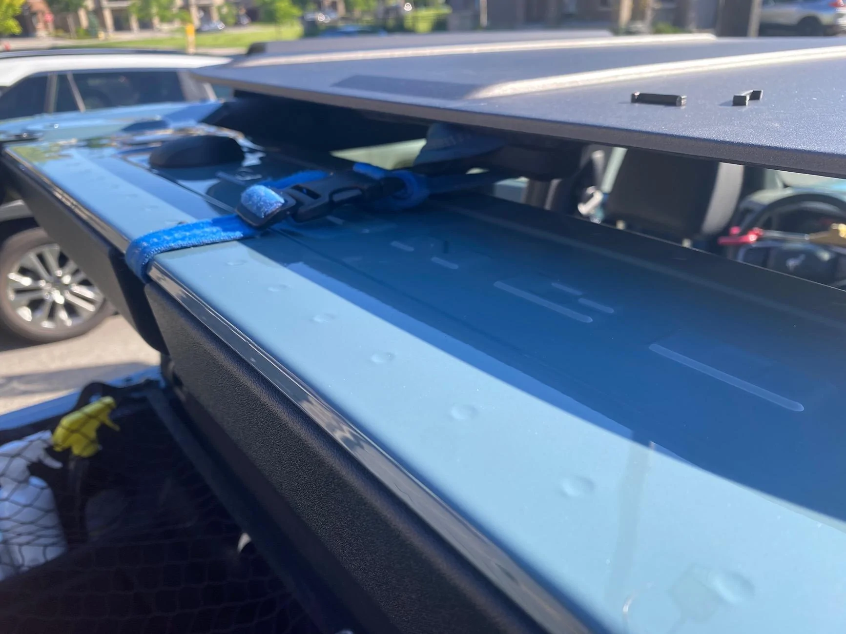

Otherwise, in order to play safe, I secured the middle latch with a strap.

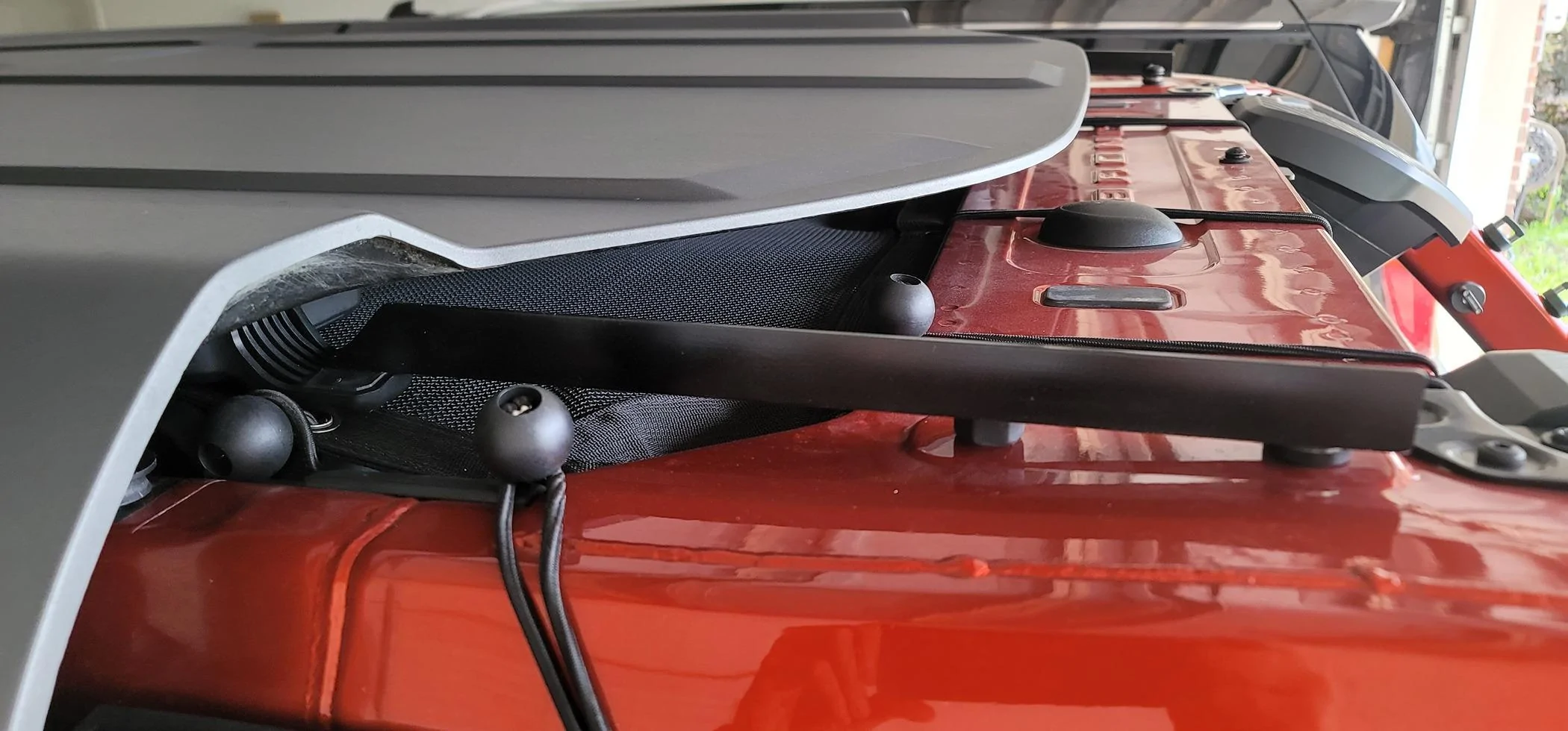

There are pics on forum somewhere of my 2dr running just the front panels. Personally I would not run without something securing the rear latches as when you meet a semi it can buffet and move some. It works fine until the day it doesn't. I purchased a length of 1" square tubing from Home Depot and did not even have to cut it. Painted it black and it sit right on the metal brackets on either side. I just wrapped a zip-tie around the bracket and tubing then the rear panel latches locked to it perfectly.
