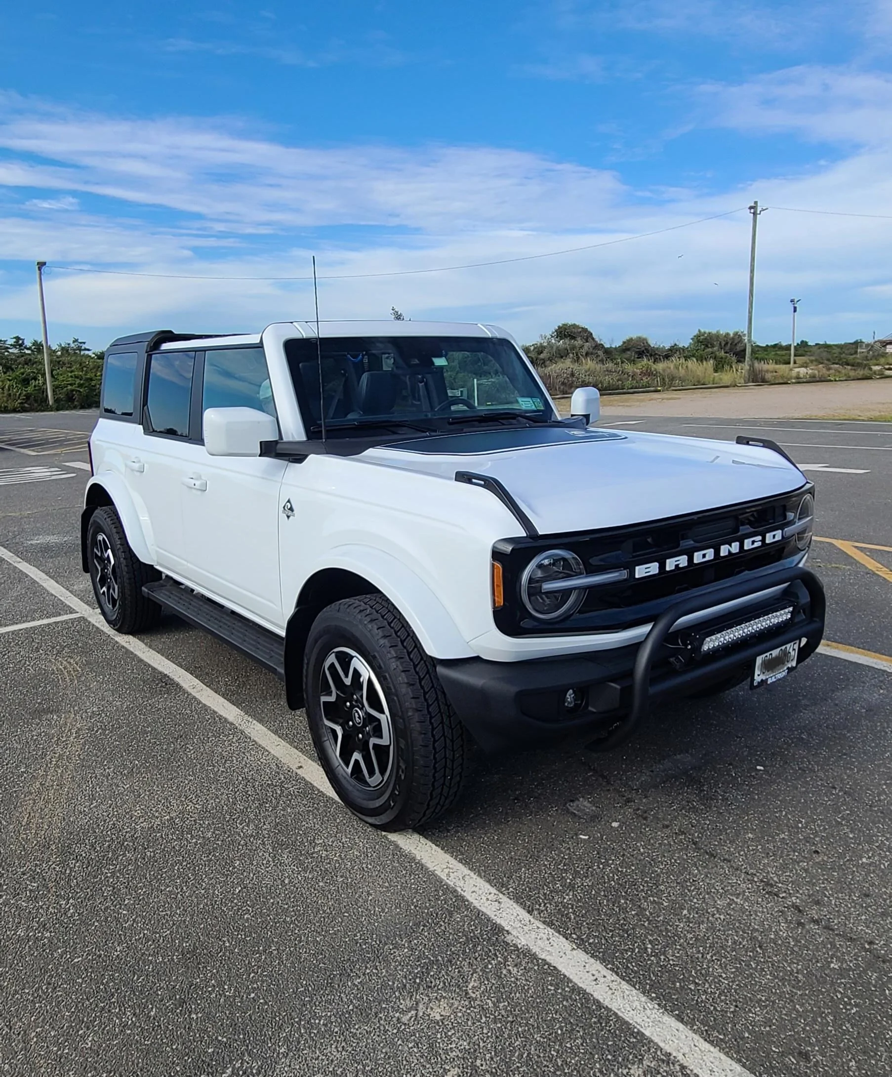

Many times front and middle topless.

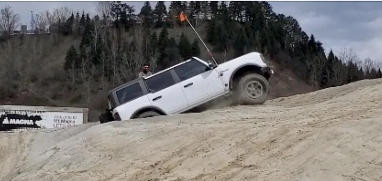

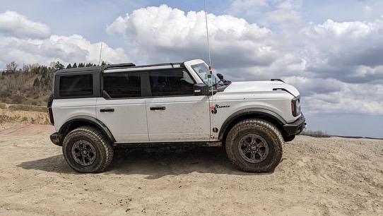

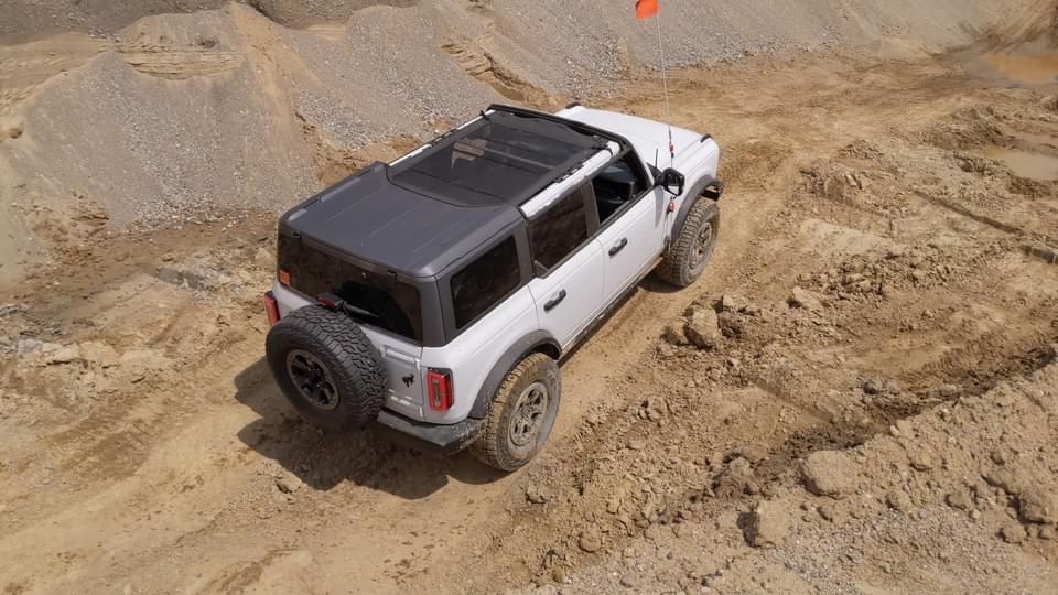

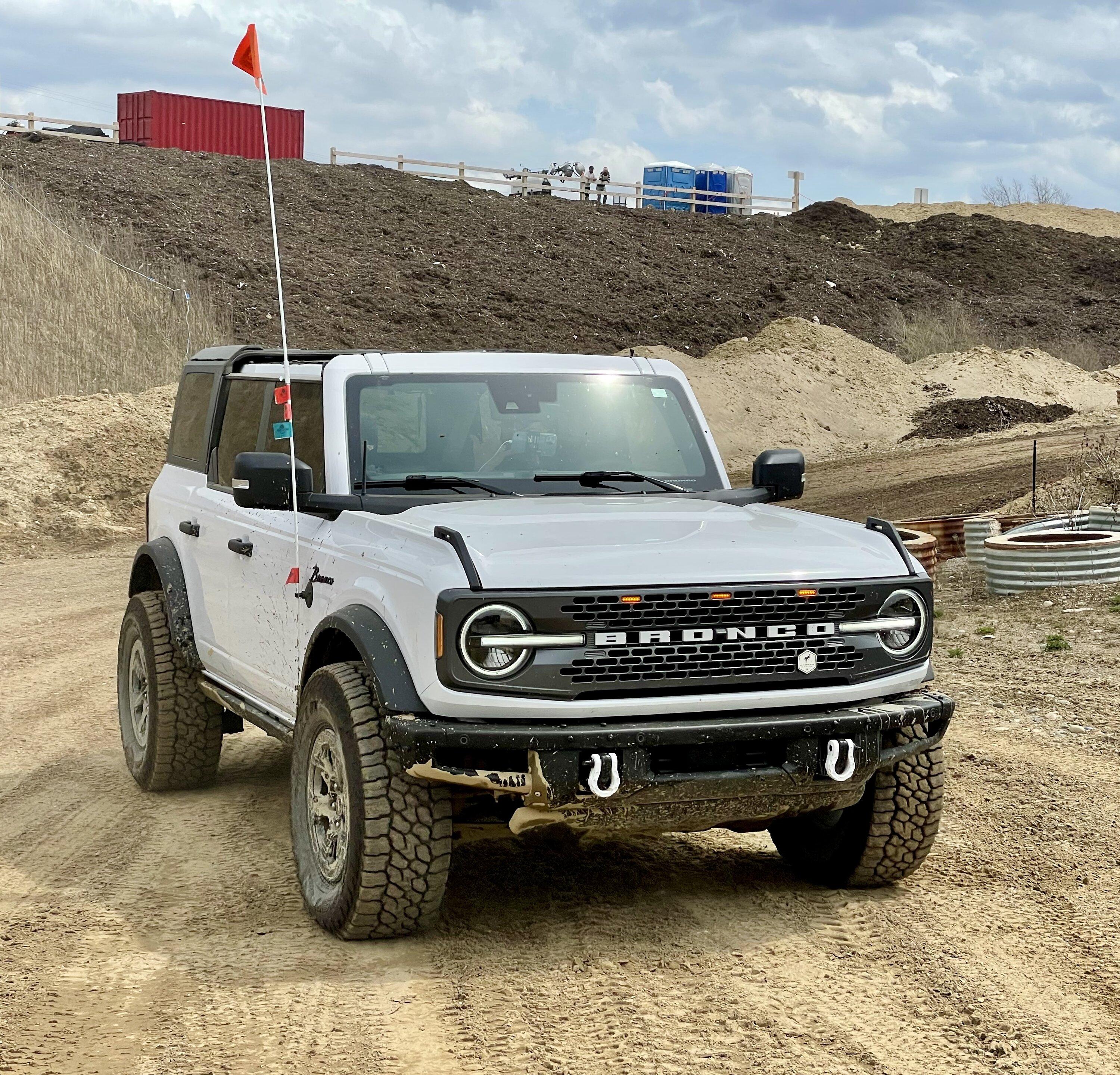

No worries on or off road!

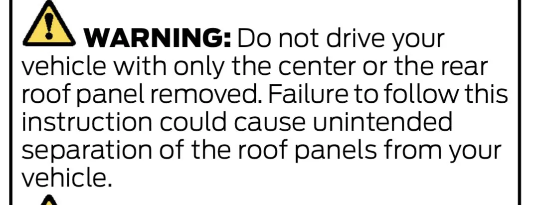

The Owners manual cautions about only removing the front or 2nd row panels. Does that make it ok to remove both and keep the rear panel in place? If it’s ok is there a lot of buffeting?
Ford Bronco Ok to only remove front and 2nd row panels? 793FF2A9-D286-4F15-8F09-02EAC31EB557
It says don't drive with just the front and rear in place or just front since there is nothing to hold down rear of front panel when center panel is not there.
You can safely drive with
Only front removed
Both front and center removed
All panels off including rear clsmshell
All panels on
