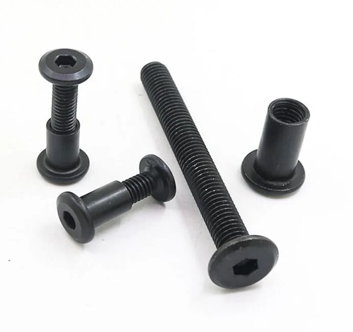

You could also use sleeve nuts to keep from compressing the top, you just have to make sure you get the length right
Neat, appreciate the info, seems like a good option too.

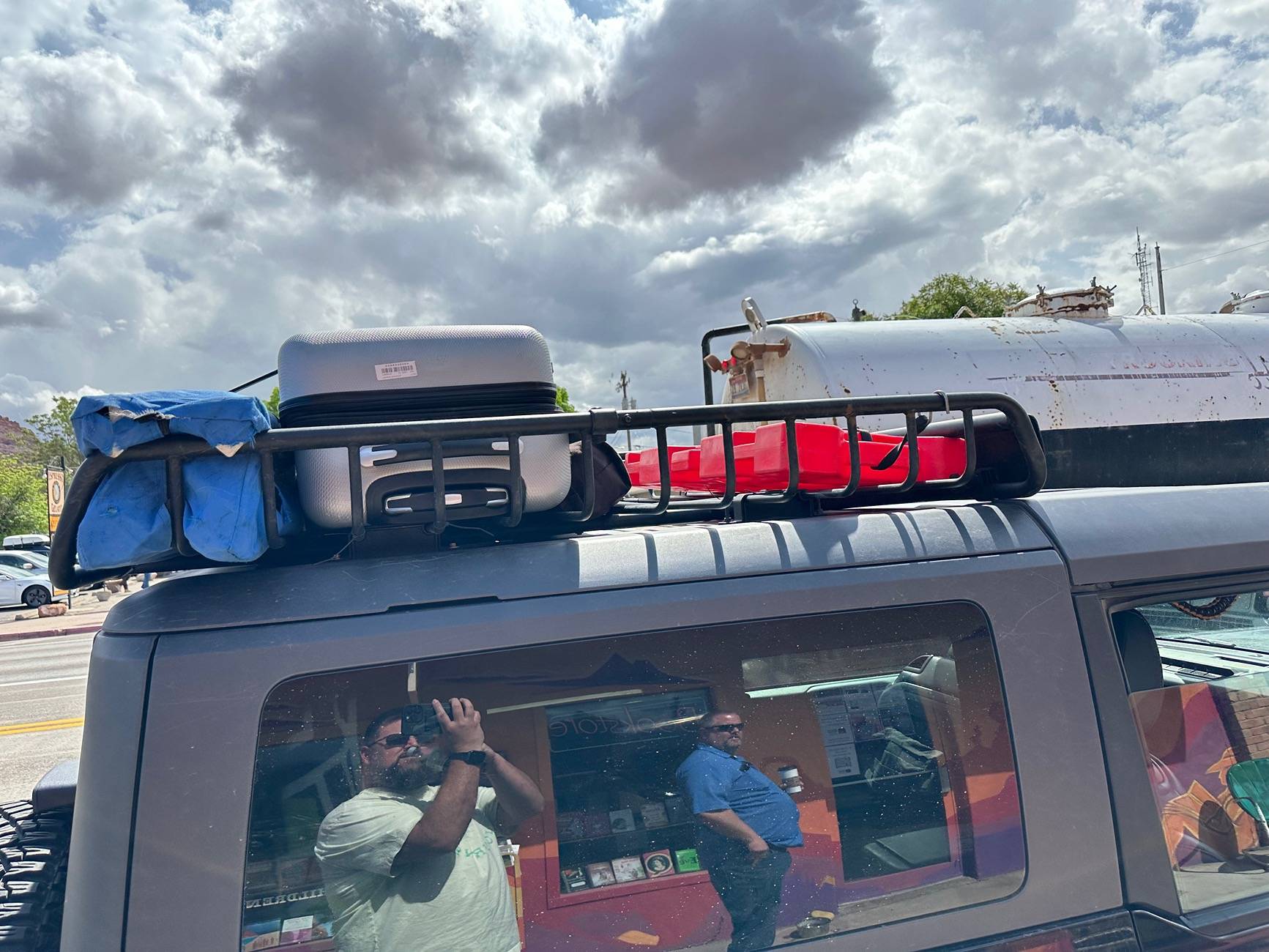

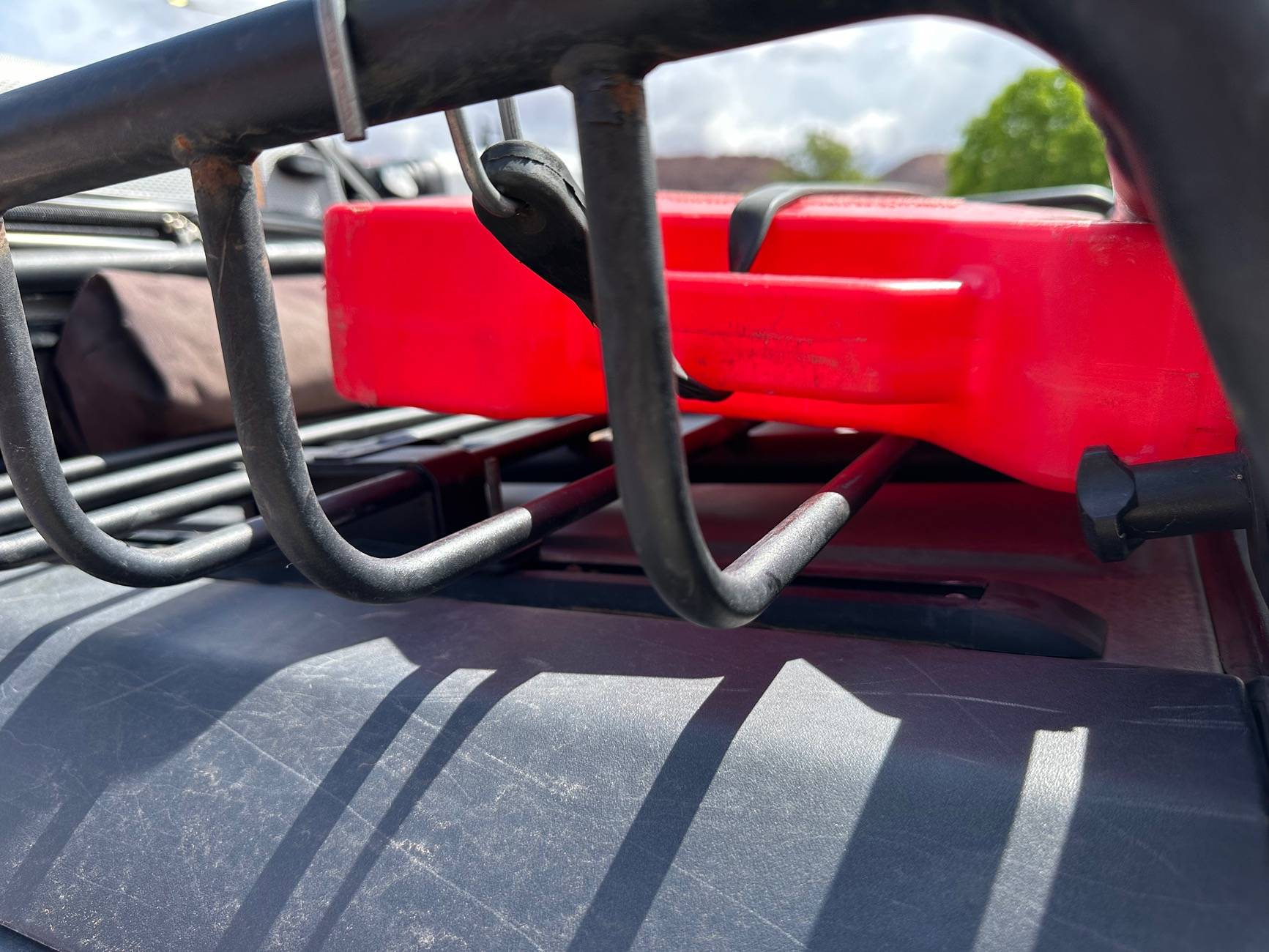

Hoping to get rolling on it in the next couple weeks. Just got back from a week out west and actually found a 2 dr in Moab that must’ve had the same idea. Didn’t see the owner but he through bolted a rack to his roof so I took some pictures. I could peek through the window and see he used fender washers on the inside but that’s about it. Gave me hope.
I have used quad max osi sealant with good success on a home built trailer I did years back so will likely add something similar to the process.
