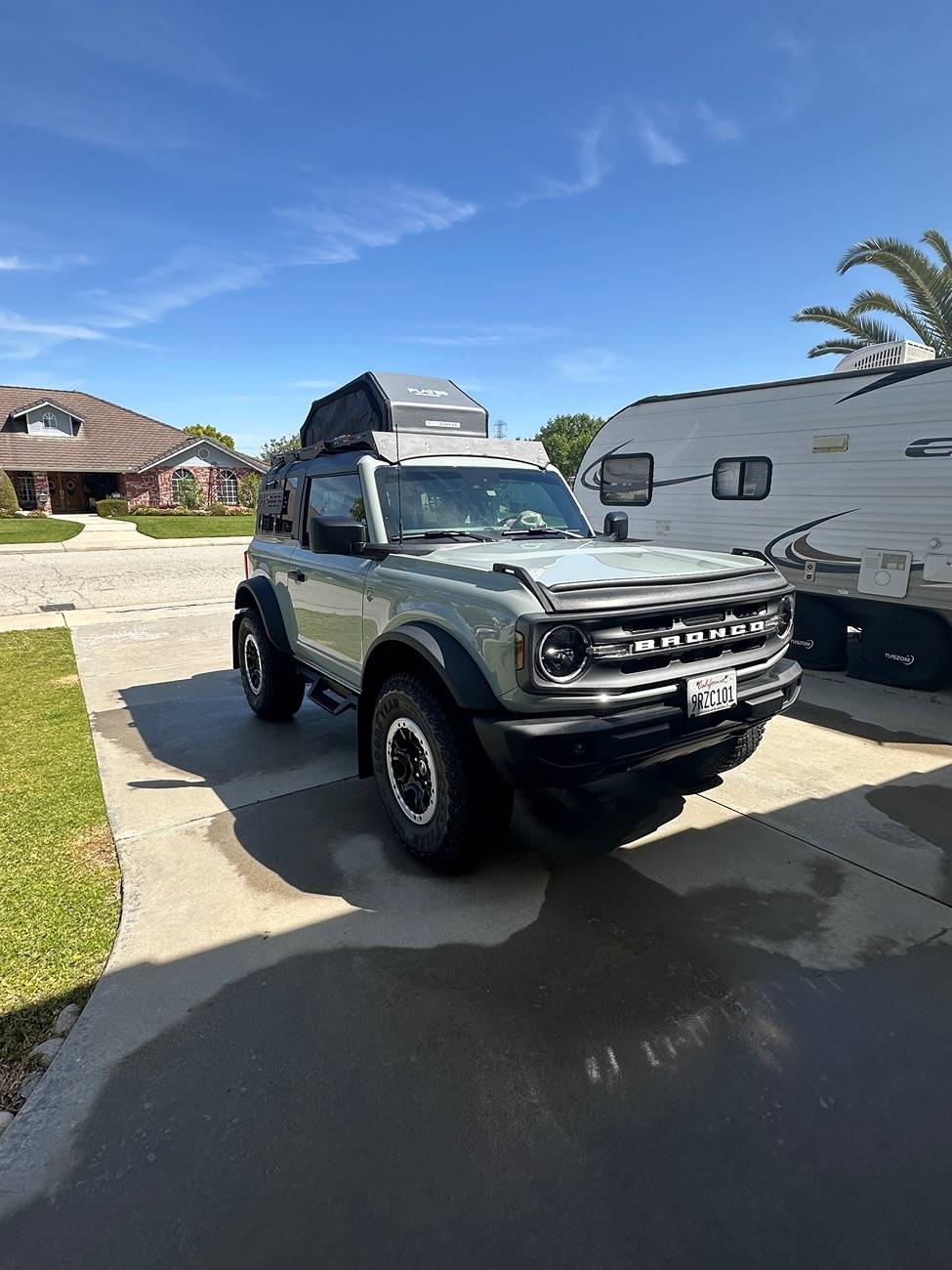

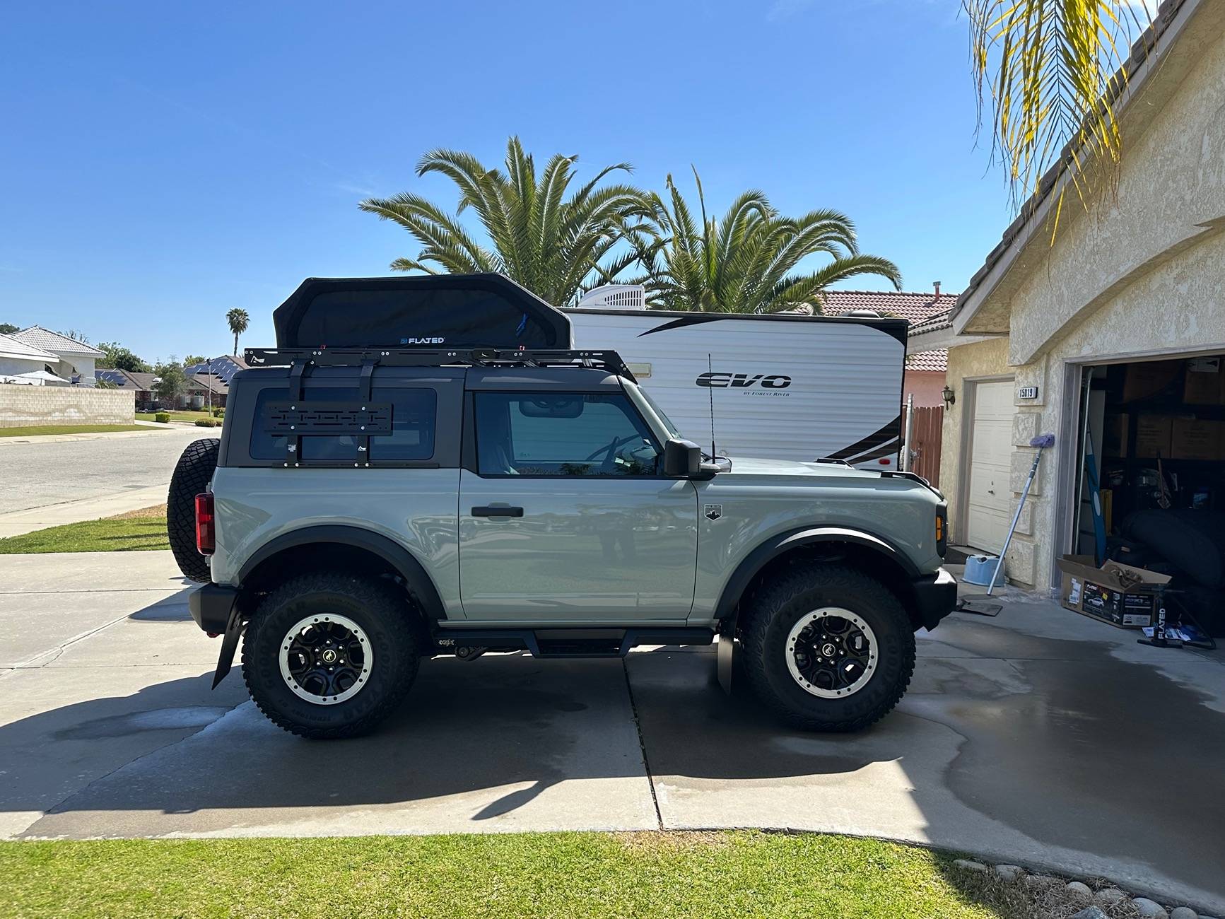

I’d really consider the Trailrax with side braces before drilling the top. Just did a 700+ mile trip with 300+Lbs in a medium Flated Air Carrier on top, without shaking, wiggle weird sounds etc. Very stable, and while not recommended, I suspect could handle much more weight.

The pics of the Bronco were before loaded. I had an additional 500 lbs inside the back also. Little bit of squat, but with the raised rear end when empty, it was basically level or just a tad low. Not noticeable much at all.
