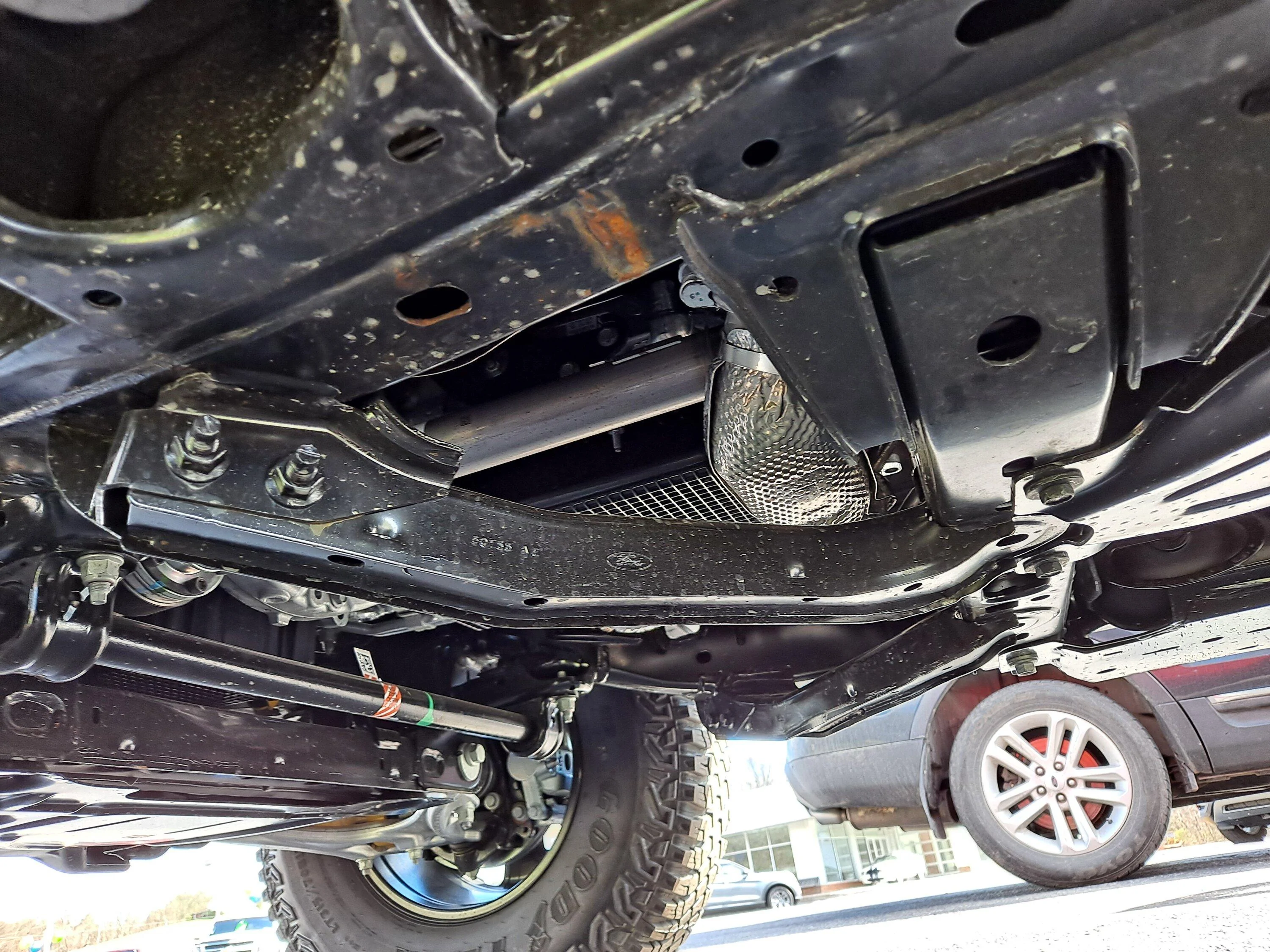

Have yet to understand why the didn't build a function into the screen where you could select the doors off individually or all together. It's all software at that point and doesn't need to rely on exposed terminal shorting bars. Have an icon in the cluster that shows doors off or message that self clears upon start up.
Either way, good workaround.
It was probably the same rocket scientist that said hey, we should put these under our off-roader so they catch every rock within earshot.
:ROFLMAO::ROFLMAO::ROFLMAO::ROFLMAO::ROFLMAO::ROFLMAO::ROFLMAO::ROFLMAO::ROFLMAO::ROFLMAO::ROFLMAO::ROFLMAO::ROFLMAO::ROFLMAO:
If you think that's bad, don't look at what's packed in the radiator support cavities and behind the headlights. No matter how many times I washed, mud is still coming out from what I'd call 2 mild off-roading sessions.
