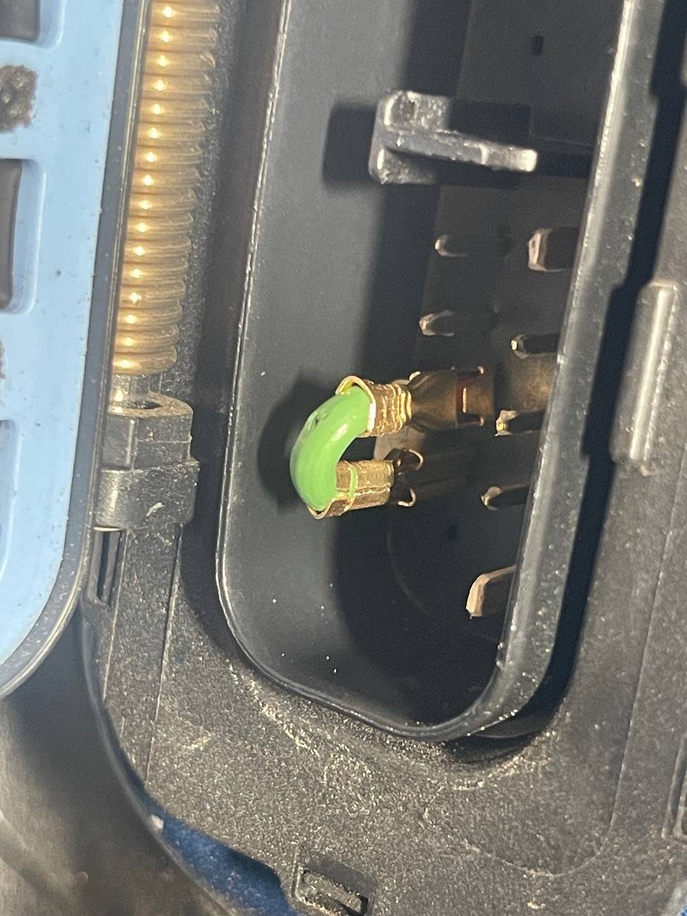

I know this is an old thread, but this seemed like a pretty simple solution. Door closes and seems to be much more reliable than the “jumper” from ford. Costs all of $15 for the wire and pins if you don’t have them already. Oh and ~10 mins of time
Ford Bronco Doors off gremlins explained, and an inexpensive DIY solution! IMG_8075
