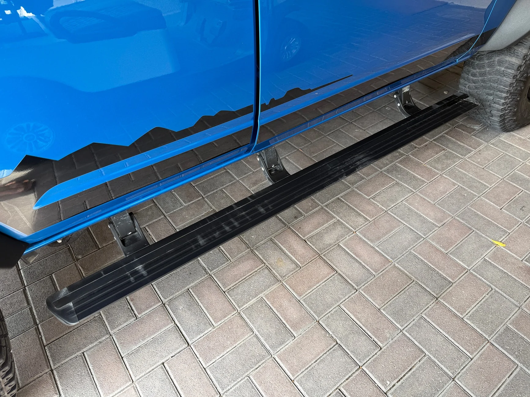

Hey everyone, Bronco newbie here!
I got a barely used 2023 Wildtrack Sasquatch a few months ago, and it was sold to me with OEM electric running boards. Now that's great, except for the fact that I cannot seem to find the setting to disable them.
I would love to know if that is doable (i've seen a few videos online where it seems to be an option in the "features" menu", but I'm not 100% sure) and why I cannot see the option anywhere on the screens.
If it's not possible, any suggestions to add a switch to deactivate them so I don't crush them on rocks in the near future?

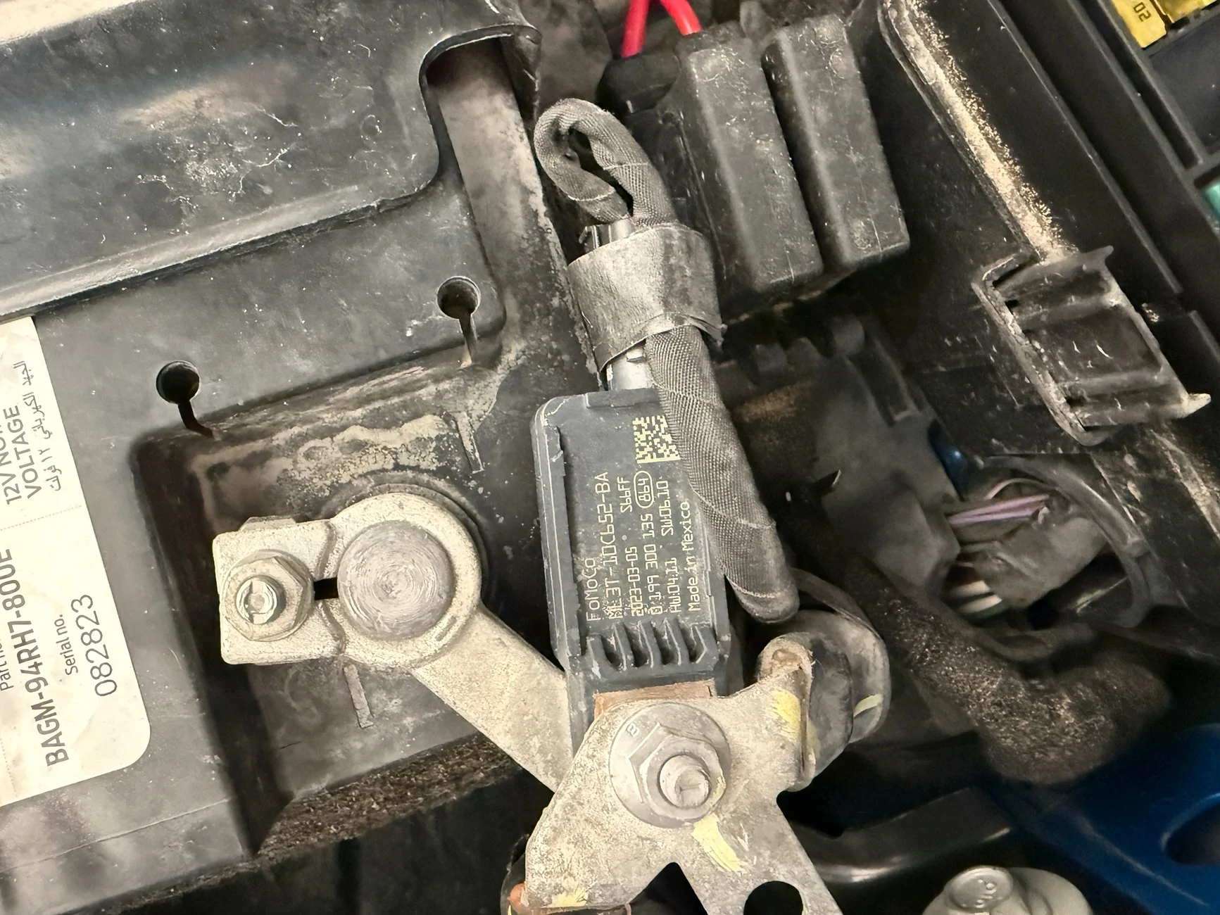

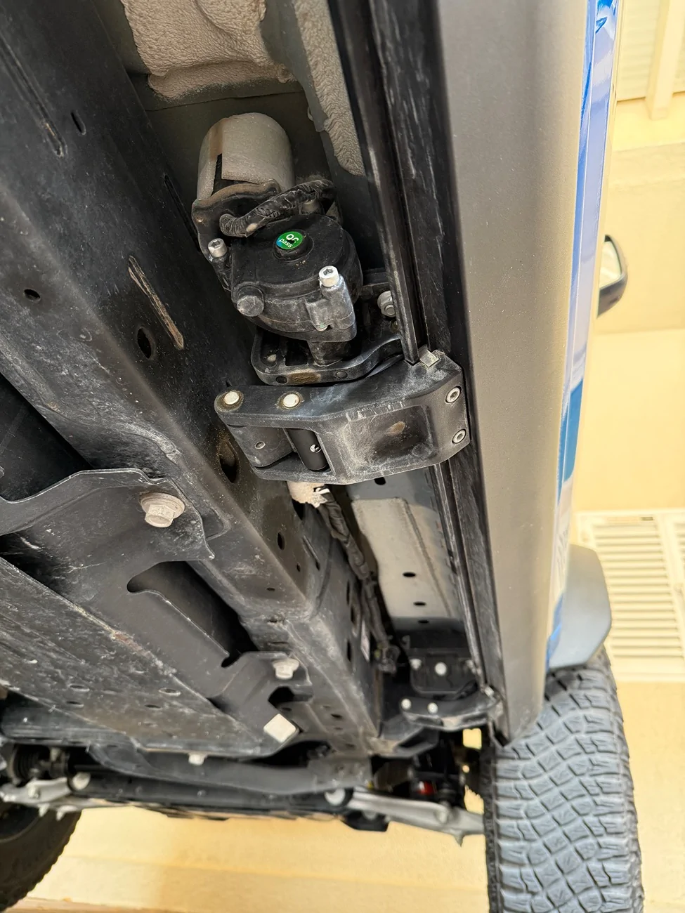

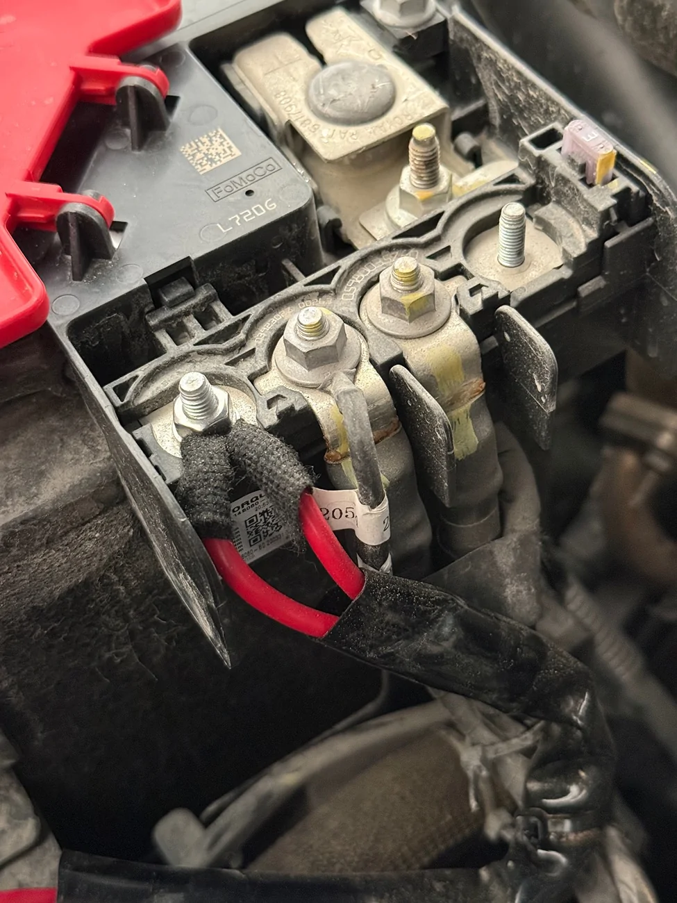

i had a look at the aux switches but apart from number 6 (which I hooked to the ARB compressor in the spare wheel hub) they are all disconnected.

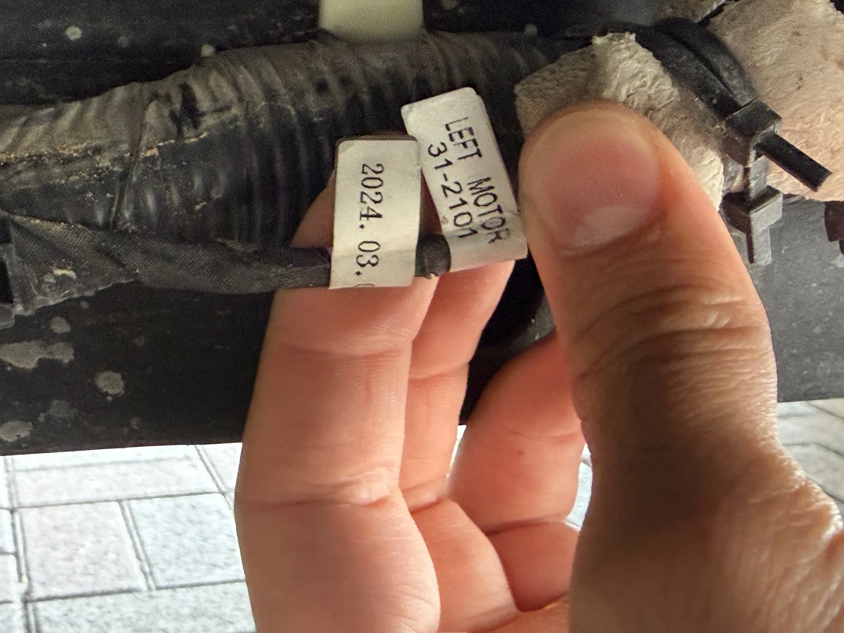

i couldn’t really find any name or number under the car (or maybe I haven’t looked hard enough) but here are some pictures of the boards and the cables. I’m 100% sore of the one connected to the positive of the battery, but not sure about the others.
let me know what you think

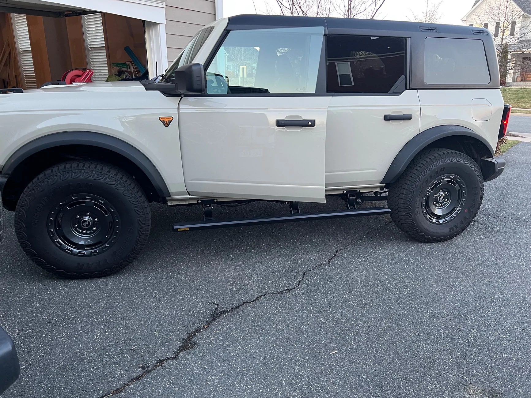

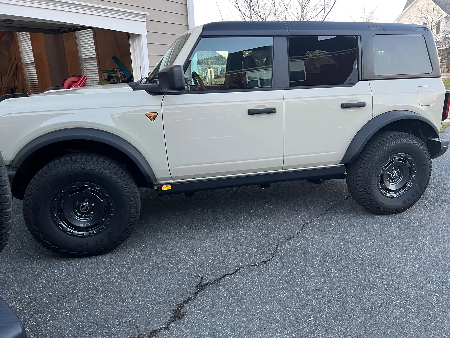

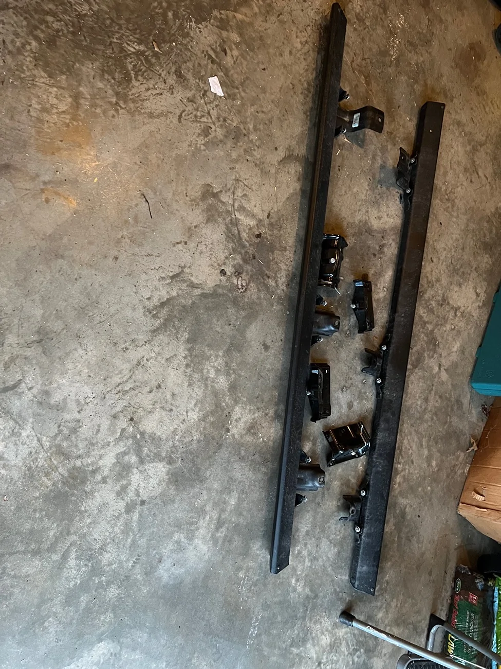

These look like the power steps I bought from SoFlo Customs with the three brackets. I had to add a shutoff switch using a 5-pin relay wired to #6 aux switch in the overhead. My step wiring harness has a 30A fuse that I was able to use a fuse tail to add the relay without hacking up the harness.
This lets you deactivate the steps to address your concern or lock them down to clean (or do your best secret service impersonation).
Here are a few pics

Little update:
I found out that the running board that have been installed are from AOR. They look exactly the same. I haven't been able to find the installation manual (or anything similar) to help locate the controller.
In any case, if I can't solve it through a manual of some sort I was thinking of maybe adding a switch to manually switch it on/off. And yes, it should stop when it encounters any obstacle or resistance but I'd rather stop it before that happens :cwl:
If anyone has ever used this kind of power step please let me know
