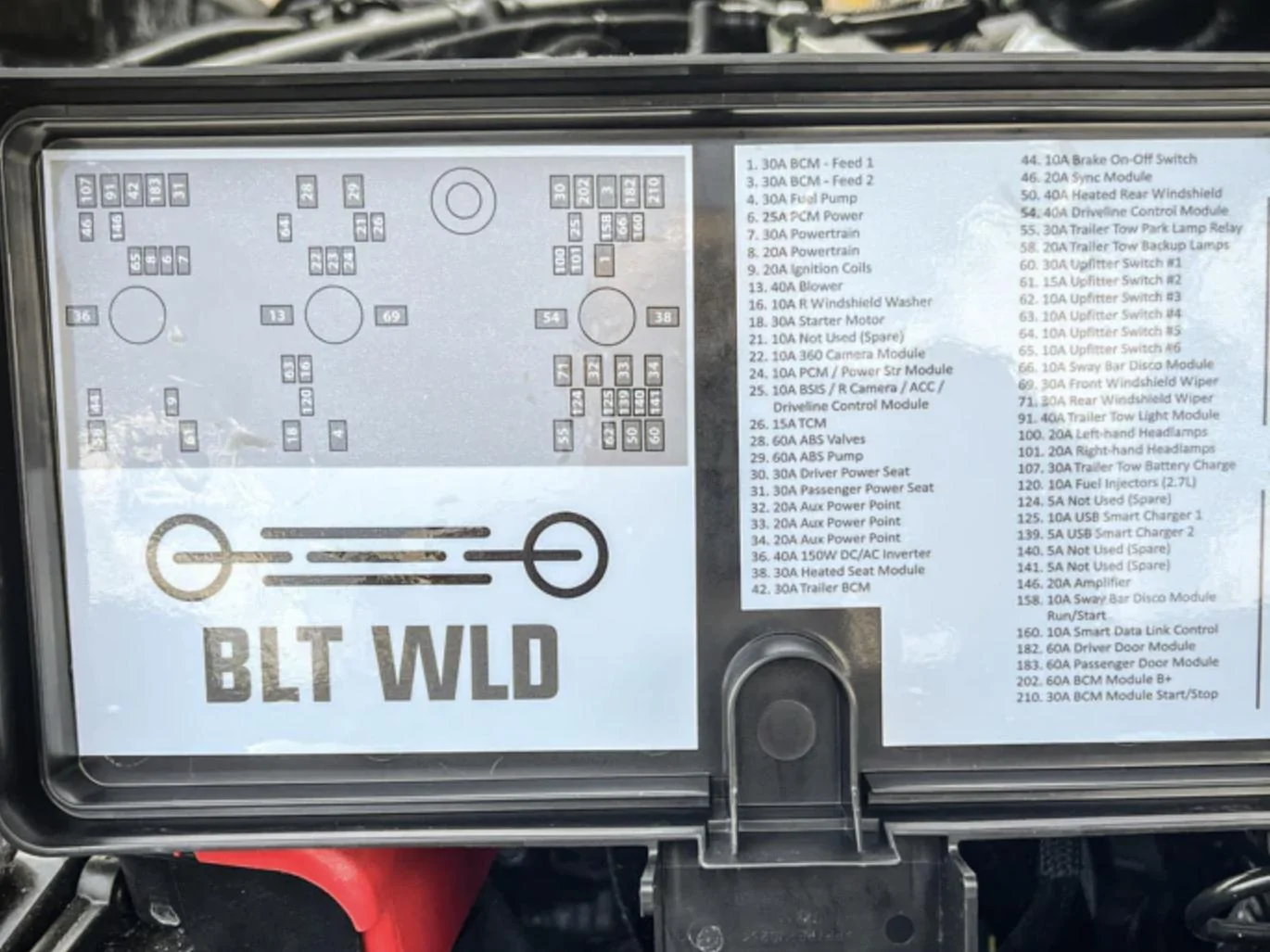

Fuse #35 under the dash is unused and it is switched power (only on when the vehicle power is on). Use a fuse tap and you are all set.

Thanks. Do you happen to know if there are any switched power fuses in the engine bay?
I tapped into #22 - the 360 camera for my backlights. Only hot when the key is on.
