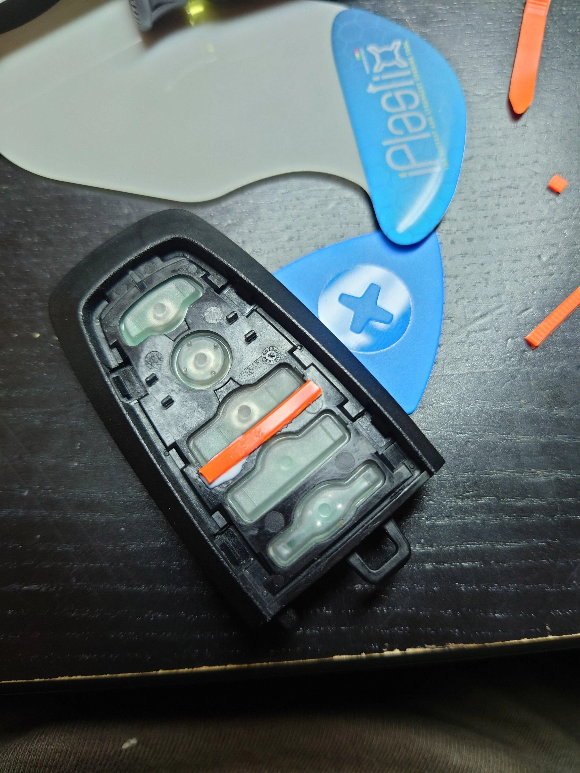

Took the key apart and filed the red part down so I'll never have another panic attack!!

How did you get it all to pop off?

Tiny screwdriver in the 2 small slots.
Use a coin or flat head screwdriver to pop the fob apart. You could use the physical key itself too I’m sure.

New owner appreciates this! Few minutes with a Dremel and life in my driveway and the parking lot is calm and quiet again!
