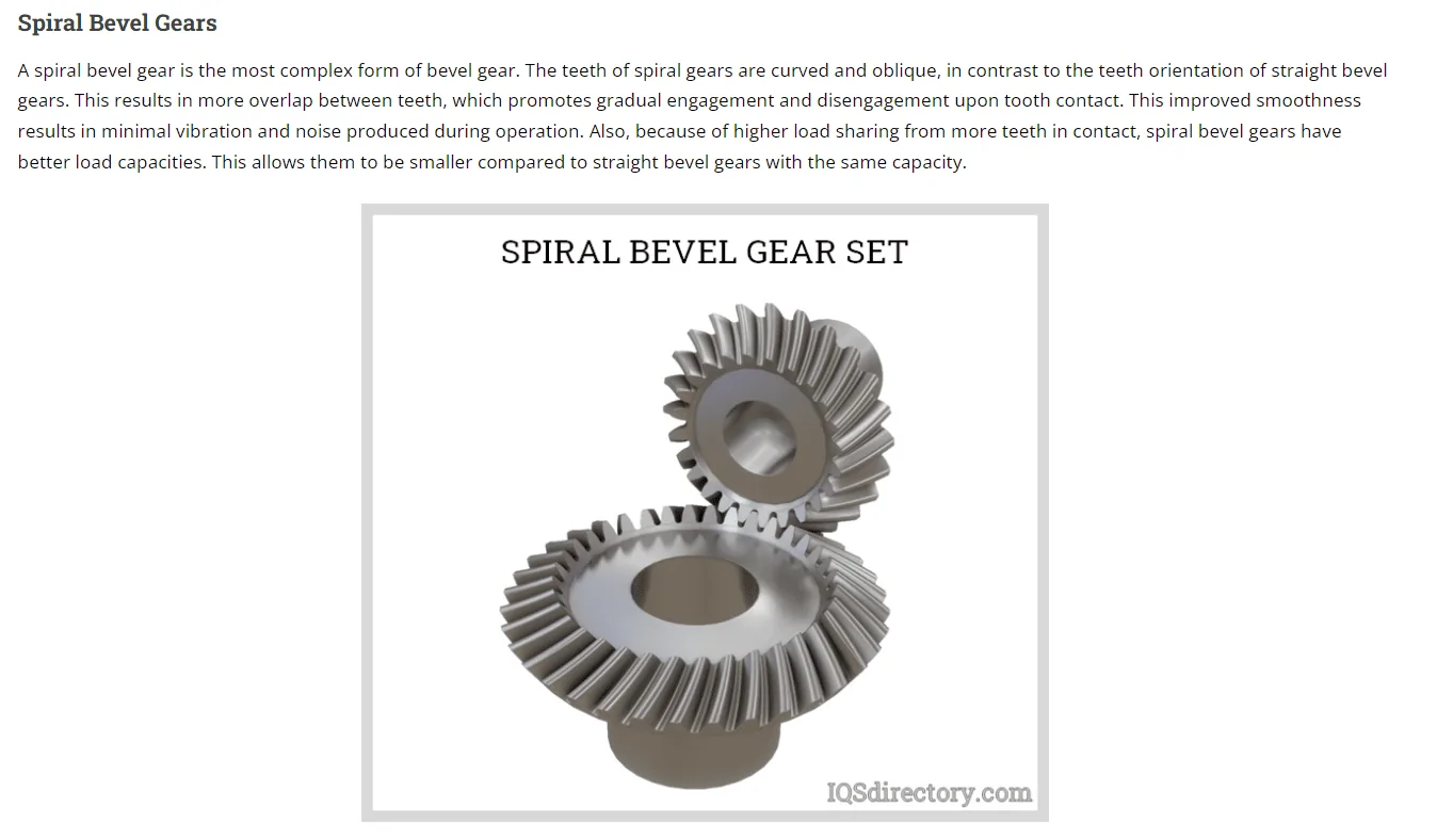

And my question wasn't designed to create a debate. I just wanted to learn if indeed there was some factual reason why the strength would be different one way or another. I wonder if the gears are cut in such a way that in One direction they pull into each other and in the opposite direction push away?

In regards to the reverse question, it's because of the design of the gears. They are designed to have more strength in forward than reverse.

Ford Bronco Could rocking back and forth when stuck break your front differential. Screenshot 2024-05-15 112011

Both times the front dif broke it was when going forward after reverse.
Most likely damage started happening in reverse then finished going forward. Bevel gears as mentioned above are strongest going forward. Pulling backwards there is way more taper on that side of the teeth and causes more deflection (the pinion gear trying to push the ring gear away from it). That deflection is usually what breaks a differential. The cases on these diffs are not very strong or resistant to deflection.
