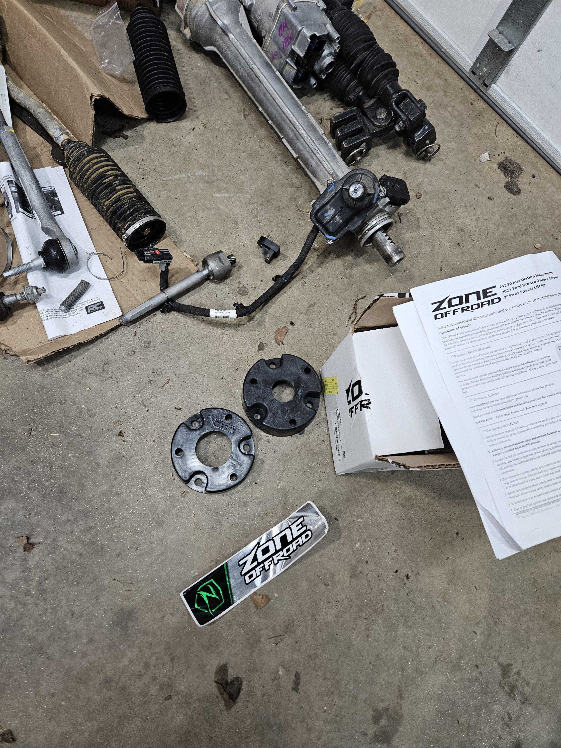

Has anyone had any real world experience with these pucks breaking. It seems like on the rear at full droop in a twisted up situation it would just break the thin amount of plastic between the bolt and the strut. I bought a cheap Zone off-road kit just to add the 1 in spacer in the rear to level out my overlanding ride due to the additional weight from all the gear.

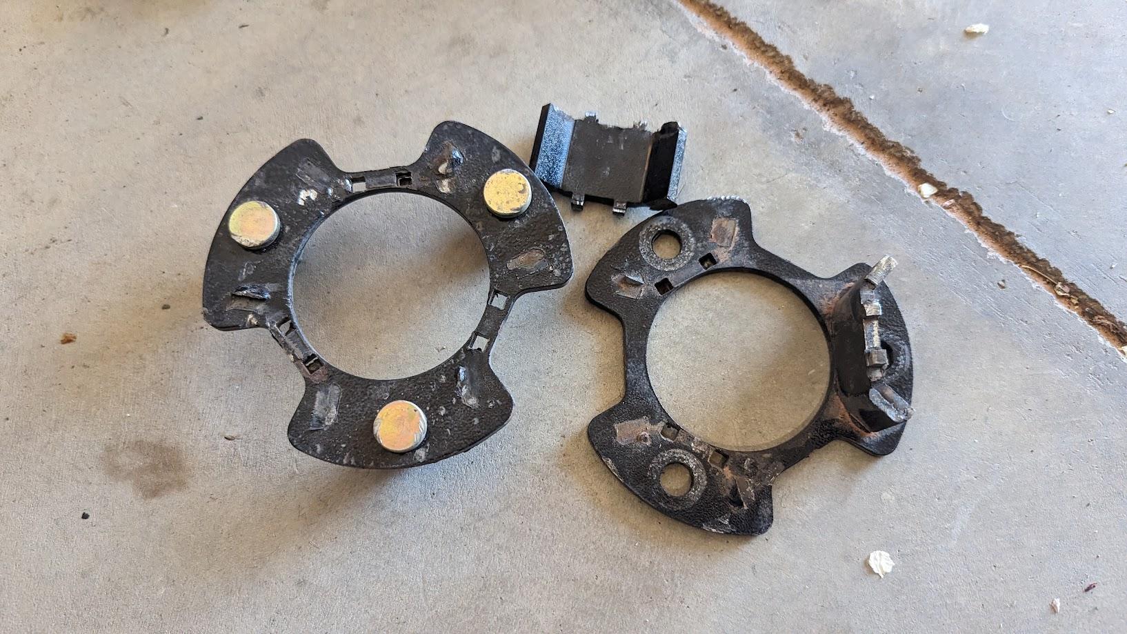

Sounds sketchy. I ripped apart a welded metal one in the rear.
You need to remember, they are only under compression.... There is no lateral loading on them. Are they solid? is there a honeycomb structure to them? I have not heard of them breaking but that does not mean one hasn't...... My guess is they should hold up fine.
You have a steering rack there as well.... but it does not look like it is out of a Bronco....

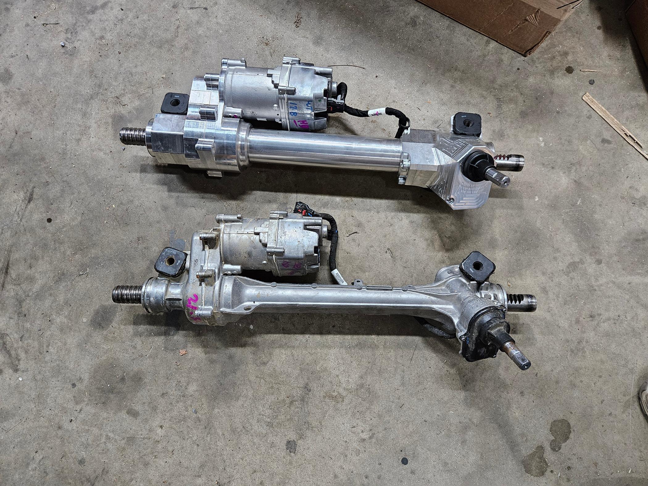

Under full droop and twisted up I doubt they'll be any lateral but they'll definitely be tension and pulling downOnce the shock is fully extended inside the strut the force is going to be on those bolt connections on the spacer not to mention the unsprung weight which in itself probably isn't that big of a deal since it's on my lift right now being supported. And yes that is a hoss 2.0 rack that had to go!

That's where I broke mine. Another guy there broke one too so I gave him my one good one and did the Carolina squat the rest of the trip.
I would go metal on these, solid preferably or do some extra welding if they are multi piece.

Yes and a 74 weld rack!!!! NICE..... Looks familiar!

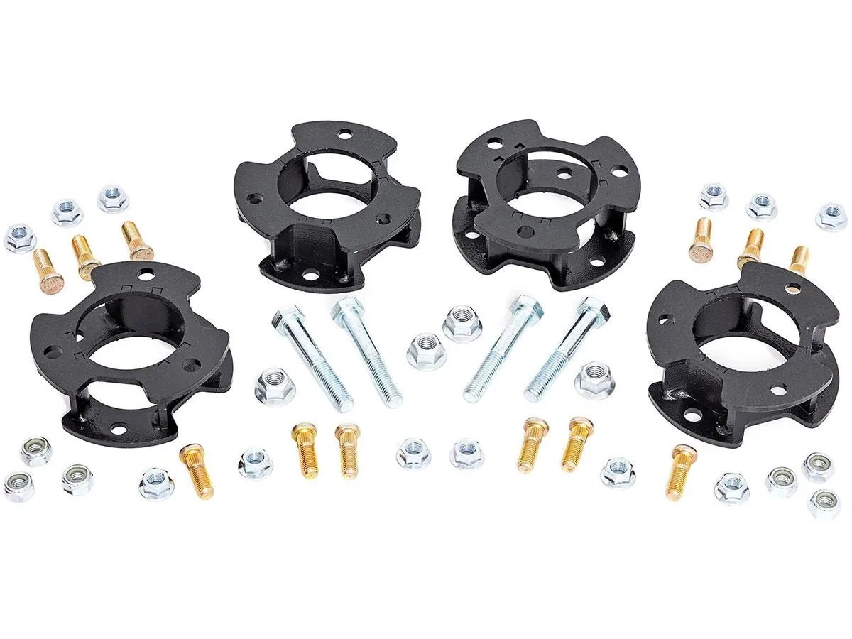

As near as I can tell, at some point during full droop it ripped the thing in half. The bolts don't go all the way through, if they did it would also solve the weakness I think. They used to look like this.
That makes sense why they would be under tension then..... I have used them on an entirely different vehicle where the bolts went all the way through... The bolts were in tension. Spacers were for compression only. Not sure why you would place those in tension.... probably some good reason.....
